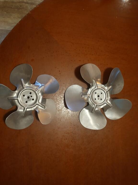

squonk 48,429 #1 Posted April 24, 2024 We were cleaning out some old obsolete refrigeration equipment at work and I saved these 2 fans. They are similar to the metal hydrogear cooling fans from the 60's. The fans on tractors usually are missing cracked bent ect. These fans measure 6 7/8" and 7 7/8" O.D. I thought of bringing these to the show and comparing them to a fan on a tractor but if anyone has one of these an can take a pic and measure across that would be helpful. I do not need a fan but I'm trying to come up with a reasonably priced alternative to the obsolete WH fan so members can replace theirs if needed. 7 Share this post Link to post Share on other sites

squonk 48,429 #8 Posted April 25, 2024 (edited) 10 minutes ago, rmaynard said: I would image that Sundstrand used an off-the-shelf fan on their pump, so it is probably still available generically. That's what I'm thinking. It looks like a common refrigeration fan. There are about a hundred different ones available. Just gotta nail down a part # Looks like the smaller fan I have is identical except the rotation is wrong. Progress Edited April 25, 2024 by squonk Share this post Link to post Share on other sites
squonk 48,429 #9 Posted April 25, 2024 Problem I'm running into is the trans pulley spins CCW Most refrigeration fans spin CW. The WH fan pulls air over the trans pump and put the screen. I don't see an issue running a CW fan and having the air come thru the screen and blowing over the trans pump. It's better than nothing once these fans aren't available anymore. https://www.rhsparts.com/Products/Fan-Blades CW fan Refrigeration Hardware Supply # 29-060 (pitch looks close) Currently $ 34 CCW Fan # 80-545 (less pitch than OE) $20 Share this post Link to post Share on other sites

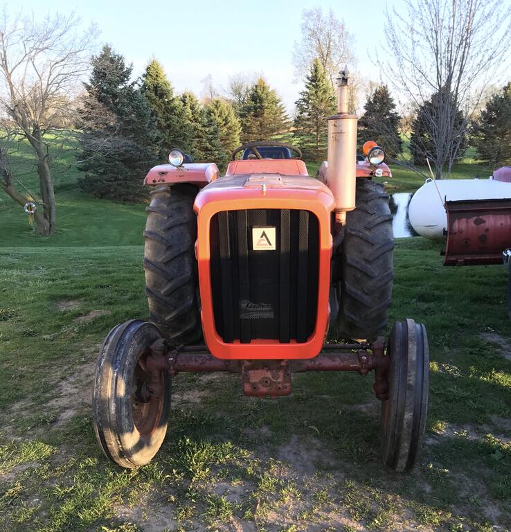

ACman 7,762 #10 Posted April 25, 2024 (edited) That would be great Bob @rmaynard. Will also need hole size and spacing of the holes of the screen. My brother had me source the screen and my other brother bent it up and cut it to match the original . This is for a Allis Chalmers 5040 (Fiat) . Oliver used the same tractor but used the Fiat grill . These are repopped and available from Stiener’s but will fit on the Chalmers . They were made of Fiberglass and broke easily and finding a good one is like finding a unicorn . This grill had to be fiberglassed back together and the screen had a big hole in it . I wish I had a before pic . ‘’that’s the battery behind the grill. Edited April 25, 2024 by ACman Share this post Link to post Share on other sites
