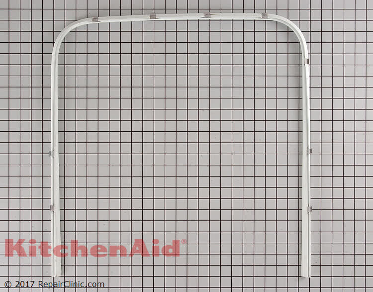

lynnmor 7,773 #3 Posted April 24, 2024 I have an old well built Kitchenaid dishwasher that was made by Hobart. Now I am to throw it away because the door gasket started leaking and there are no replacements on this planet. The new business model is to overprice or eliminate spare parts so you have to buy new throw away appliances. Share this post Link to post Share on other sites

peter lena 9,231 #5 Posted April 24, 2024 @lynnmor you mean you cant make a gasket ? got a picture of that gasket / area ? pete Share this post Link to post Share on other sites
lynnmor 7,773 #6 Posted April 25, 2024 1 hour ago, peter lena said: @lynnmor you mean you cant make a gasket ? got a picture of that gasket / area ? pete gasket wp4161631 Share this post Link to post Share on other sites

peter lena 9,231 #9 Posted April 25, 2024 @lynnmor https://www.google.com/search?q=gasket+wp4161631&rlz=1C1CHBF_enUS866US866&oq=&gs_lcrp=EgZjaHJvbWUqCQgAEEUYOxjCAzIJCAAQRRg7GMIDMgkIARBFGDsYwgMyCQgCEEUYOxjCAzIJCAMQRRg7GMIDMgkIBBBFGDsYwgMyCQgFEEUYOxjCAzIJCAYQRRg7GMIDMgkIBxBFGDsYwgPSAQ4xMDk1ODczMDc4ajBqN6gCCLACAQ&sourceid=chrome&ie=UTF-8 might find related gasket making material here . just an idea , Pete Share this post Link to post Share on other sites
tunahead72 2,539 #10 Posted April 25, 2024 13 hours ago, lynnmor said: gasket wp4161631 It's a long shot, but you might try trimlok.com, they might have something that would work for you. They sell in long lengths on their website, but you can get shorter lengths from zoro and grainger, also on ebay and amazon. Similar at McMaster. I don't know what you would do about the metal clips. -------- Must be busted dryer week, a friend and I have both been working on our dryers, both of us with broken belts. Body hurt. Share this post Link to post Share on other sites
Handy Don 13,908 #11 Posted April 26, 2024 On 4/24/2024 at 5:52 PM, lynnmor said: I have an old well built Kitchenaid dishwasher that was made by Hobart. Now I am to throw it away because the door gasket started leaking and there are no replacements on this planet. The new business model is to overprice or eliminate spare parts so you have to buy new throw away appliances. I was shocked a while back that I could get replacements for the main pump and the “vent flap solenoid” (closes during sloshing to block noise) for our 25 yo Kenmore dishwasher. Even more shocked that they were $50 and $12, respectively. The only suggestion I can offer is to see if you can adapt the gasket from a different model. On some, the places for the clips are molded in but on others, the gasket is continuous. Share this post Link to post Share on other sites
lynnmor 7,773 #12 Posted April 26, 2024 13 minutes ago, Handy Don said: The only suggestion I can offer is to see if you can adapt the gasket from a different model. On some, the places for the clips are molded in but on others, the gasket is continuous. Yep, that's my problem. We have a large well stocked appliance parts company in Lancaster, PA, the best they could come up with was to glue another brand in place and hope for the best. The one he came out with was about twice as thick and I didn't think the door had a chance closing. 1 Share this post Link to post Share on other sites
Handy Don 13,908 #13 Posted April 26, 2024 28 minutes ago, lynnmor said: The one he came out with was about twice as thick and I didn't think the door had a chance closing. Understood. The tolerances on these gaskets are pretty tight and solid vinyl isn’t very forgiving Share this post Link to post Share on other sites
lynnmor 7,773 #14 Posted April 26, 2024 3 hours ago, Handy Don said: Understood. The tolerances on these gaskets are pretty tight and solid vinyl isn’t very forgiving Currently I have a strip of rope caulk in the gasket where it leaks and it is down to an occasional drip. My next trick may be to insert small surgical tubing all the way around to see if that is the answer. 1 Share this post Link to post Share on other sites
Handy Don 13,908 #15 Posted April 26, 2024 5 hours ago, lynnmor said: Currently I have a strip of rope caulk in the gasket where it leaks and it is down to an occasional drip. My next trick may be to insert small surgical tubing all the way around to see if that is the answer. Necessity is the.... Good luck! 1 Share this post Link to post Share on other sites
peter lena 9,231 #16 Posted April 27, 2024 @lynnmor rarely , have a exact replacement for an issue , regularly adapt to it , there is a lighter , vinyl truck door edging , that I have used for , W/H hood edging , that worked out very well . hope you find it , Pete 2 lynnmor Share this post Link to post Share on other sites
