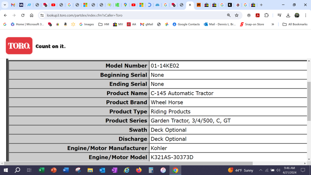

C-85 653 #1 Posted April 21 I have a '81 C145A and I'm attempting to do some work on its Kohler engine. The numbers on the tractor are 01-14KE02. The numbers on the engine are gone, so I've tried to find Kohler info on the web. I found this (below) on the Toro site and it shows this as having a K321AS, spec number 30373d. This seemed simple, but I haven't found much with the K321'AS' part, and nothing for the 30373d spec number either. I have no idea of what the AS part is or if that is needed to identify it. I've taking some of the engine apart, it appears to have a standard piston that is worn. I'm hoping to find a .003 oversize piston and rings, and could use some help! C-85 Share this post Link to post Share on other sites
Blasterdad 2,564 #2 Posted April 21 36 minutes ago, C-85 said: I have no idea of what the AS part is or if that is needed to identify it AS signifies electric start. Share this post Link to post Share on other sites
gwest_ca-(File Mod) 10,513 #3 Posted April 21 Believe the A is for shallow oil pan. Looks like the spec number is a typo. Should be 60373 https://www.partstree.com/models/k321-60373-kohler-k-series-engine-made-for-wheel-horse-14hp-10-4kw/ Share this post Link to post Share on other sites

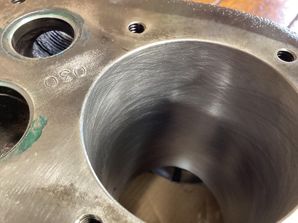

ri702bill 7,363 #8 Posted April 21 42 minutes ago, richmondred01 said: It will come back and bite you in the bum. Some folks actually enjoy that when it happens!! Excellent cross-hatch on that bore in your picture to seat the rings..... Share this post Link to post Share on other sites
