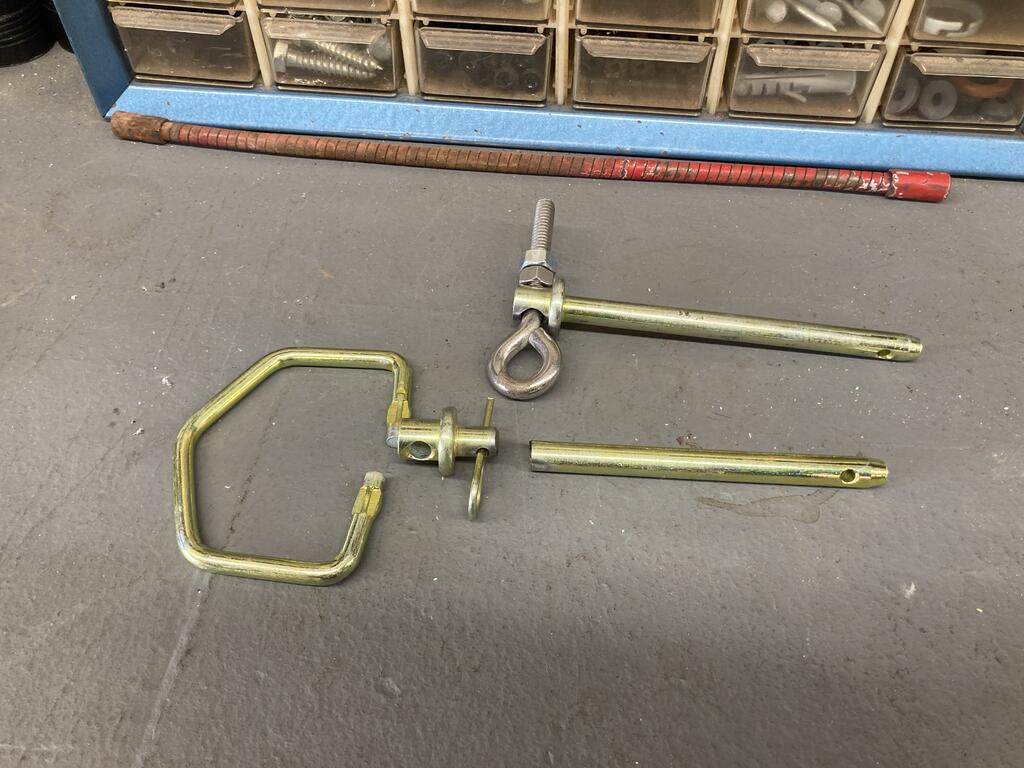

Blasterdad 3,168 #1 Posted April 19, 2024 Tractor supply hitch pins, pull out the handle, cut to length, drill hole for supplied hairpin, done. 6 3 Share this post Link to post Share on other sites
ebinmaine 81,282 #2 Posted April 19, 2024 What's attached to this here piece O eeequipment ? Share this post Link to post Share on other sites
Blasterdad 3,168 #3 Posted April 19, 2024 17 minutes ago, ebinmaine said: What's attached to this here piece O eeequipment ? I needed one for the lift cable on the rear Rock Shaft for the slot hitch in preparation for @Pullstart's plow day, I didn't have time to order one & saved money too. The one with the eyebolt will be an extra for a mower lift arm or whatever... 3 Share this post Link to post Share on other sites
ebinmaine 81,282 #4 Posted April 19, 2024 13 minutes ago, Blasterdad said: I needed one for the lift cable on the rear Rock Shaft for the slot hitch in preparation for @Pullstart's plow day, I didn't have time to order one & saved money too. The one with the eyebolt will be an extra for a mower lift arm or whatever... Niiiiice 1 Share this post Link to post Share on other sites
