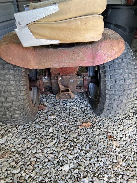

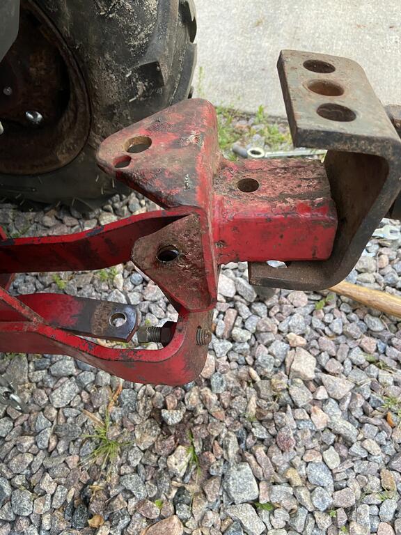

Fishroe 261 #1 Posted April 16, 2024 Thought I was going to plow the garden for my first time using a brinly plow on the 414-8 put the rockshaft kit on, took the sleeve hitch off the 314 hydro I wanted to plow with a manual trans for the first time plowing. The hole in the stabilizer plate doesn’t even line up with the hole on the plow. What the h$ll. This is the only sleeve hitch I’ve ever seen it came on the 314 hydro when I bought it a couple years ago I don’t get it. Any help is appreciated. Very frustrated right now 😠😠 1 1 Share this post Link to post Share on other sites

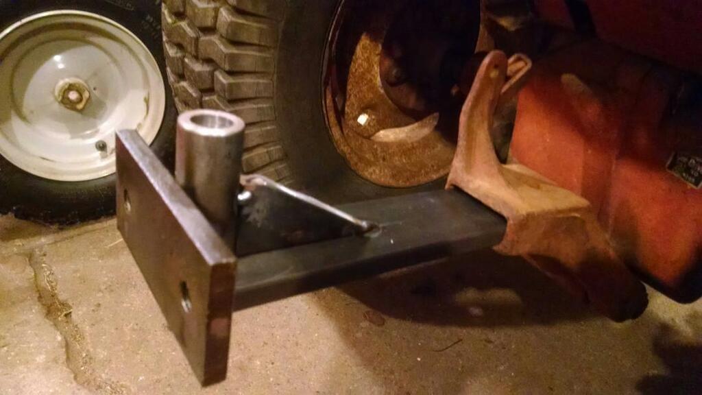

Achto 32,260 #2 Posted April 16, 2024 35 minutes ago, Fishroe said: I don’t get it. Any help is appreciated. Not sure what that piece in the middle is. This should be all the pieces that there is to the hitch. https://wheelhorsepartsandmore.com/product/toro-wheel-horse-brinly-clevis-hitch-sleeve-hitch/ The hitch on the plow should be pinned through the sleeve in the hitch. 4 2 Share this post Link to post Share on other sites

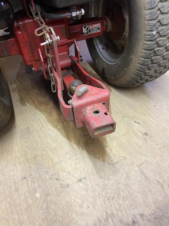

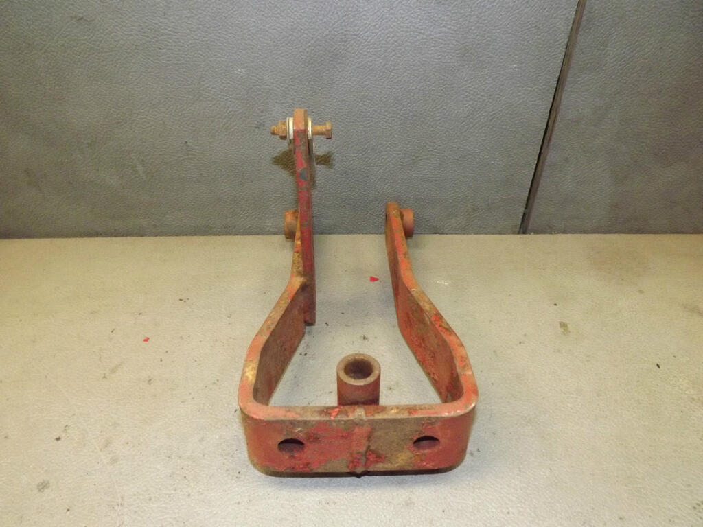

daveoman1966 3,884 #3 Posted April 16, 2024 Your CLEVIS hitch appears to hvae been modified...it should look like this for the moldboard plow: 2 Share this post Link to post Share on other sites
ranger 1,860 #4 Posted April 16, 2024 (edited) Is the piece with the box section an adapter to allow the older type implements, which use a ‘tongue’ for connection, to fit to the later clevis hitch? Edited April 16, 2024 by ranger 1 Share this post Link to post Share on other sites
OutdoorEnvy 1,817 #5 Posted April 16, 2024 I think you are right. Older models used a slot hitch and it seems that is the modification to yours to use slot hitch implements. You could change it back by using a grinder to cut off where they welded so it looks like the regular sleeve hitch. Share this post Link to post Share on other sites
Pullstart 71,008 #6 Posted April 16, 2024 39 minutes ago, ranger said: Is the piece with the box section an adapter to allow the older type implements, which use a ‘tongue’ for connection, to fit to the later clevis hitch? 29 minutes ago, OutdoorEnvy said: I think you are right. Older models used a slot hitch and it seems that is the modification to yours to use slot hitch implements. You could change it back by using a grinder to cut off where they welded so it looks like the regular sleeve hitch. The tube on the “adapter” looks too tall for a sleeve hitch attachment to work. It would flop up and down and likely damage the pin. My guess, is it was a custom extension to lift the plow out of the ground further with a rock shaft. @Blasterdad’s C-81 this weekend came to plow day with a rock shaft and he figured out real quick that the lift height is severely hindered by the extra leverage the rock shaft allows for. Making the lever (plow frame) longer would lift it further off the ground. Share this post Link to post Share on other sites
Fishroe 261 #7 Posted April 16, 2024 Here’s a better pic before I took it off the 314 so should I take the piece with the 2 holes in it off and use the plow without it 3 Share this post Link to post Share on other sites
Achto 32,260 #8 Posted April 16, 2024 17 minutes ago, Fishroe said: should I take the piece with the 2 holes in it off and use the plow without it Correct. The plow will attach where the pin is now. 2 Share this post Link to post Share on other sites

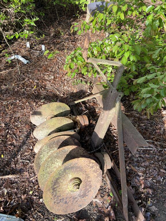

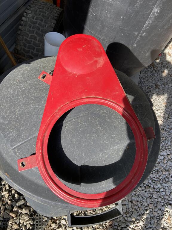

Fishroe 261 #10 Posted April 16, 2024 (edited) When I got the 314 2 implements came with it a disc harrow and a rake and they both have a thick piece of flat bar that would slide in that adapter thing. The guy also gave me a non running 856 and that has the slot hitch so that explains all of that. The 856 I have is missing both belt covers. A year or so after I got the 856 I bought a another mower not a wheel horse from another guy and he had this belt cover laying around and I thought it might fit the 856 but it doesn’t if anybody can use it, I’d be more than happy to send it to them Edited April 16, 2024 by Fishroe Share this post Link to post Share on other sites
Lee1977 7,744 #11 Posted April 16, 2024 You don't need that piece anyway it was just there to take up space. I have never used mine, hook up with out it .. Share this post Link to post Share on other sites
wallfish 20,386 #12 Posted April 16, 2024 5 hours ago, Fishroe said: When I got the 314 2 implements came with it a disc harrow and a rake and they both have a thick piece of flat bar that would slide in that adapter thing. The guy also gave me a non running 856 and that has the slot hitch so that explains all of that. The 856 I have is missing both belt covers. A year or so after I got the 856 I bought a another mower not a wheel horse from another guy and he had this belt cover laying around and I thought it might fit the 856 but it doesn’t if anybody can use it, I’d be more than happy to send it to them Save that adapter thing for using with the flat bar attachments! I could use that engine belt guard if no one else claimed it 2 Share this post Link to post Share on other sites

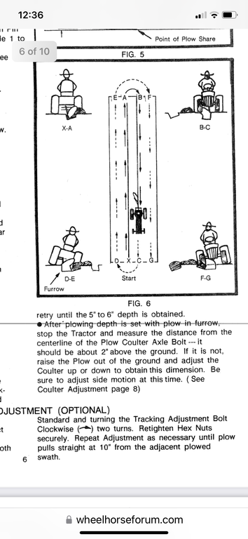

Fishroe 261 #13 Posted April 16, 2024 (edited) OK guys I got the garden plowed today. Thanks to everyone’s help. It plowed good, but I do have one question. Following the Brinley plow instructions that a moderator had posted in another forum. It says to keep the right side tires in the furrow, which I did. But it was leaving a 10 or 12 inch wide strip that wasn’t getting plowed. Am I doing something wrong? wallfish send me your name and address and I will send it to you. I don’t want anything for it. Edited April 16, 2024 by Fishroe 1 Share this post Link to post Share on other sites
SylvanLakeWH 32,008 #14 Posted April 16, 2024 @Achto @WHX?? @Pullstart Thoughts...? 1 Share this post Link to post Share on other sites
Achto 32,260 #15 Posted April 16, 2024 (edited) 1 hour ago, Fishroe said: Am I doing something wrong? When you have your right tires in the furrow, the inside of them should be tight against the left edge of the furrow. The right hand edge of your plow should stay in line with the inside of the right rear tire. If the plow wants to drift to the left (away from the furrow) then you have a set up issue. The cure for this is explained in Brinly's complete instructions. A "band aid" for this is to use the two bolts on the sleeve hitch to keep the plow from swinging to the left. Tighten the bolts against the plow to stop side to side movement. One other thing that can cause your plow to drift out of the furrow is a bent back bone. It takes some practice to get them tuned in properly. https://brinly.com/wp-content/uploads/2020/01/efymirhk2pechs8bfhjk.pdf Any way that you can post pics of the plow hooked to the tractor. Show the hitch and step back a ways so we can see how it lines up with the rear tires. Edited April 16, 2024 by Achto 2 1 Share this post Link to post Share on other sites

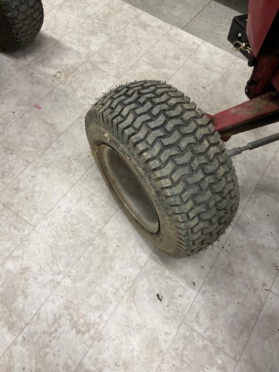

Fishroe 261 #22 Posted April 17, 2024 Would it work better if I had narrower front tires I have these I could take off the 856 vs. the stock ones on the 414 1 Share this post Link to post Share on other sites
Achto 32,260 #23 Posted April 17, 2024 9 minutes ago, Fishroe said: Would it work better if I had narrower front tires Tires should be fine as long as they do not sit in further that the rears. Look down the rear of the tractor, the inside edges of the tires should line up with in reason. 1 Share this post Link to post Share on other sites
