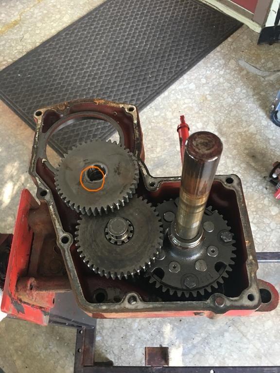

19richie66 17,932 #27 Posted July 24, 2024 Possibly this keyway or it could have sheared off some teeth on that gear and it’s not making contact with the drive gear off the pump. 1 Share this post Link to post Share on other sites
Handy Don 17,316 #28 Posted July 24, 2024 4 hours ago, 19richie66 said: Possibly this keyway Still confused that turning the left hub turns the brake drum--seems to imply that diff and intermediate gears are all working. Maybe a sheared key with enough residual friction to turn the drum but not enough to drive the machine? 1 Share this post Link to post Share on other sites

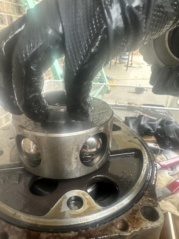

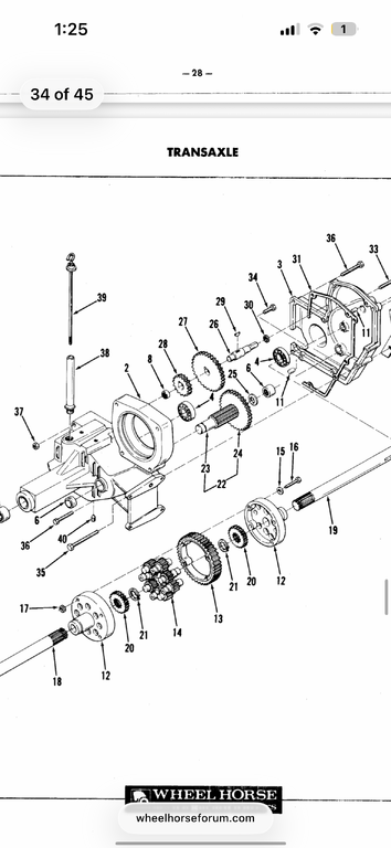

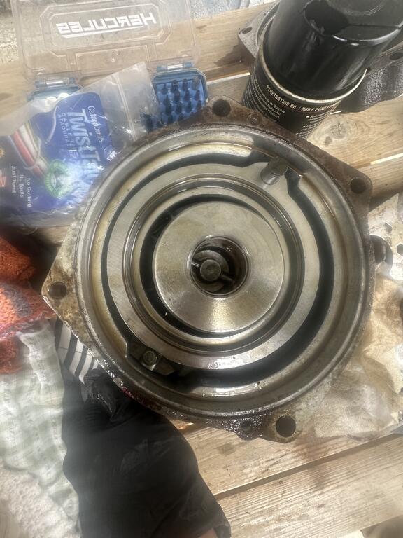

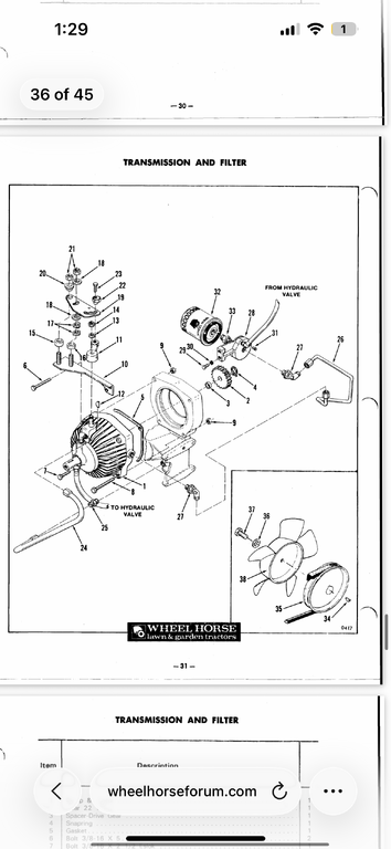

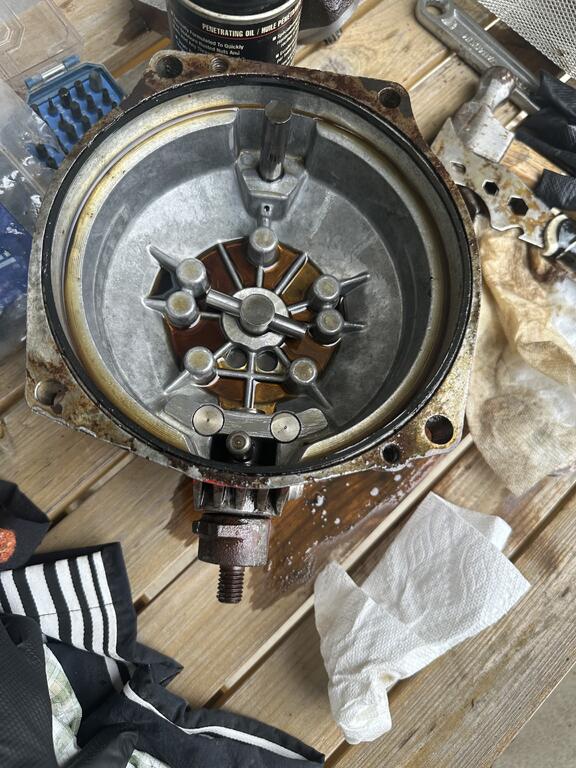

Farmerred 2 #30 Posted 4 hours ago Hello again, coming back to this project after a while. I want to update some info about this problem. I removed the pump housing so I can see the two gears (27 and 28). When I spin the left hub it spins 28 and 27, but not the right hub. Vice versa. And spinning the gear 28 spins both hubs - forward or back. Gear 27 just rotates freely it seems but also rotates when gear 28 rotates. Neither gear looks to have any damaged teeth. The hubs can spin in opposite directions but neither 27/28 rotate when the wheels are spinning in opposite directions. Spinning the hubs in the same direction rotates 27/28, also. On the pump housing, gear 2 (output shaft gear) rotates freely and so does the input shaft. Are there other tests I do to isolate either the transaxle or the pump? Share this post Link to post Share on other sites
