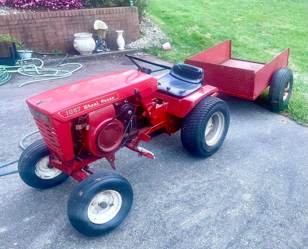

1057Revival 2 #1 Posted April 13, 2024 What's up everyone! I have a 1967 1057 with the K241. I was mowing the yard this morning and the engine blew. I believe the crank bearing sheared and messed everything up, there's still oil on the cylinder walls and it's not locked there. Oil didn't run dry. I'm pretty devastated , I put a lot of work into her over the last few weeks to get her running again and she was running really good. Does anyone have any leads on a 1960s K241 that I could easily swap? Or any ideas on engines that easily swap into a 1057? I'm located in Roanoke, VA. I have a lot of attachments that use the hard to find Slot Hitch and I'd prefer to not have to get new attachments (if I got a newer model) Also the 1057 has the 5058 Unidrive 3 speed, which is a really durable transmission for plowing and discing. Thanks! 1 1 Share this post Link to post Share on other sites

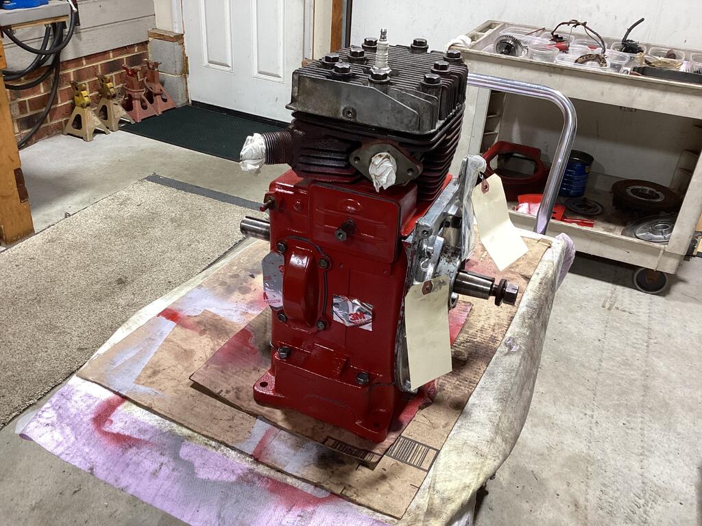

richmondred01 2,388 #4 Posted April 13, 2024 Yep I’ve got one ready to go. Fully rebuilt. 3 6 1 Share this post Link to post Share on other sites
