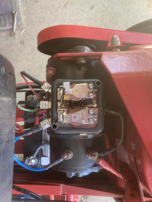

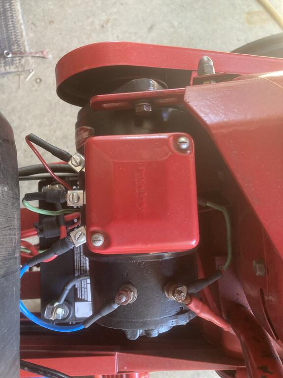

"Manic-Mechanic" 1,485 #1 Posted April 13, 2024 New battery Sept 2023, seemed fine last Season. Went to start the other day after sitting months, dead, 0v! (Quick charge for grins & giggles) 13v Started, charged off generator awhile, seemed fine. Then it failed on start, dropped to 10v! Removed it, tested again, 12.26 v? Odd, bad cell? Dropped off to the Vender for long charge and test this morning I tried to explain but salesman/tech said it reads 12v it’s dead, something killed it. My electrical system has no drain, really anxious to see the results. Machine should discover a bad cell The isn’t a whole lot going on in this circuit with ignition off Share this post Link to post Share on other sites
squonk 47,733 #2 Posted April 13, 2024 Check the wire underneath the regulator that goes to the "a terminal " of the generator. I have seen a lot of those burn't causing all kinds of issues. I have also seen issues with the generator itself. It will start and charge fine but draw juice out of the battery when turned off. Share this post Link to post Share on other sites

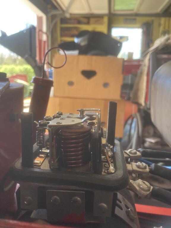

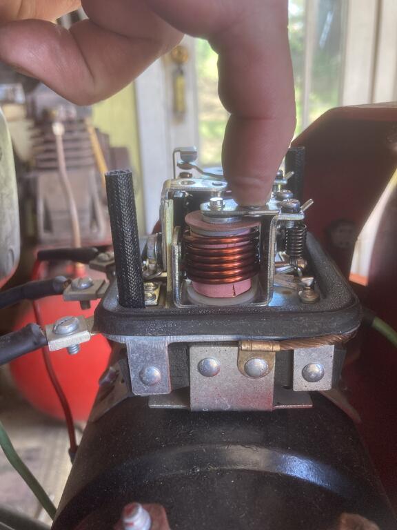

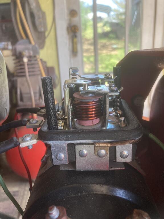

ri702bill 12,696 #4 Posted April 13, 2024 There are 2 mechanical relays inside the voltage regulator. One gets energized and goes from NO to NC to allow curent to pass when the key is on. Key off- it must reopen. Only had one where the contacts were "welded" together, allowing the battery to discharge. 2 Share this post Link to post Share on other sites

"Manic-Mechanic" 1,485 #6 Posted April 13, 2024 2 hours ago, ri702bill said: There are 2 mechanical relays inside the voltage regulator. One gets energized and goes from NO to NC to allow curent to pass when the key is on. Key off- it must reopen. Only had one where the contacts were "welded" together, allowing the battery to discharge. I checked, functioning 1 Share this post Link to post Share on other sites
"Manic-Mechanic" 1,485 #7 Posted April 13, 2024 4 hours ago, squonk said: Check the wire underneath the regulator that goes to the "a terminal " of the generator. I have seen a lot of those burn't causing all kinds of issues. I have also seen issues with the generator itself. It will start and charge fine but draw juice out of the battery when turned off. I checked, it’s good Share this post Link to post Share on other sites
"Manic-Mechanic" 1,485 #8 Posted April 13, 2024 3 hours ago, Ed Kennell said: If there is a drain, you will see a spark when you disconnect the battery. I checked there as well, no spark Share this post Link to post Share on other sites

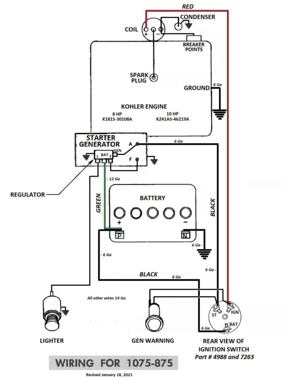

"Manic-Mechanic" 1,485 #9 Posted April 13, 2024 (edited) I do know that there is continuity from A to ground on the generator, is that normal? I mean the Green goes there from the back of the regulator so it would have to be Edited April 13, 2024 by "Manic-Mechanic" Addition Share this post Link to post Share on other sites
