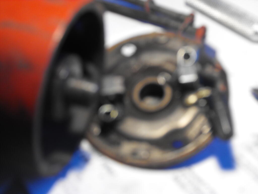

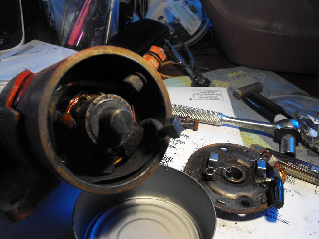

Don in Mystic 7 #1 Posted April 10, 2024 I have a 1974 C-100 . The Starter is an "American Bosch" model SMA 12A11 which needs a set (2) of new brushes. Ive searched Amazon, Ebay and the web without success. Hoping someone can suggest a source. Many Thanks Share this post Link to post Share on other sites
953 nut 70,661 #2 Posted April 10, 2024 Give Jack's small engine a call. https://www.jackssmallengines.com/Products/KOHLER/Starter-Part/Starter-Brush-Kits?gad_source=1&gclid=CjwKCAjw8diwBhAbEiwA7i_sJWQvSbJAAUHzPaz5lDJ7CzjFWdSjkWOJ0auBYnBeDWg2UM6KUwdVhBoCOOMQAvD_BwE Share this post Link to post Share on other sites
Don in Mystic 7 #3 Posted April 10, 2024 Thanks but the kit pictured in the link isn't the correct one (ask me how I know). I have a two brush starter and the braided wire attached at the end, not side of the brush Share this post Link to post Share on other sites
953 nut 70,661 #4 Posted April 10, 2024 I don't know what starter you have, just used that listing as a reference. Give them a call, they probably have what you need. Share this post Link to post Share on other sites
ri702bill 13,396 #5 Posted April 10, 2024 Don - do you have a Starter / Generator / Alternator Rebuilding facility near you?? They may have exactly what you need.... Share this post Link to post Share on other sites
Don in Mystic 7 #6 Posted April 10, 2024 Unfortunately, no longer but I am going to expand my search area and hopefully find one..... Share this post Link to post Share on other sites
oliver2-44 11,847 #7 Posted April 10, 2024 (edited) You could also try DB Electric. I have bought brush, bushing kits from them. If your starter has enough use that the brushes are worn out, I would suggest you check the front bushing for wear. They are prone to wear as they take all the side loading Edited April 10, 2024 by oliver2-44 2 Share this post Link to post Share on other sites
ebinmaine 81,282 #8 Posted April 10, 2024 3 hours ago, oliver2-44 said: DB Electric That was one thought I had. Also maybe isavetractors...? Share this post Link to post Share on other sites
ebinmaine 81,282 #9 Posted April 10, 2024 @WHX?? or @Achto You guys got any vendors up by you? Share this post Link to post Share on other sites
Achto 32,964 #10 Posted April 10, 2024 14 minutes ago, ebinmaine said: You guys got any vendors up by you? My "Go To" guy left the area. 2 Share this post Link to post Share on other sites
WHX?? 58,388 #11 Posted April 10, 2024 Not anymore ... our guy moved to Timbukto..Sounds like he already covered our usual haunts. Maybe Pat's small engine plus? Lately he's been boning me too tho. I would think they should be easy to find. Try Googling Bosch brushes sma 12a11 being keywords. 1 Share this post Link to post Share on other sites
Don in Mystic 7 #12 Posted April 15, 2024 I got Lucky I saw a set on ebay that looked like them and turns out I was right. FYI part #s for reference are Brush Kit: Kohler 236576 Bosch 551005 Thanks to those who replied 1 1 Share this post Link to post Share on other sites
