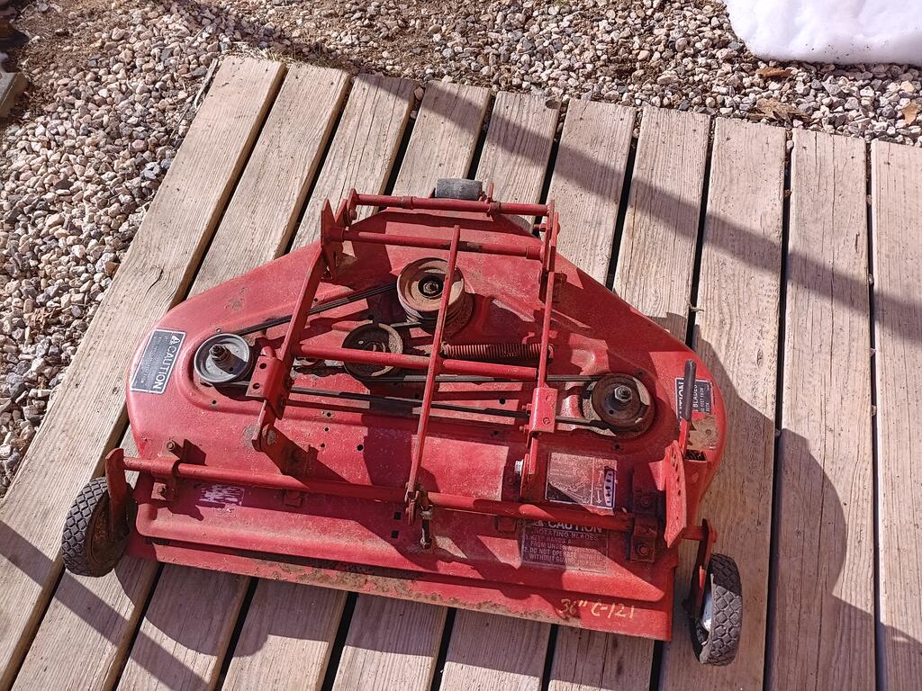

ebinmaine 79,535 #1 Posted April 9, 2024 This question is primarily about a late seventies c121 Hydro 36-in RD deck Drive belt. Looks to me like it's supposed to be a standard rubber type 1/2 in wide 96.5 or 96.7 inches in length. Is there an aftermarket belt other than the Gates Blade Runner that I can use? Will a normal average everyday ½ by 97 drive this okay? Are these the same belts used on Long frame tractors for other sizes of mower decks as well? 2 Share this post Link to post Share on other sites

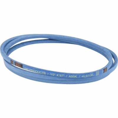

squonk 47,286 #2 Posted April 9, 2024 If your deck has the std sliding idler deck pulley like a 42" RD deck has I don't see why you can't run a Tractor Supply 1/2 X 97 belt on it. I run a TSC on mine and I believe it's 97" 2 1 Share this post Link to post Share on other sites
ebinmaine 79,535 #3 Posted April 9, 2024 30 minutes ago, squonk said: If your deck has the std sliding idler deck pulley like a 42" RD deck has I don't see why you can't run a Tractor Supply 1/2 X 97 belt on it. I run a TSC on mine and I believe it's 97" Model number decal is wiped clean unfortunately. 2 Share this post Link to post Share on other sites
Ed Kennell 46,477 #4 Posted April 9, 2024 Some of those tension bars have two different holes for the idler pulley. 2 Share this post Link to post Share on other sites

elcamino/wheelhorse 9,363 #6 Posted April 9, 2024 I use a Dayco L497 for 36 or 42 inch rd decks. 3 1 Share this post Link to post Share on other sites
squonk 47,286 #7 Posted April 9, 2024 L497 crosses to Napa/Gates 4L970W Tractor Supply 4L970K 3 2 Share this post Link to post Share on other sites
