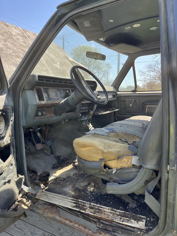

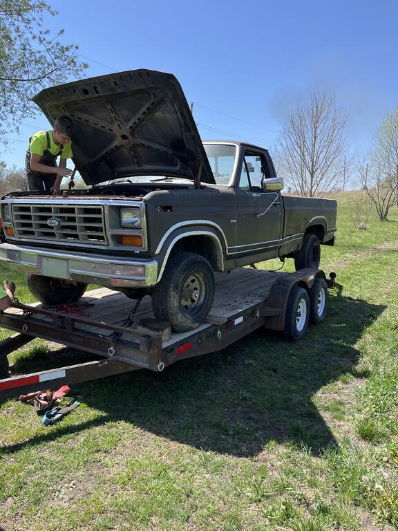

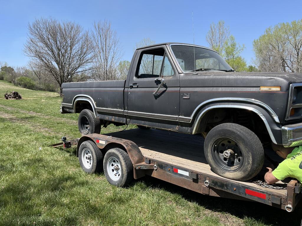

87 416-8 horse 430 #32 Posted April 15, 2024 I picked up this crusty old Ferd today for only $300. It’s pretty much identical to my other one except for it has a/c and cruise. I’ll also have some other parts I need and some extras. I’m going to part it out and keep the engine for later. It’s past saving. 1 Share this post Link to post Share on other sites

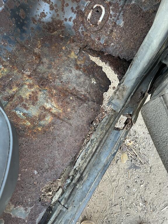

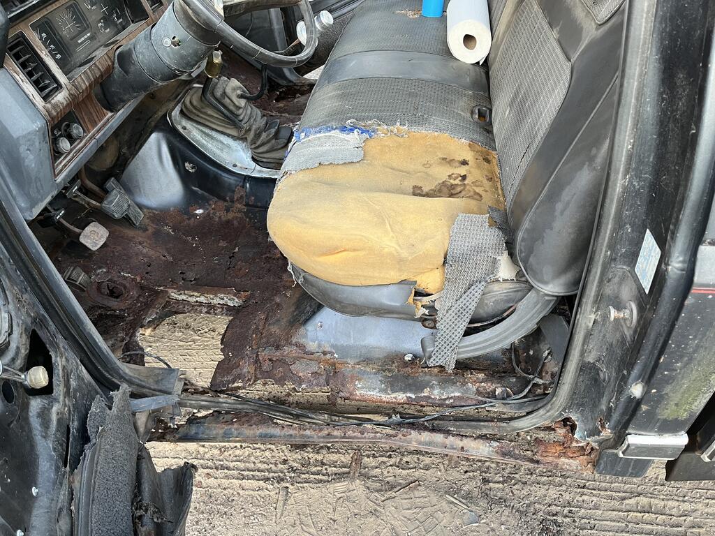

87 416-8 horse 430 #35 Posted April 15, 2024 5 hours ago, ebinmaine said: The chrome trim, wheels, and that whole front grill has value too. Everything on the front is good. The rims are perfect but every piece of the trim has drywall screws in it. Here’s some more pictures of the rust. I forgot to mention that the engine is extremely seized. It’s been off the road since 2017 1 Share this post Link to post Share on other sites

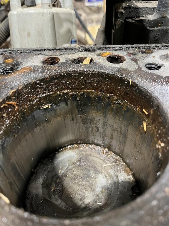

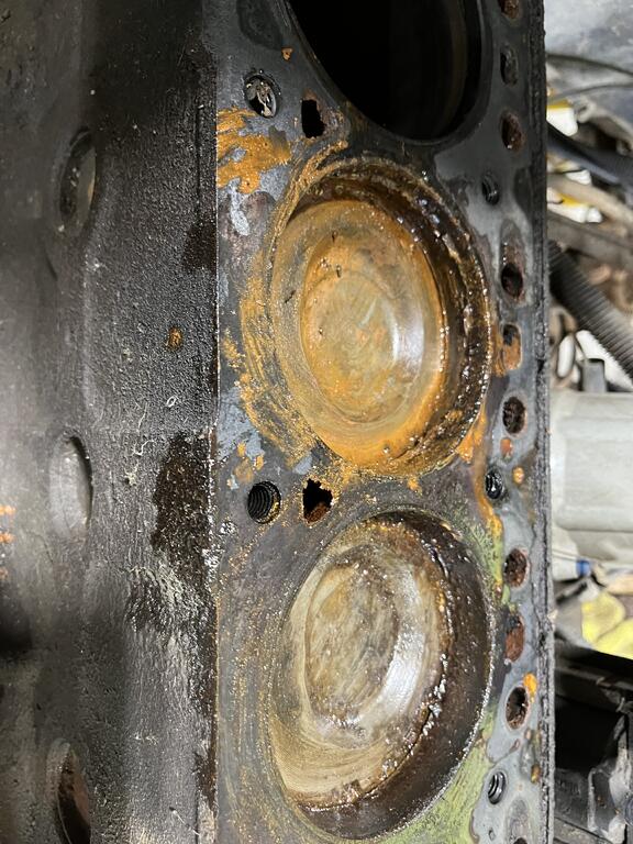

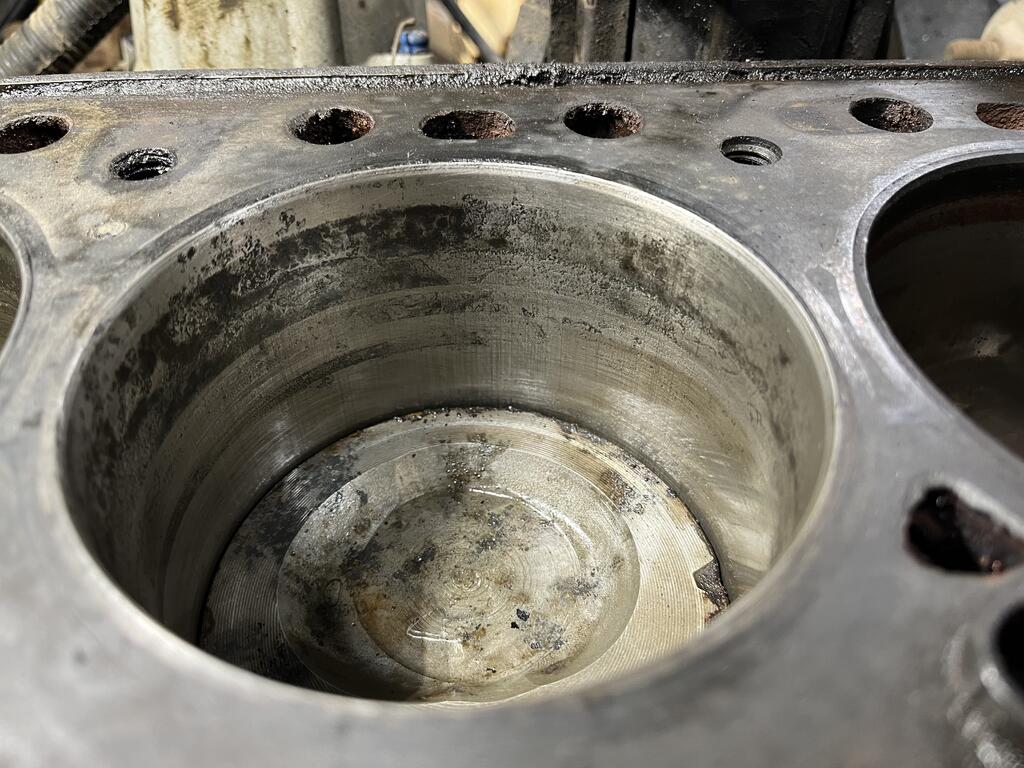

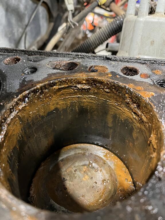

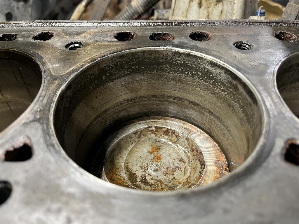

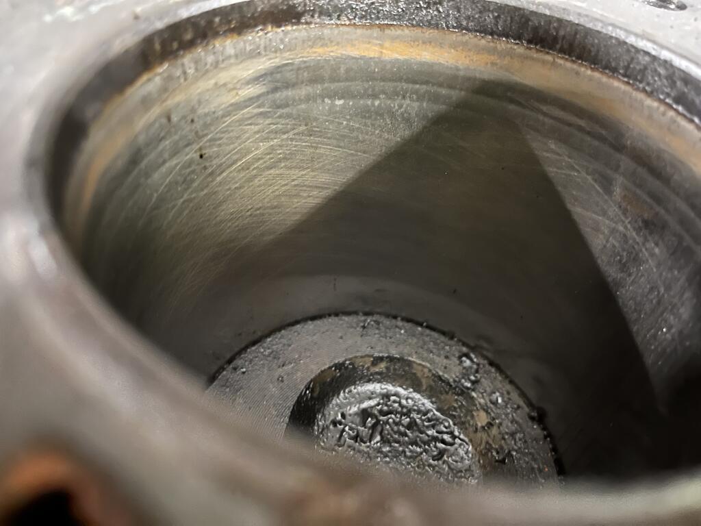

87 416-8 horse 430 #39 Posted April 17, 2024 I found it why the engine was stuck in the parts truck. When I got it I thought it had 143k miles judging by the body but I think it’s 43k because it still has the cross haching and no ring ridge! 1 Share this post Link to post Share on other sites
ebinmaine 81,281 #41 Posted April 17, 2024 Niiiiice! 1 Share this post Link to post Share on other sites
87 416-8 horse 430 #42 Posted April 18, 2024 Got the 2 cylinder all cleaned up for now. I hit them with some sandpaper and a ball hone. It spins nice and smooth now. They’re not perfect but I’m not too worried because it will probably get bored out in the future. 1 Share this post Link to post Share on other sites
ebinmaine 81,281 #43 Posted April 18, 2024 Did you find the cause? Share this post Link to post Share on other sites
87 416-8 horse 430 #44 Posted April 18, 2024 (edited) It was the two rusted cylinders. Edited April 18, 2024 by 87 416-8 horse Share this post Link to post Share on other sites
ebinmaine 81,281 #45 Posted April 18, 2024 11 minutes ago, 87 416-8 horse said: It was the two rusted cylinders. Just from exposure to something? Or was there a bad cylinder head gasket or otherwise? Share this post Link to post Share on other sites
87 416-8 horse 430 #46 Posted April 18, 2024 (edited) 1 hour ago, ebinmaine said: Just from exposure to something? Or was there a bad cylinder head gasket or otherwise? I think it sat for quite a while with the hood open and the air cleaner off because the carb is stuck and the ports in the head are a bit rusty. Someone pulled the plugs a while back and put some ATF in them but I don't think they got the water out. Edited April 18, 2024 by 87 416-8 horse 1 1 Share this post Link to post Share on other sites
ebinmaine 81,281 #47 Posted April 18, 2024 8 minutes ago, 87 416-8 horse said: I think it sat for quite a while with the hood open and the air cleaner off because the carb is stuck and the ports in the head are a bit rusty. Someone pulled the plugs a while back and put some ATF in them but I don't think they got the water out. Ahh.... 1 Share this post Link to post Share on other sites

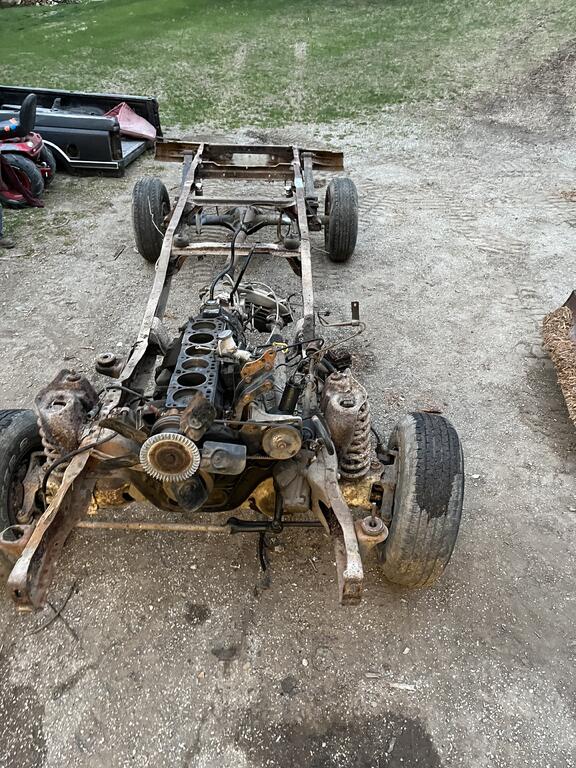

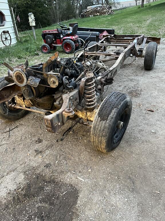

87 416-8 horse 430 #48 Posted April 25, 2024 The interior and cab are stripped out and off the frame! All the wiring is out. All I have left to do to the cab is cut the fire wall out and send it off to scrap. Next up is striping the frame down. Pull the engine, trans, and transfer case. This truck has a 3.08 limited slip diff that I’ll rebuild and throw In my truck. And pull the front gears for a spare set. 1 Share this post Link to post Share on other sites
