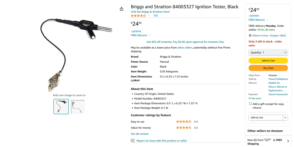

pfrederi 21,345 #9 Posted April 4, 2024 I have the $5 harbor freight spark tester but sometimes it will flash but no start. It isn't very sensitive. This B&S tester will tell you if the spark is strong enough. There are oregon and other knock offs cheaper...but I have one of those and don't think it does as well... Share this post Link to post Share on other sites
