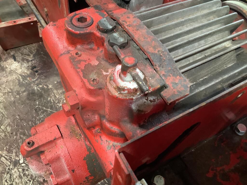

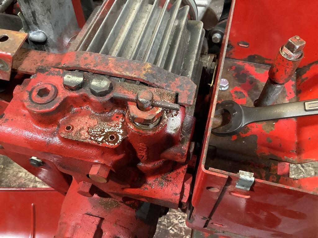

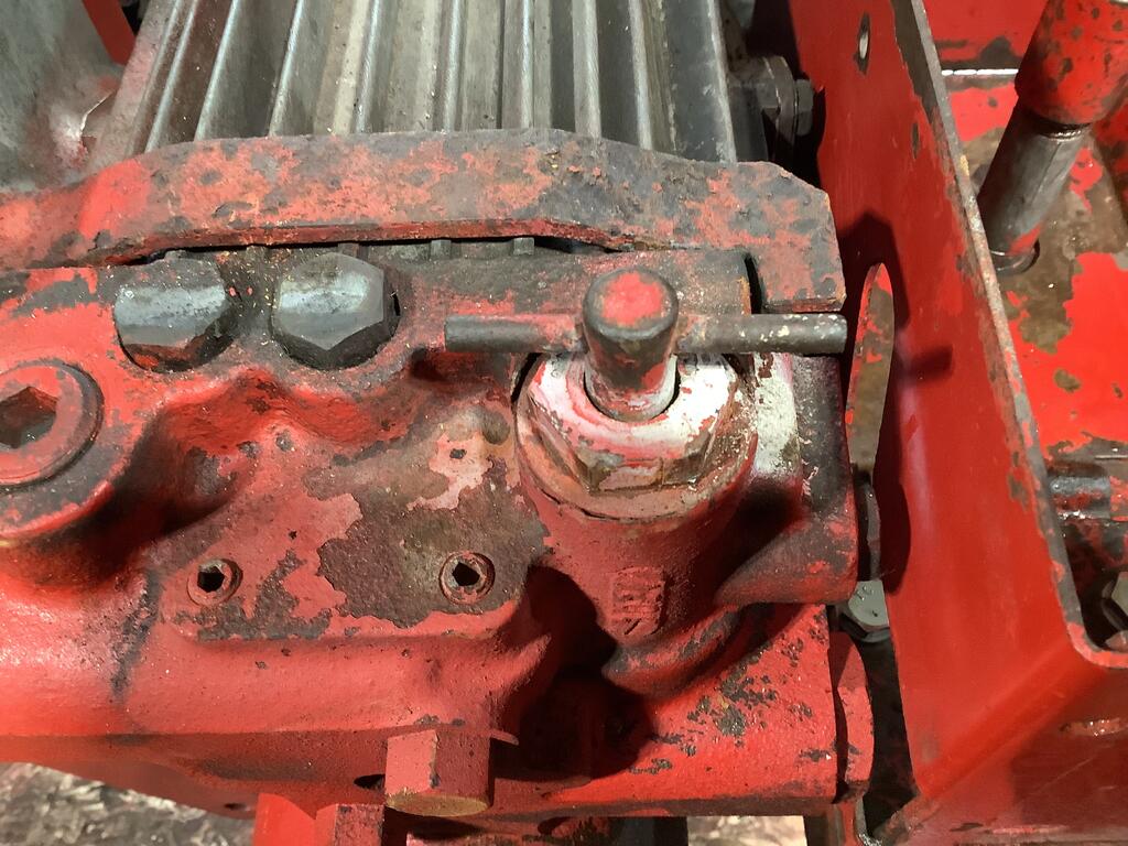

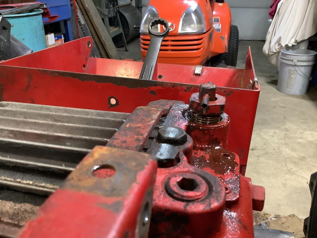

CRF857 1,139 #1 Posted April 3, 2024 Anyone have an easy fix for a stuck towing valve? Recently acquired a 1277 and cannot budge the towing valve. Share this post Link to post Share on other sites
Ed Kennell 47,382 #2 Posted April 3, 2024 to the Wow, I never had a problem with that type tow valve. Did you try to loosen the large nut? Share this post Link to post Share on other sites
lynnmor 9,042 #3 Posted April 3, 2024 There is no evidence that you are soaking it with penetrating oil. 1 Share this post Link to post Share on other sites
CRF857 1,139 #4 Posted April 3, 2024 1 hour ago, Ed Kennell said: to the Wow, I never had a problem with that type tow valve. Did you try to loosen the large nut? It turns about 60 Degrees and stops. Share this post Link to post Share on other sites
CRF857 1,139 #5 Posted April 3, 2024 1 hour ago, lynnmor said: There is no evidence that you are soaking it with penetrating oil. It is at this moment Share this post Link to post Share on other sites

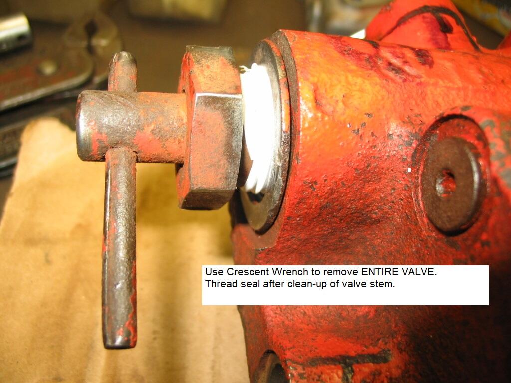

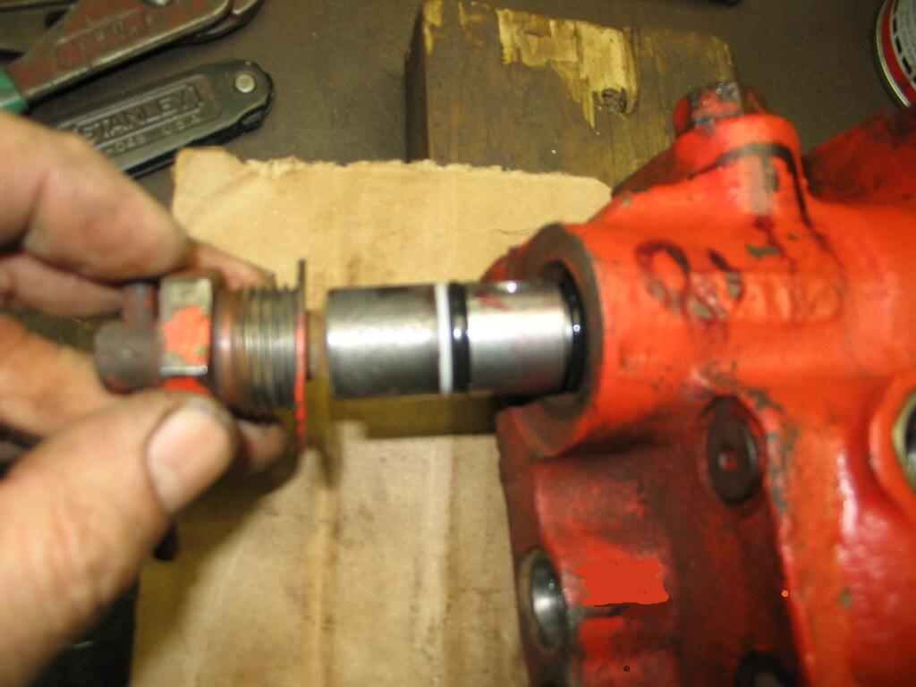

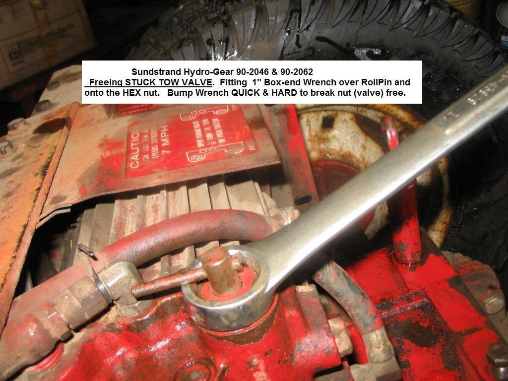

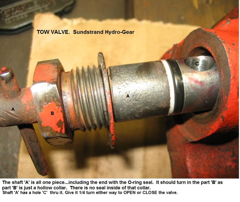

daveoman1966 3,884 #9 Posted April 4, 2024 Use a crescent wrench to remove the entire valve. Clean it up and refit as shown here. Be sure the black O-ring and the white Split ring are useable. PS--the tow valve STEM will turn 360 degrees. 2 1 Share this post Link to post Share on other sites

pfrederi 21,162 #12 Posted April 4, 2024 (edited) Turn the nut as far as you can and then start soaking. Give it time couple of days. Heat would be a last ditch effort as it will probably damage the O ring and backer. As mentioned above the valve will turn 360 The O rings are Dash#113 the backer ring is available from McMaster but you have to buy 50... Edited April 4, 2024 by pfrederi Share this post Link to post Share on other sites

daveoman1966 3,884 #15 Posted April 4, 2024 As I've shown, that 'nut' is just a COLLAR of the Valve BODY. Unscrew that COLLAR against the ROLL PIN, then unscrew that valve body some more, then the collar...until the entire valve body is removed. 1 1 1 Share this post Link to post Share on other sites
CRF857 1,139 #16 Posted April 4, 2024 9 hours ago, daveoman1966 said: Use a crescent wrench to remove the entire valve. Clean it up and refit as shown here. Be sure the black O-ring and the white Split ring are useable. PS--the tow valve STEM will turn 360 degrees. First of all thanks for the images of the valve. I was apprehensive about what was going on in that corner now that I know what it’s like underneath I will get it unstuck eventually right now the nut is completely loose but the valve itself will still not turn. I’m still soaking it and trying every so often with some pressure. 1 2 Share this post Link to post Share on other sites

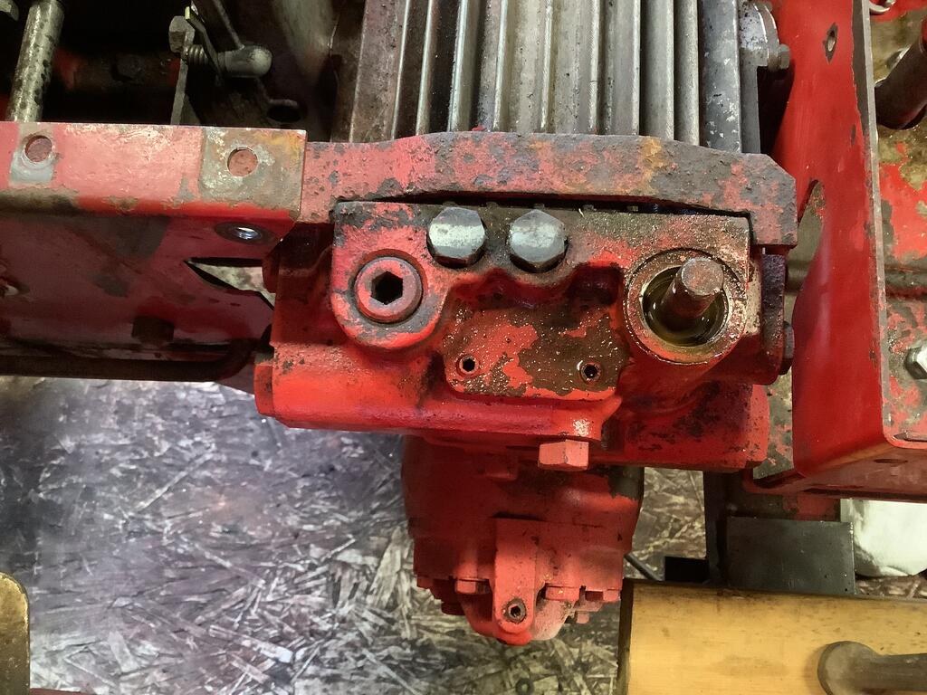

CRF857 1,139 #20 Posted April 4, 2024 Applied a little too much pressure to the valve, and snapped the roll pln. Removed the rest of the pin and the nut. The nut is completely off and the valve does not move. Still soaking. Share this post Link to post Share on other sites
