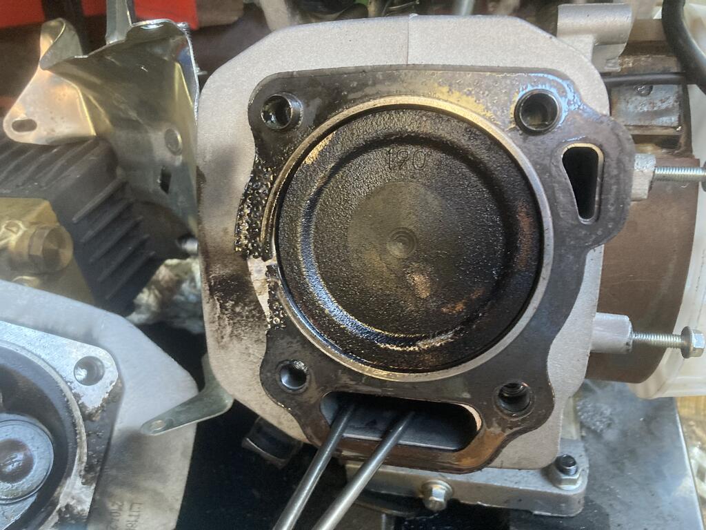

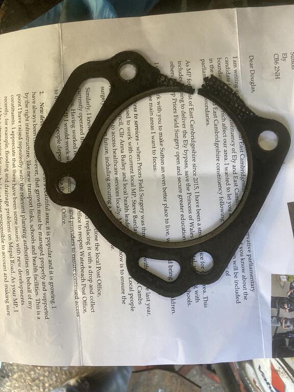

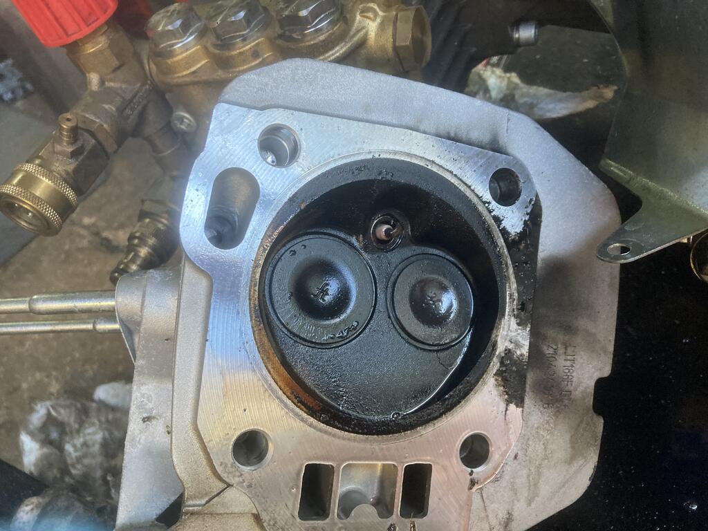

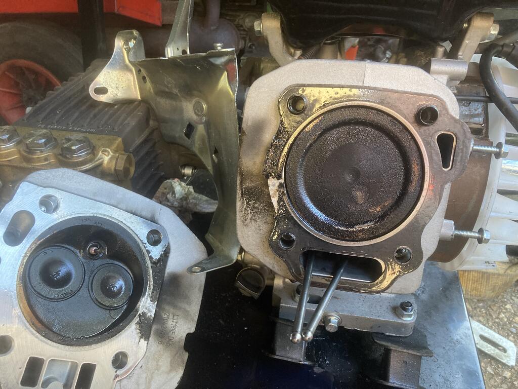

ranger 1,860 #1 Posted April 2, 2024 Hi everyone, A farmer friend of mine has asked me to have a look at a pressure washer with a 15hp 190f Honda clone engine. It was a non starter. It would backfire on pulling starter cord. After checking a few things, I found the carb float punctured, flywheel key is okay, no clearance on exhaust valve, and very little compression. Head gasket then found to have failed. My question is, bearing in mind this engine is a Chinese copy, is it safe to use the torque figures for the Honda version, GX420? Particularly for the flywheel nut, at 170 nm - 125lbf-ft? Head and block will be checked and flattened on a surface plate if necessary. p.s. It belongs to the local bowls club. I wonder how long it had been leaking before it finally failed? Share this post Link to post Share on other sites

lynnmor 9,012 #3 Posted April 2, 2024 Any chance that is a crack? 1 Share this post Link to post Share on other sites
ranger 1,860 #4 Posted April 2, 2024 I’ll have to check that,🤔 I took it apart yesterday, and haven’t looked at it since! 2 Share this post Link to post Share on other sites

squonk 47,887 #6 Posted April 2, 2024 1 hour ago, ranger said: I’ll have to check that,🤔 I took it apart yesterday, and haven’t looked at it since! Spray some carb cleaner on it and walk away and have a coffee. If it's a crack it will really show up 1 Share this post Link to post Share on other sites
ranger 1,860 #7 Posted April 2, 2024 Just went out and had a look. I had sprayed the chamber with WD before I left it, what look’s like a crack is actually carbon. Wiping with a rag, literally wiped it away! 1 Share this post Link to post Share on other sites
