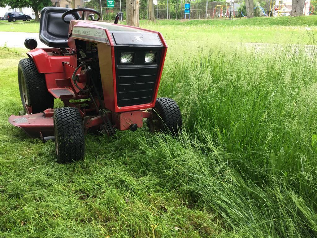

pfrederi 20,565 #4 Posted March 28, 2024 I have a patch that used to be overgrown with some miultiflora rose and very tall (5-6') goldenrod and misc. weeds. Used a bush hog a couple falls ago then in the next spring used my front mount with a 42" SD. Found a lot of rocks and surface roots but it is getting better. 3rd low is as fast as i dare go. some is 1 low. 1 Share this post Link to post Share on other sites

pfrederi 20,565 #14 Posted March 28, 2024 The front mount mower does better as the grass is not pressed down by the tractors front wheels. 7 1 Share this post Link to post Share on other sites

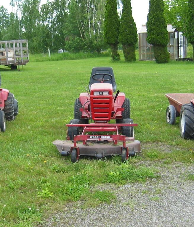

davem1111 2,274 #16 Posted March 28, 2024 22 minutes ago, pfrederi said: The front mount mower does better as the grass is not pressed down by the tractors front wheels. Is this just a frame that can be bought to mount an existing deck on, or is it custom-made? I could use one of those.... 1 Share this post Link to post Share on other sites
ebinmaine 78,882 #17 Posted March 28, 2024 1 hour ago, kpinnc said: cut quality Quality is no issue. Only shorter green stuff. 1 hour ago, kpinnc said: 48 is your best bet. Use it with 14 or more horsepower. Mow slow My thought for this year was to use the very elevated Cinnamon Horse C160 to get the tall grass into submission. But.... as pointed out by @Stepney above .. The large diameter front tires might be a clearance problem for the deck shell. Share this post Link to post Share on other sites
ebinmaine 78,882 #18 Posted March 28, 2024 3 minutes ago, davem1111 said: Is this just a frame that can be bought to mount an existing deck on, or is it custom-made? I could use one of those.... It's a Wheelhorse Implement. Not super common from what I understand. I'm thinking I'd be interested in having one here. 2 Share this post Link to post Share on other sites
CCW 1,505 #19 Posted March 28, 2024 One solution might be to mount the decks on some larger diameter wheels to raise the cut level that is either towed or mounted on the front. Just spit balling here and not sure if this is practical solution. 3 Share this post Link to post Share on other sites
lynnmor 8,827 #20 Posted March 28, 2024 32 minutes ago, ebinmaine said: It's a Wheelhorse Implement. Not super common from what I understand. I'm thinking I'd be interested in having one here. A_Z Tractor has one on a 312 for sale on eBay. It's only money. 2 2 Share this post Link to post Share on other sites
