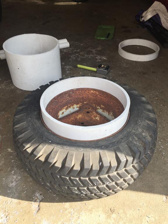

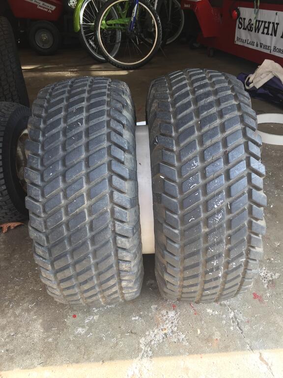

Pullstart 69,880 #7 Posted March 28, 2024 I’ve got about 6’ of 12” PVC pipe… 1 Share this post Link to post Share on other sites

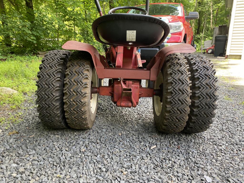

Sparky-(Admin) 25,164 #8 Posted March 30, 2024 On 3/27/2024 at 8:15 PM, Pullstart said: I’ve got about 6’ of 12” PVC pipe… This is the best way to do it. My tractor in these pics has the more stout Unidrive trans, so it should be able to handle duals without an issue. Not to mention I just putt around shows with it, never sees any real work. 3 1 Share this post Link to post Share on other sites
SylvanLakeWH 31,301 #9 Posted March 30, 2024 @Pullstart has the 12" pvc pipe I used... and the tractor! 1 Share this post Link to post Share on other sites
