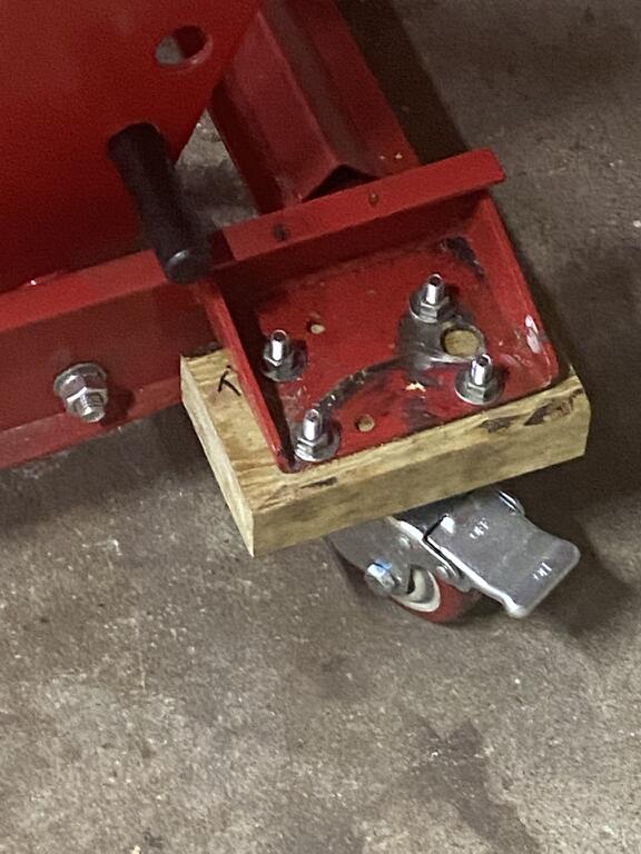

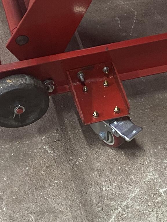

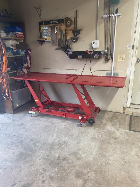

PWL216 1,262 #1 Posted March 25, 2024 I work out of a one car garage and needed to be able to easily move the lift table so my wife can get her car in. This was non-negotiable I bought locking swivel casters with 2k pound capacity. For the front I had to use 2x4 pt wood to build it up high enough for the casters to fully spin. In the back I welded up some brackets. Works really well. IMG_0525.MOV 5 5 Share this post Link to post Share on other sites

c-series don 12,311 #6 Posted March 26, 2024 I like this, I have the exact same table and I have thought about doing the same thing. I’ve never attempted to move the table once there was a tractor on it, it seems like it would be too heavy and difficult. Definitely would not try to move it with a tractor lifted on the table. One thing I found was it is easiest to move it raised up with nothing on it. That’s where those casters would make it super easy to move. The table is one of the best tools I’ve bought for my shop, really makes working on tractors so much nicer. @PWL216 What do you use for a ramp to get tractors onto the table? The ramp it comes with is not wide enough as you must know. I have a few ideas but for now I’m just using short wood ramps and blocks. 3 Share this post Link to post Share on other sites

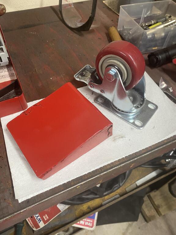

PWL216 1,262 #7 Posted March 26, 2024 (edited) @c-series don I use the same - short wood planks with rubber tire chocks. A better ramp is the next problem to solve. I also find the table easier to move when it’s fully lifted. I do intend on moving the table with a tractor on it. I’ll let you know how it goes in terms of ease, stability and safety. I built extension wings for it, not shown in the picture. The picture is of the 3” casters I bought. They seem to be very good quality and come with nuts/bolts and a wrench. Edited March 26, 2024 by PWL216 3 Share this post Link to post Share on other sites
ebinmaine 80,091 #8 Posted March 26, 2024 4 hours ago, PWL216 said: I do intend on moving the table with a tractor on it. I’ll let you know how it goes in terms of ease, stability and safety. As long as you keep the table as low as possible while moving it around, you will likely be fine. For the sake of safety it might be best stand on the side of the table that permits you to push it away from you. That way if it falls it's going to be prone to go away from your general direction. For the record, that's not the way I would do it. But as you know I have a fair amount more "mass" than most. 😂 2 Share this post Link to post Share on other sites
PWL216 1,262 #9 Posted March 27, 2024 Video of how easy it is to move the table with a tractor on it… IMG_0543.MOV 3 Share this post Link to post Share on other sites
ebinmaine 80,091 #10 Posted March 27, 2024 59 minutes ago, PWL216 said: Video That looks great. I don't see any stability issues there at all. Excellent solution. 1 Share this post Link to post Share on other sites
