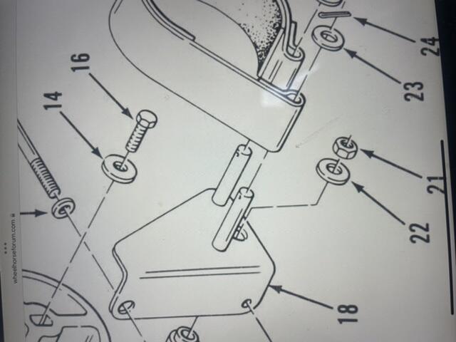

Handy Don 16,961 #9 Posted March 24, 2024 This post might help. It might be as simple as a lost/broken/rusted off cotter pin. The 518 had an Eaton 700, but the brake-setting-to-neutral linkage hardware is identical. 2 1 Share this post Link to post Share on other sites
AHS 1,695 #10 Posted March 25, 2024 17 hours ago, Handy Don said: This post might help. It might be as simple as a lost/broken/rusted off cotter pin. The 518 had an Eaton 700, but the brake-setting-to-neutral linkage hardware is identical. Oh ya!!! Diagrams!! Exactly what I wanted! Thank you so much!! I guarantee its a cotter pin!! Share this post Link to post Share on other sites

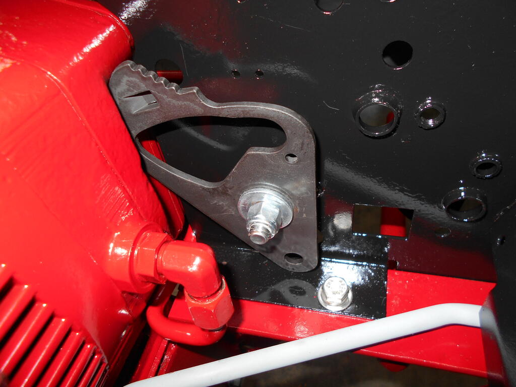

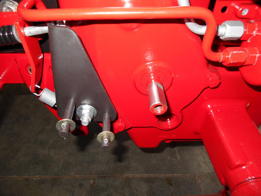

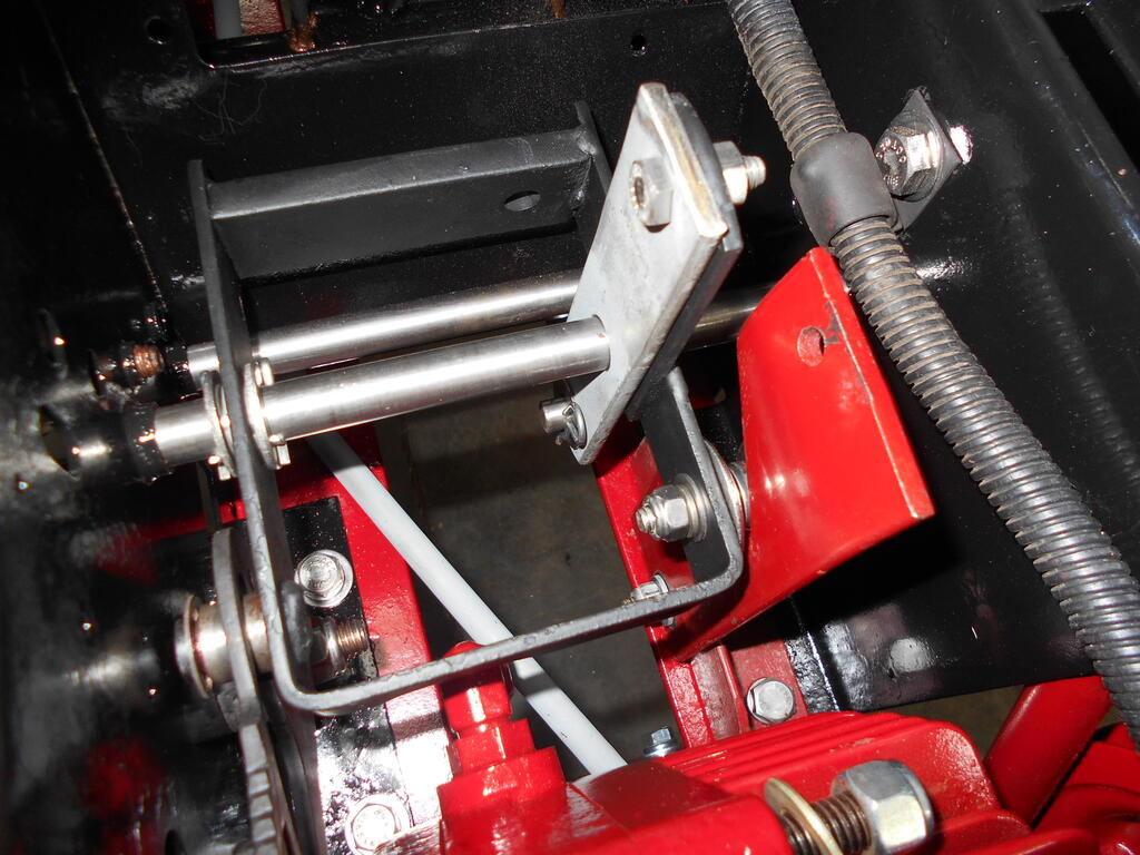

cleat 9,056 #11 Posted March 25, 2024 I found a couple of pictures that might help. This is the cam plate that forces the motion control to neutral. The serrations at the top are for the parking brake latch. The hole in the bottom is where the brake rod connects although it is not installed in this picture. Here you can see the motion control block with the return to neutral roller engaged into the cam plate near the bottom left. This tractor has been converted to foot control so you can ignore the extra parts on the right side. 2 Share this post Link to post Share on other sites

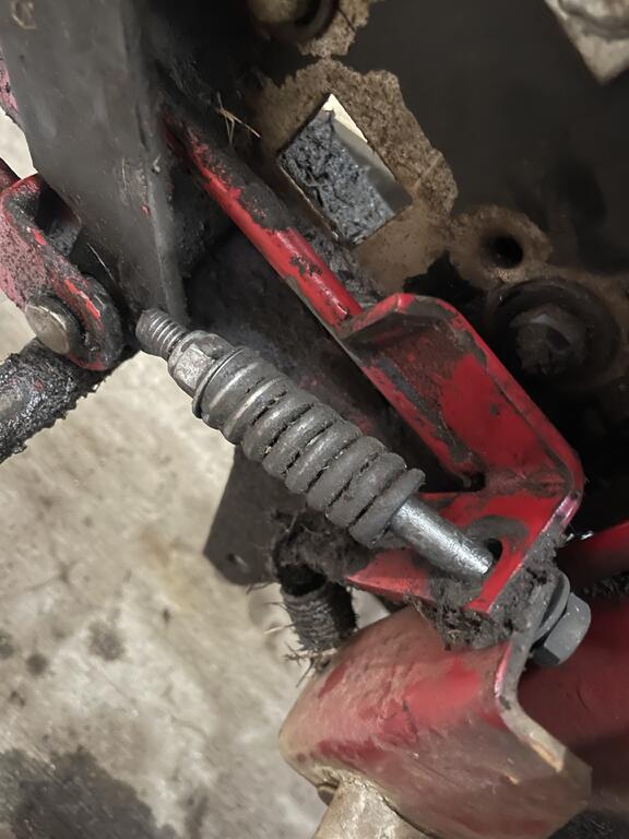

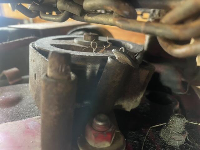

AHS 1,695 #13 Posted March 27, 2024 Ok, i found what the problem was—- just how to get in there!! The hole where the brake rod is connected. .. With a cotter pin? With a hair pin clip? Also the brake spring/bolt? Is that even close to original? Wow!! 1 Share this post Link to post Share on other sites

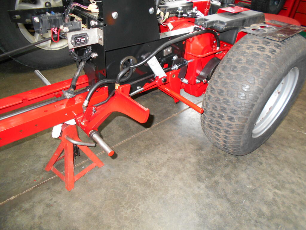

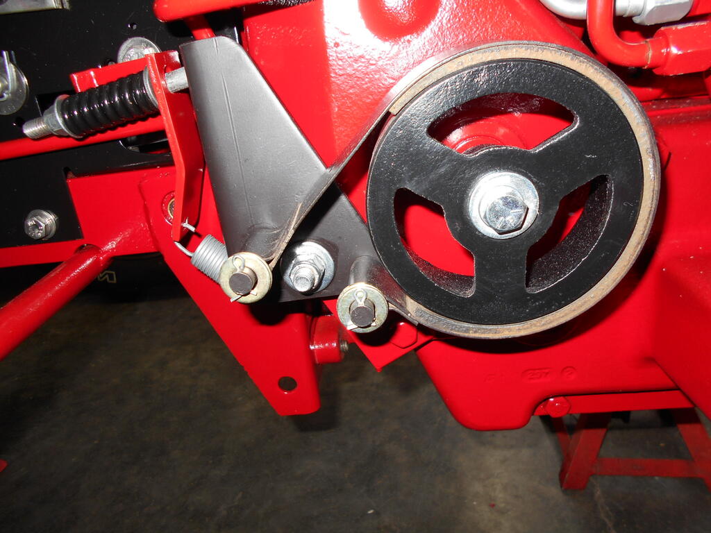

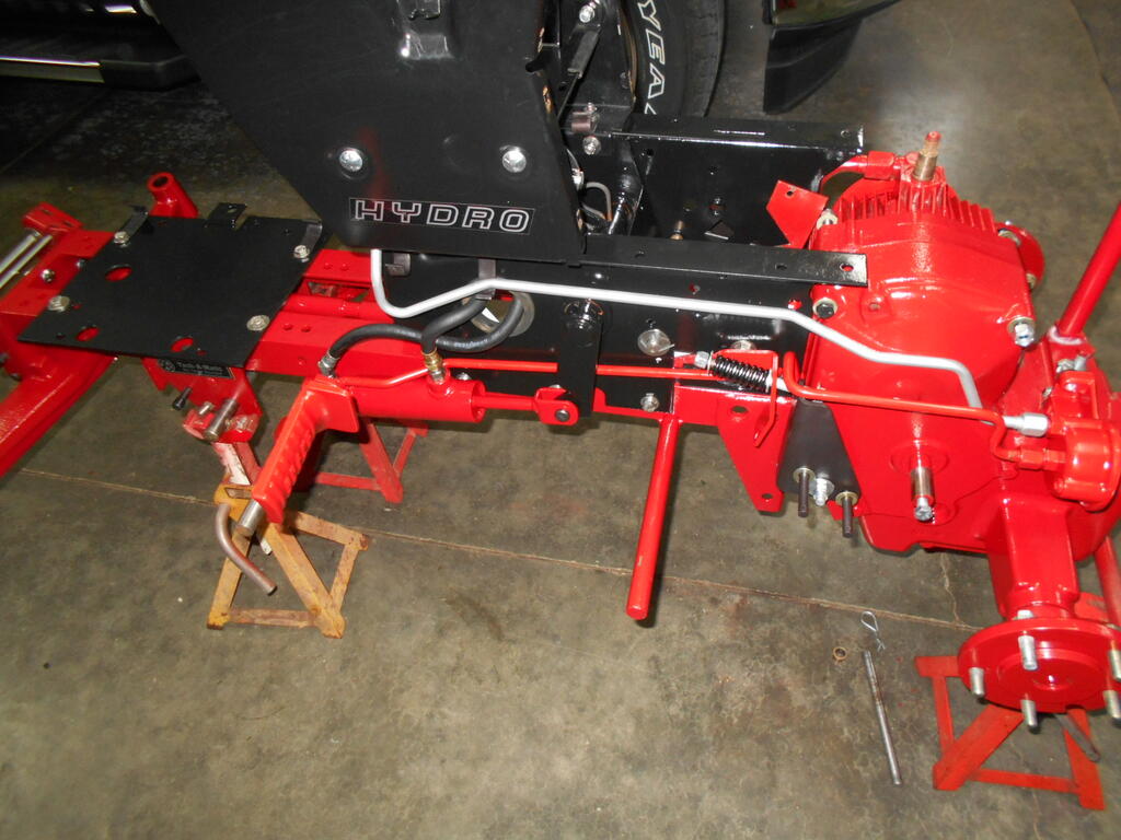

cleat 9,056 #14 Posted March 27, 2024 Cotter pin or a hairpin clip through the brake rod to hold it in place will do fine. There is a little hole in it for that purpose. This little exploded parts manual should help as well. Wheel horse 520H parts and service manual.pdf Brake spring is correct and here are two of my tractors showing it. Here is a little guide on setting it up. Wheel horse 520H service manual.pdf 1 Share this post Link to post Share on other sites

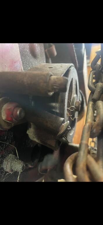

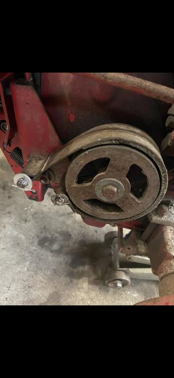

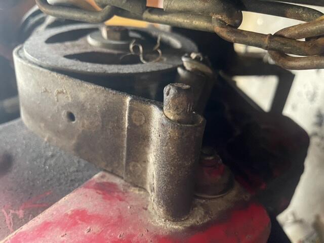

AHS 1,695 #15 Posted March 27, 2024 Ok! Got it fixed! Broken off cotter pin in the brake arm.. so I took the brake arm off and pounded the cotter pin out and replaced it with a hair pin! Lubed all the hydro shifts linkage and it works ultra smooth! I do have one question though… about my brake pivot arm… the lower arm is bent and the brake lining is all cock eyed. Share this post Link to post Share on other sites
cleat 9,056 #16 Posted March 27, 2024 Pins should be straight and have cotter pins to hold the brake band on. Pull off the band then straighten the pins best you can (you may need a deep socket with an extension or use an adjustable wrench. You can straighten the brake band by hand if required, it is very thin steel. 4 1 Share this post Link to post Share on other sites

AHS 1,695 #21 Posted March 29, 2024 (edited) Well, I got this done. No brakes and not shifting to neutral on a 20hp…done and done!! (All fixed now!) That lower one was tweaked pretty hard! Edited March 29, 2024 by AHS Typo 4 Share this post Link to post Share on other sites
