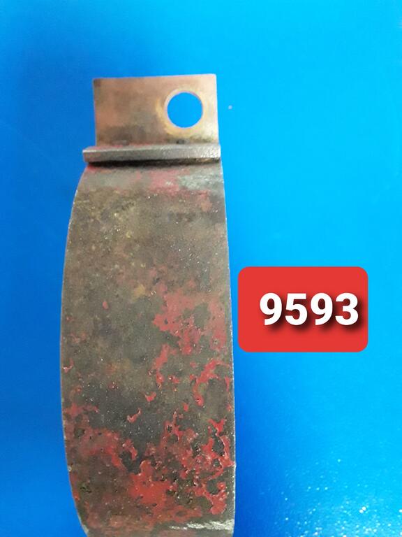

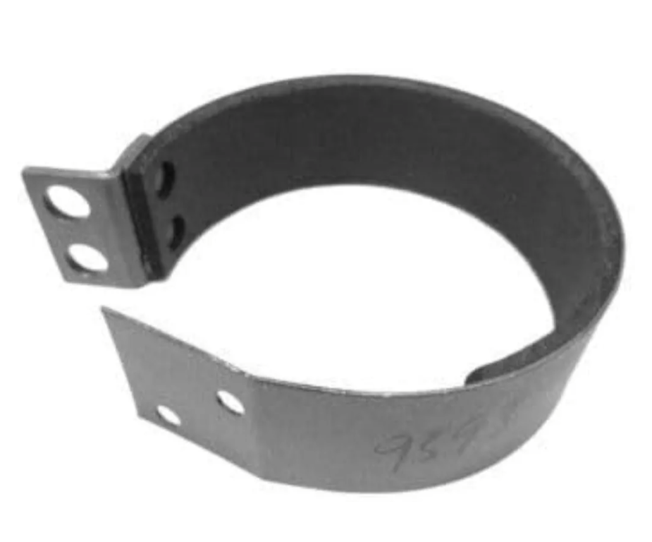

rmaynard 16,885 #3 Posted March 22, 2024 I think you have the wrong band. Hole should be on the left. A double hole band is needed, or try drilling another hole. 11 4 2 Share this post Link to post Share on other sites

johnnymag3 2,641 #5 Posted March 22, 2024 (edited) There is an alignment issue.......rod is pushing band to the outboard side......it should be in a different Brake band, or a longer pivot...to push straightforward. There are different bands with multi holes as mentioned. My .02 Edited March 22, 2024 by johnnymag3 3 1 Share this post Link to post Share on other sites
peter lena 9,778 #6 Posted March 22, 2024 @johnnymag3 , think I might try , flipping that band over , looking at it , the outside hole point , would be on the INSIDE , for better alignment . just me , pete 2 Share this post Link to post Share on other sites

peter lena 9,778 #9 Posted March 22, 2024 @rmaynard brake rod is saposed to push straight back , correct ? so if you unhook the push rod , turn the bracket over , so the rod hole is inside , of band the push rod would , be pushing against the strength of the band , inside thrust would hold the band in place / without slid force angling it to outside . thats what I see , BTW , also use conveyor belting , for my brakes . just my view of the situation , pete Share this post Link to post Share on other sites

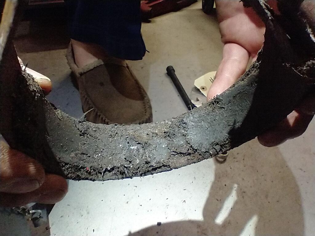

rmaynard 16,885 #11 Posted March 23, 2024 After watching the video again, the brake band never returns to a straight, untwisted condition, leading me to assume that the band is damaged. 1 Share this post Link to post Share on other sites
wallfish 19,370 #12 Posted March 23, 2024 (edited) Pull the band off and twist it back into shape. Drill a hole on the other side of the flange and adjust it properly then give it a try. The only cost is time. Edited March 23, 2024 by wallfish 4 Share this post Link to post Share on other sites

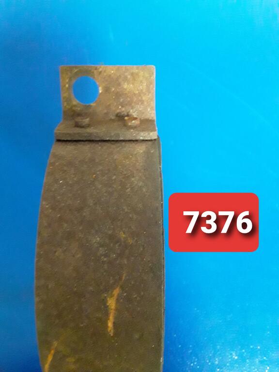

ebinmaine 77,504 #13 Posted March 23, 2024 44 minutes ago, wallfish said: Pull the band off and twist it back into shape. Drill a hole on the other side of the flange and adjust it properly then give it a try. The only cost is time. My thoughts exactly. I straightened the band while still on the tractor but it was too full of muck to leave it. That's grass dirt grease etc. While cleaning that all out the show fell out. Off to the parts shelf I went. Found an older C series piece that has two holes AND a good shoe. 3 Share this post Link to post Share on other sites
ebinmaine 77,504 #14 Posted March 23, 2024 Followup and solution: 3 2 Share this post Link to post Share on other sites
