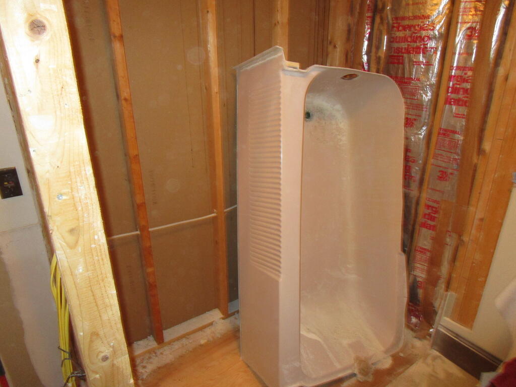

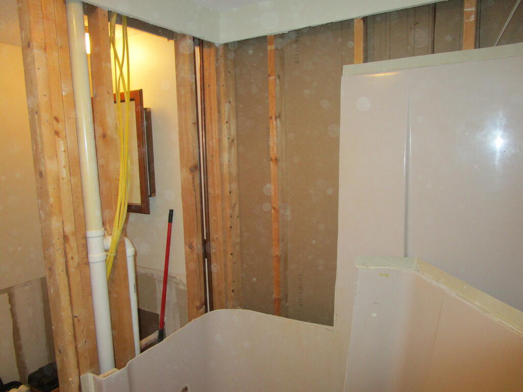

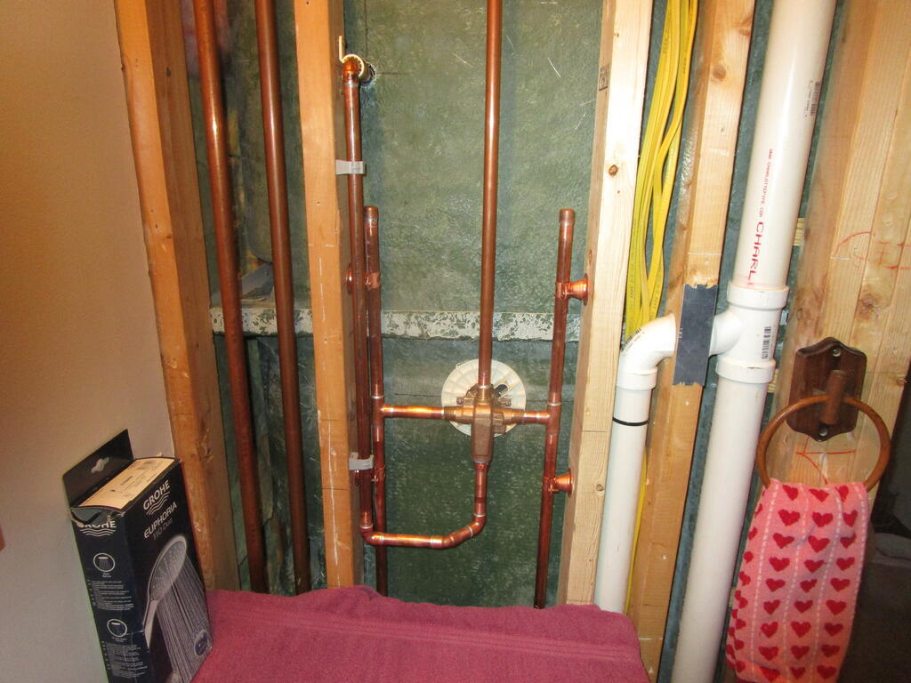

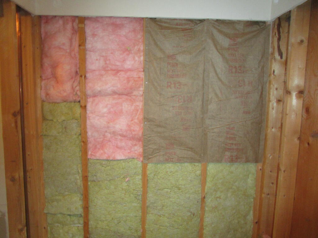

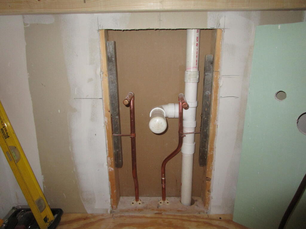

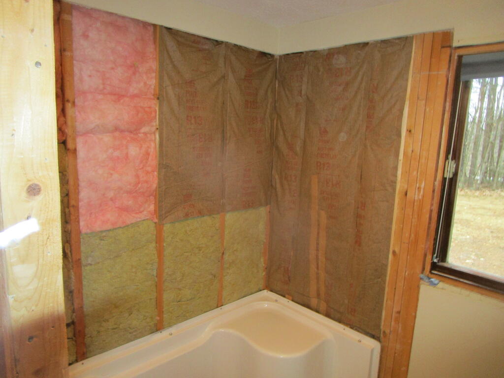

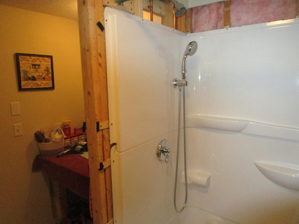

JCM 10,539 #1 Posted March 17, 2024 Been putting this project off since 2009. My significant other decided to take a vacation far away for 7 days. This was her Birthday present when she returned home.I figured with the amount of dust etc it was an ideal time to get the hard part out of the way. For now using the 2nd floor bath. Decided to go with a walk in multi-piece fiberglass shower with seat and remove the 1980 Kohler 1 piece tub and shower unit. Still some work to go till the finish line. 6 7 Share this post Link to post Share on other sites
Pullstart 68,696 #2 Posted March 18, 2024 All that copper work, your plumber must be expensive! 1 4 Share this post Link to post Share on other sites
Bill D 2,522 #3 Posted March 18, 2024 Beautiful work and no pro press fittings in sight. 4 1 1 Share this post Link to post Share on other sites
ebinmaine 76,696 #4 Posted March 18, 2024 7 hours ago, Pullstart said: All that copper work, your plumber must be expensive! He is. But he does great work. 3 2 Share this post Link to post Share on other sites
ebinmaine 76,696 #5 Posted March 18, 2024 Looks great so far Jim! Nice idea on the "setting" tub. 2 Share this post Link to post Share on other sites
Pullstart 68,696 #6 Posted March 18, 2024 1 hour ago, ebinmaine said: Looks great so far Jim! Nice idea on the "setting" tub. That is a pretty standard procedure I believe. Our tub is a 6’ garden jacuzzi and I required a 1” mortar bed, if I recall. 3 Share this post Link to post Share on other sites

Handy Don 15,674 #11 Posted March 18, 2024 Do you still have enough access to frame in attachment points for safety bars? 2 1 Share this post Link to post Share on other sites

ri702bill 11,032 #13 Posted March 18, 2024 19 minutes ago, Handy Don said: Do you still have enough access to frame in attachment points for safety bars? A valid point. Our walk-in tub came with two short stainless ones in the tub, we had the installer add two larger ones up on the wall..... love to read the Sunday newspaper in the tub with the water jets on.... that was 2016. Back in 1985, I remodeled our only bathroom, ditched the old worn cast iron tub in favor of a 2 piece "Remodeler" like yours. I insulated the back and side walls AND the backside of the tub and enclosure - took a lot of that "oil canning" movement out.... 4 Share this post Link to post Share on other sites

JCM 10,539 #15 Posted March 18, 2024 This unit does not require a mortar bed. Note in the instructions said no ''wet-set required to support the floor under an Oasis product due to the encapsulated Balsa wood construction. I still felt safer with a mortar bed as I have always done with Fiberglass units. @Pullstart This is also the first time I have installed this brand. 2 2 Share this post Link to post Share on other sites
JCM 10,539 #16 Posted March 18, 2024 I have 2, 18'' stainless steel grab bars that will go on at the finish , one on each end screwed into the framing as you enter. Thanks for your concern. @Handy Don 3 1 Share this post Link to post Share on other sites

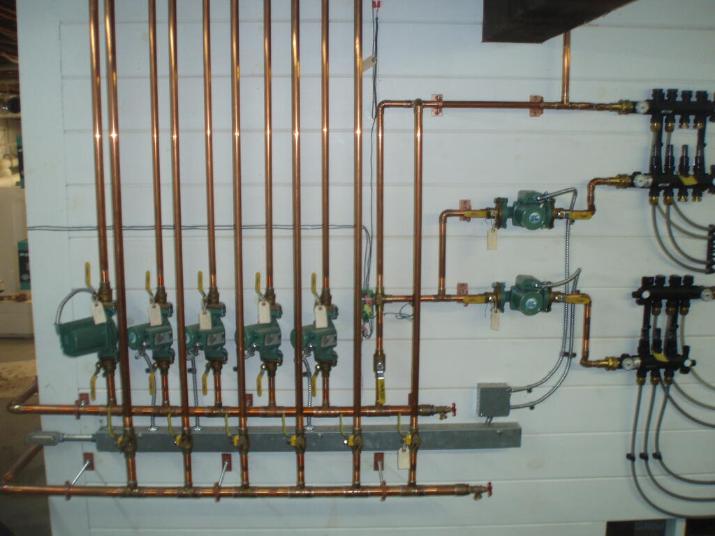

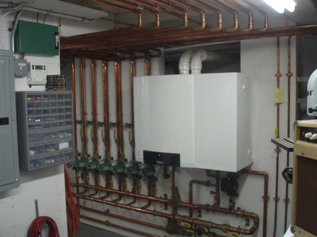

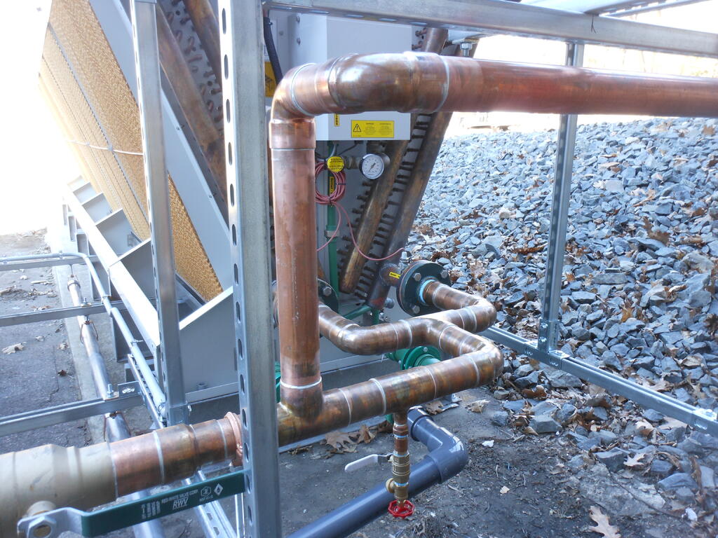

JCM 10,539 #17 Posted March 18, 2024 1 hour ago, JoeM said: yep a lot of folks here doing the same thing. Pex or plastic conversion. I have always given the customer a pex or type L copper choice. I prefer copper and never had any issues with it since the 70's. You just really can't give a professional looking job with pex IMHO. Pictures of some copper work. Thanks @JoeM 1 7 Share this post Link to post Share on other sites
Handy Don 15,674 #18 Posted March 18, 2024 1 hour ago, JCM said: some copper work Where the water chemistry permits, you have sufficient access for routing, and there is little risk of freezing, copper does rule. As you know, Jim, there are plenty of situations where poly is the better way. 3 Share this post Link to post Share on other sites

ri702bill 11,032 #20 Posted March 18, 2024 Circulator City!! Done right, with a self cleaning ball valve above and below each unit - makes changeout a breeze. Gate valves are terrible for that application..... 2 Share this post Link to post Share on other sites
