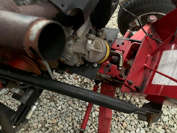

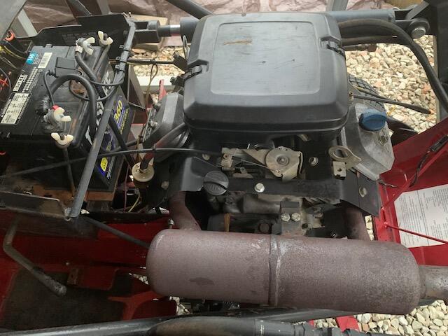

JoeM 9,718 #3 Posted March 14, 2024 I did one for my son a few years ago Excellent choice. Had one on an FEL also Homemade muffler on this one. 1 2 Share this post Link to post Share on other sites
