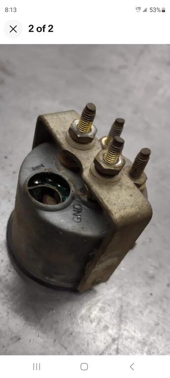

AHS 1,675 #55 Posted March 12, 2024 Well, my fuse instantly blows once i power up the tach. Ive checked continuity between positive and ground. Ground and the steel bar that wraps around it.. continuity. I dunno. 1 Share this post Link to post Share on other sites
cleat 8,979 #56 Posted March 12, 2024 (edited) The mounting bracket on the back of the tach passes over the positive and negative terminals but has little plastic insulators where the Threaded terminals pass through. Maybe the plastic insulator on the positive terminal is broken or missing. You can just make them out in this picture. Edited March 12, 2024 by cleat 1 Share this post Link to post Share on other sites
AHS 1,675 #57 Posted March 12, 2024 10 hours ago, cleat said: The mounting bracket on the back of the tach passes over the positive and negative terminals but has little plastic insulators where the Threaded terminals pass through. Maybe the plastic insulator on the positive terminal is broken or missing. You can just make them out in this picture. So, the ground on the left. The positive is on the right and the signals the lower right? I checked that plastic, and its there. There is continuity for the ground to the mounting strap. There is no continuity between the positive and the mounting strap. Tach junk? Expensive junk!! 1 Share this post Link to post Share on other sites
