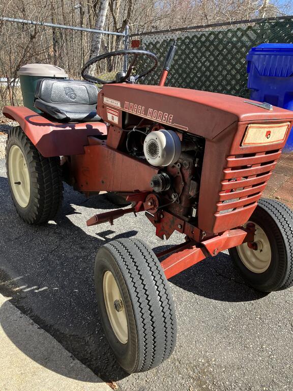

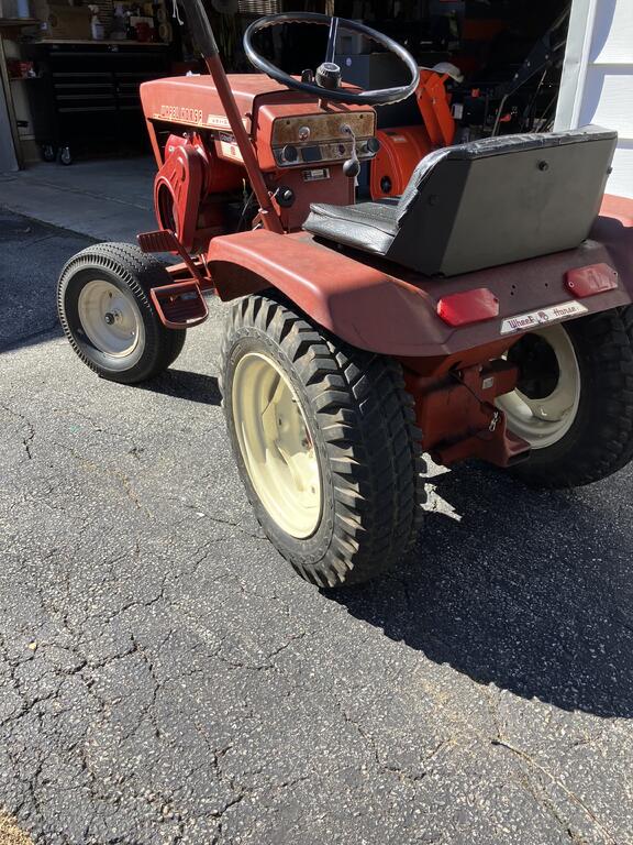

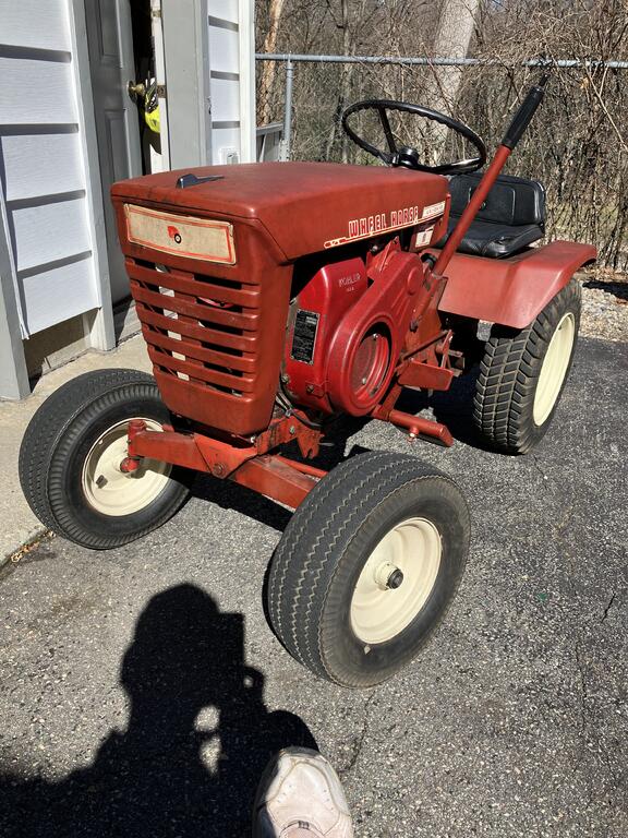

Retired Wrencher 6,439 #1 Posted March 3, 2024 I have been working on this since last year with a failed attempt because of cheap over the big pond rebuild kit. Want to give BIG thanks to @Docwheelhorse. For picking up this engine for me in January. It was a partial 856. Yes it has been that long. I had to switch over parts from the bad engine to this one witch is a vacuum engine being my first. Been a long good day out side in the sun. I hope you enjoy the picks and one Video. IMG_1467.mov 10 22 Share this post Link to post Share on other sites
