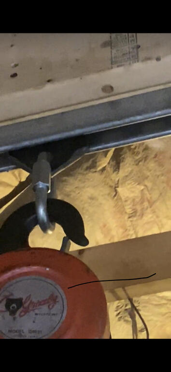

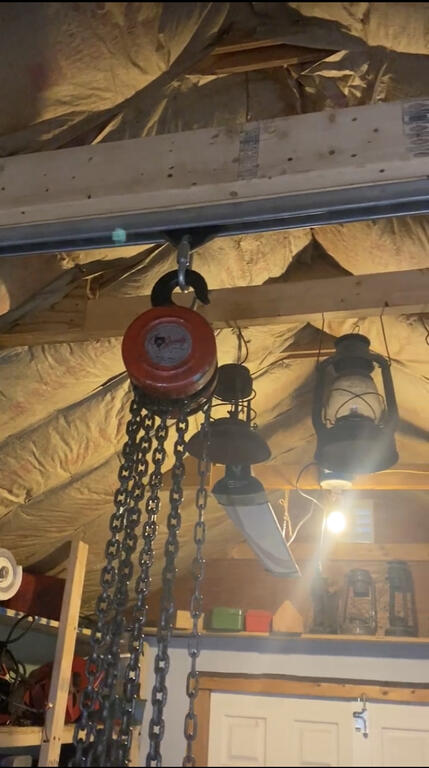

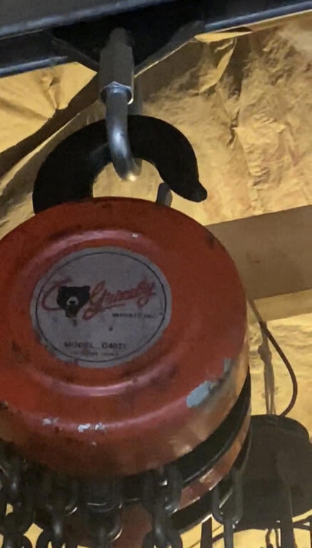

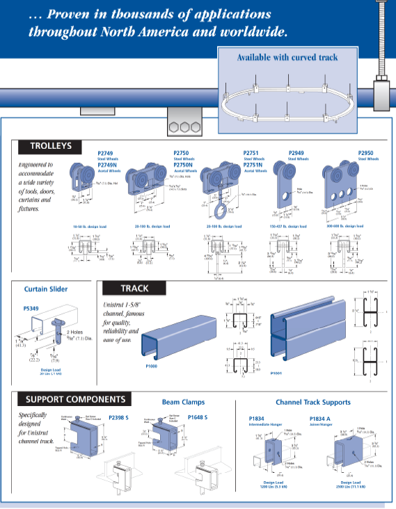

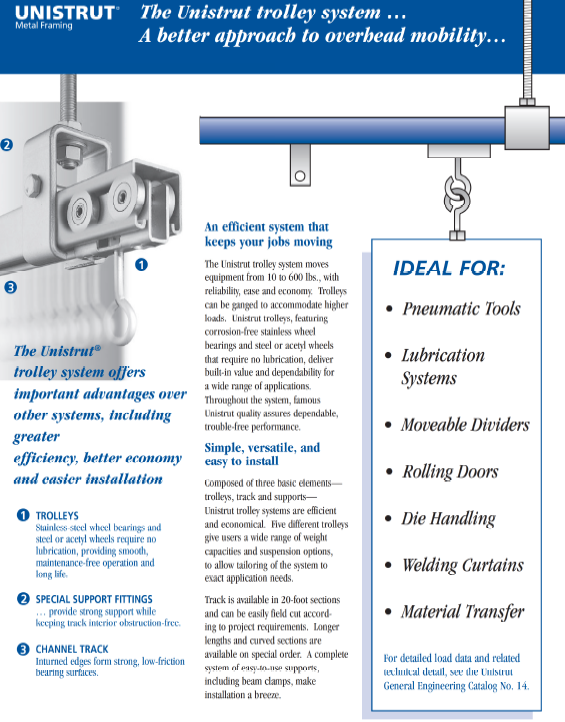

JoeM 10,318 #1 Posted March 3, 2024 I have one of these UniStrut trolleys in the shop and it works really well and is inexpensive to purchase. Rated up to 600 pounds, nice for moving engines, decks etc. Just wanted to pass it along. Trolleys are $27 for a pair The strut is $36 for a 10' section. 3 7 Share this post Link to post Share on other sites
