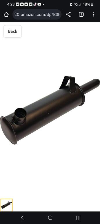

My outlet pipes on my K series measure 1.260" (1"npt), has anyone used these mufflers on their engines, if so what pipe did you use? Ive got an 8hp and a 12hp that need new exhaust...want to see if this muffler can be made to fit that pipe

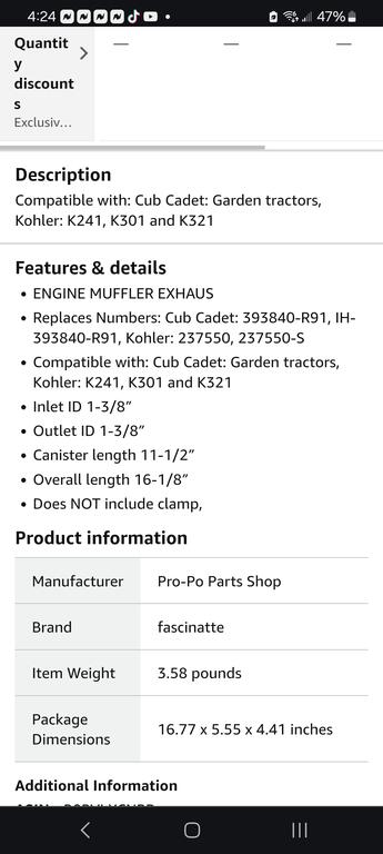

Do you recall anything special about the inlet?  The 1"npt seems pretty common but its smaller than 1⅜ (1.375 to 1.260)

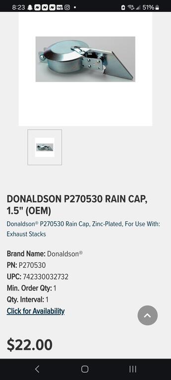

What rain flapper are yall using, i see 1 3/8 and the flapper is always "in a range" of sizes

This says 1.5", I can probably make it fit, i normally make a soot/spark arrester screen when i do a stack so the screen will go down into the muffler and a skirt will be around the top, i can tuck it under the flapper "clamp".

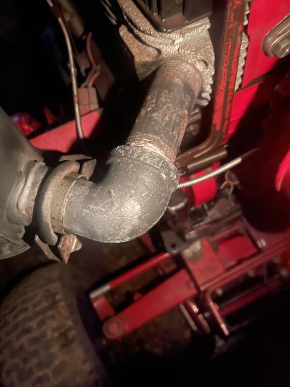

midpack

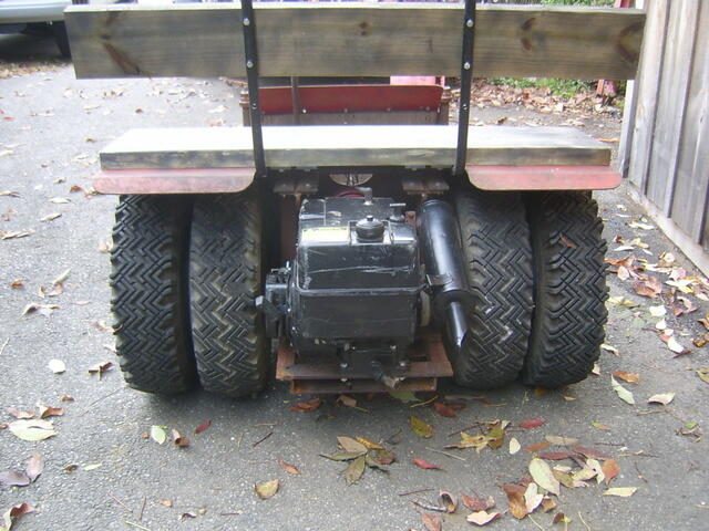

I used one of those like this. I had a section of exhaust pipe from a blown up KT-17 that I used on the end to direct the exhaust and still use the PTO
  • Like 2

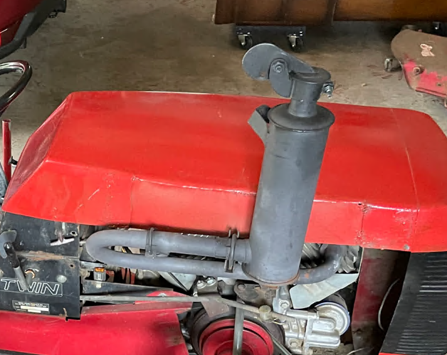

davem1111
This looks like the same muffler I bought to put on my GT-1848. Had to fabricate a bracket to hold it steady.  I got the flapper at Rural King, had to cut a bit off the top of the muffler where it was angled to put the flapper on.  It's got a nice "throaty" sound, a bit on the loud side and I always wear my earmuffs unless I'm only idling it.
[edit:] Forgot to mention that this is a Honda GX610 that some PO had repowered it with. The OEM muffler on that engine is why the hood was cut. One of these days I'll finish restoring the hood to better shape, or replace it. For now I welded some sheet metal on there and sprayed it.

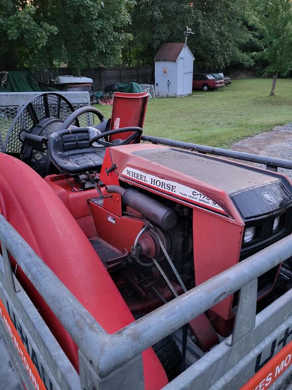

Got it on and put new rings/piston in the 702.  Really like the mellow sound.  I picked up like 60" of pipe off ebay I think its was for $40 shipped, slipped perfectly over the outlet and the flap fit perfectly, great pipe, nice and thick, easy to weld on.

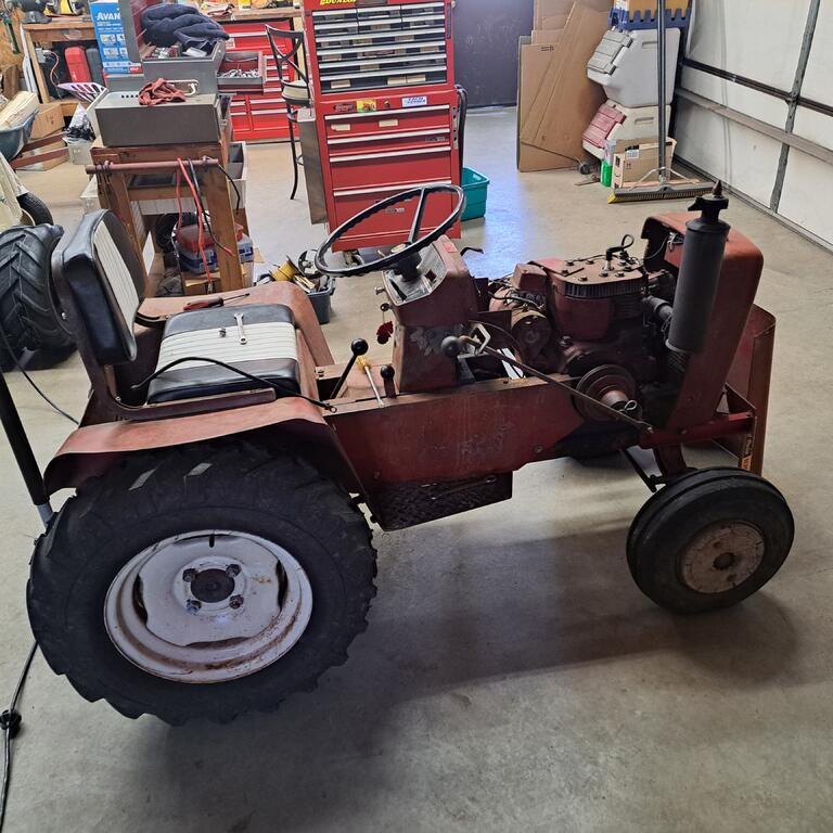

And i put one on the 312, when that knock becomes a window i can easily transfer the exhaust to the C-100...and do a new exhaust for whatever I repower with.
