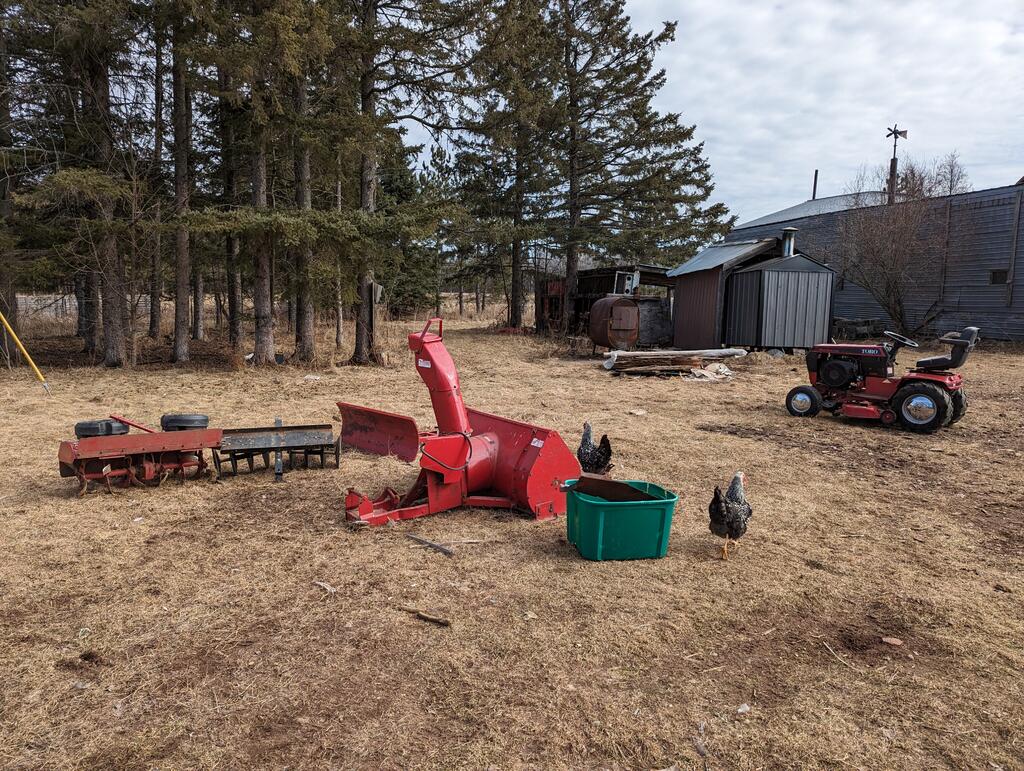

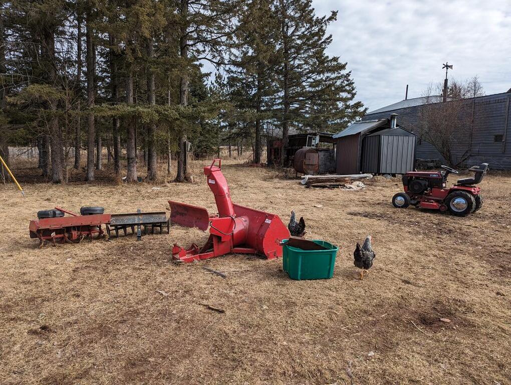

Josie 11 #1 Posted February 29, 2024 Hello I just bought a 1990 wheelhorse 520h. 370 hrs, and came with snow pusher, snowblower, mower deck, tiller and disc, all in amazing like new shape. Alao came with chains, weights, and all the manuals. I bought it because I don't want to drive all over the state looking for attachments. I paid 1800 for it. I hope that's a fair price. Anyway I've read that the onan engine is junk. Is that true? Are these reliable little machines? Is the year a bad or good year? it started right up and drove around easy enough. So I'm hoping I can get a couple gardening seasons out of it before any repairs. I do have wonderful mechanic neighbors if something does go wrong. What kind of maintenance should I do on it right away? Change fluids? What else? Also, I found a kwik way loader for it for 1500. I'd love to get it but since id need it delivered someone else may beat me to it. Is this worth bending over backwards to get? I could see if my husbands uncle could help... Thanks in advance for any advice or info on my new machine. 3 7 Share this post Link to post Share on other sites
