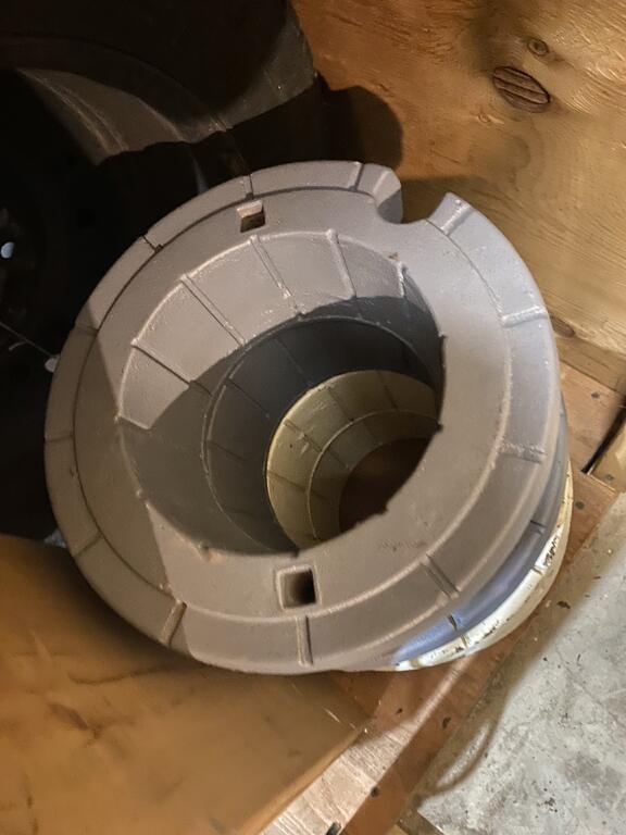

Ian928 47 #1 Posted February 27, 2024 Hello, Can anyone ID these wheel weights? We own a 1054 and a D-200, do they fit any of these tractors? 4 1 Share this post Link to post Share on other sites
WHX?? 54,546 #2 Posted February 27, 2024 Those are orginal wheel horse. They'll fit a 1054 fer sure. Don't know if they'll fit a D. You got a 3- 400 dollar set of weights there. 1 Share this post Link to post Share on other sites
pfrederi 19,796 #3 Posted February 27, 2024 The rear weights will for sure fit a D200 1 Share this post Link to post Share on other sites

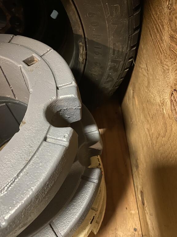

rjg854 12,834 #4 Posted February 27, 2024 (edited) I thought D series had to have a notch for the valve stem. I swapped a set like the ones pictured for a set that had the notch, and was told they came off a D series. @Sparky Edited February 27, 2024 by rjg854 Add 1 Share this post Link to post Share on other sites
Sparky-(Admin) 24,544 #5 Posted February 27, 2024 I don’t think those rears will fit the 15” 1054 wheels. I’m not 100% sure the fronts will work on the narrow front wheels of a 1054 either. @rjg854 is correct, the D series rear wheel valve stem is on the outside of the wheel so the weight needs to have the notch that you see in these pics. 4 1 Share this post Link to post Share on other sites
Pullstart 68,781 #6 Posted February 27, 2024 And D series runs a 12” rear wheel, bs the 1054 running a 15” 3 Share this post Link to post Share on other sites

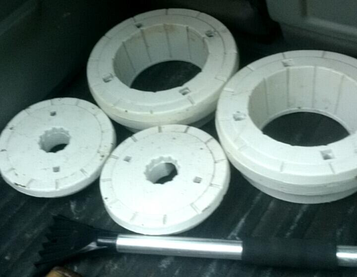

pfrederi 19,796 #12 Posted February 28, 2024 Running the standard Plastic cement filled weight on my D200 the ones here should fit also. Share this post Link to post Share on other sites

Ian928 47 #14 Posted February 28, 2024 Thank you all! I am still not sure if it fit our 1054, or D200, some conflicting Feedback here! Yes I am in Norway, and the weights are not mine (yet), they are advertised for sale, and I am reluctant to buy them in case I can not use them! Are there any markings I can ask the seller to check to see if I can get some clarity? Share this post Link to post Share on other sites
Sparky-(Admin) 24,544 #15 Posted February 28, 2024 6 hours ago, Ian928 said: Are there any markings I can ask the seller to check to see if I can get some clarity? Verify that the mounting holes in the weights match up with the holes in the wheels on your tractors. As mentioned earlier, watch out for the valve stem location as well. Share this post Link to post Share on other sites
gwest_ca-(File Mod) 11,981 #16 Posted February 28, 2024 Click on the pictures to see more models 1 1 Share this post Link to post Share on other sites
Pullstart 68,781 #17 Posted February 28, 2024 8 hours ago, Ian928 said: Thank you all! I am still not sure if it fit our 1054, or D200, some conflicting Feedback here! Yes I am in Norway, and the weights are not mine (yet), they are advertised for sale, and I am reluctant to buy them in case I can not use them! Are there any markings I can ask the seller to check to see if I can get some clarity? If you could get a measurement of the big weights the part that fits inside the wheel would be either around 11 or so inches (28 cm) or 14 inches (35.5 cm). That would verify they fit the D200 (12” wheels) or 1054 (15” wheels) Share this post Link to post Share on other sites

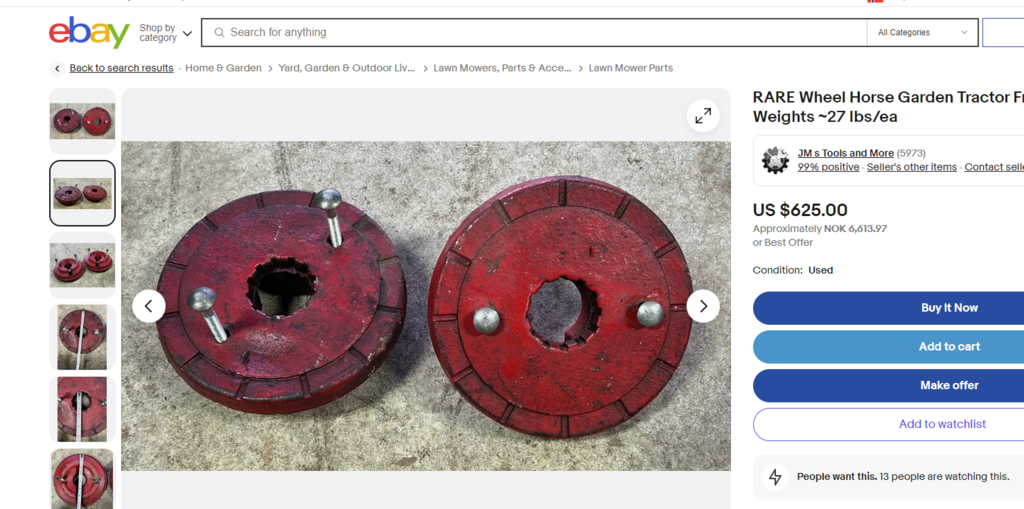

Ian928 47 #19 Posted February 29, 2024 Thank you all, based on your input I took the chance and bought the wheel weights for 2000NOK / $190, seems like a fair price based on what has been said in this thread and a quick search on Ebay (see snip below, $625 for only the front ones!) My cousin will go pick them up and bring them to me next time he visits, so it will be some time before I will find out if they fit. I promise to take pictures and report back! 3 2 Share this post Link to post Share on other sites
Ian928 47 #20 Posted February 29, 2024 The seller say the weights are for 8" and 12" wheels. From googling I think the front weights will fit both tractors. I think the rears can be used on both tractors also, by grinding the necessary slot for the valve on the D200 rear wheel, or by mounting the wheel weight the wrong way on the 1054 as i found a picture of here on the forum by user Herder on this forum! I hope its ok that I borrow his picture. Share this post Link to post Share on other sites
WHX?? 54,546 #21 Posted March 1, 2024 14 hours ago, Ian928 said: 2000NOK / $190, Funny you should say that @Ian928. Just for grins I looked up your currency rate when you first posted ... yah you got a steal! Those would have went for over 5000NOK here. They should fit any 12 or 8 inch wheel. I'd like to say if you don't have a tractor they will fit go get one. But then I realized how scarce they might be in your neck of the woods. Share this post Link to post Share on other sites
kpinnc 17,025 #22 Posted March 1, 2024 14 hours ago, Ian928 said: $190 You did great! Sometimes "rare" works in your favor! Share this post Link to post Share on other sites

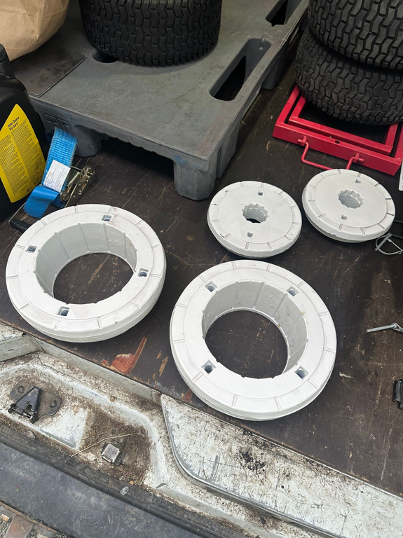

DBlackston 323 #24 Posted December 12, 2025 So are the D-series and non D- series weights exactly the same minus the notch or are there other differences in design or weight? Seems the D-series weights would mount to any 12" wheel horse wheel but not vice versa. Just looking at the pictures in this thread the D-series has 2 mounting holes and the others have 4. That seems counterintuitive but I wonder what else is different. Share this post Link to post Share on other sites
squonk 45,379 #25 Posted December 12, 2025 (edited) 9 hours ago, DBlackston said: So are the D-series and non D- series weights exactly the same minus the notch or are there other differences in design or weight? Seems the D-series weights would mount to any 12" wheel horse wheel but not vice versa. Just looking at the pictures in this thread the D-series has 2 mounting holes and the others have 4. That seems counterintuitive but I wonder what else is different. Just the notch as D wheels have the stem on the outside. No real other difference. only need 2 bolts to mount them. I really would like to know what foundry actually made them. They were factory weights on some years of Cub Cadet and AMF Edited December 12, 2025 by squonk 1 Share this post Link to post Share on other sites
