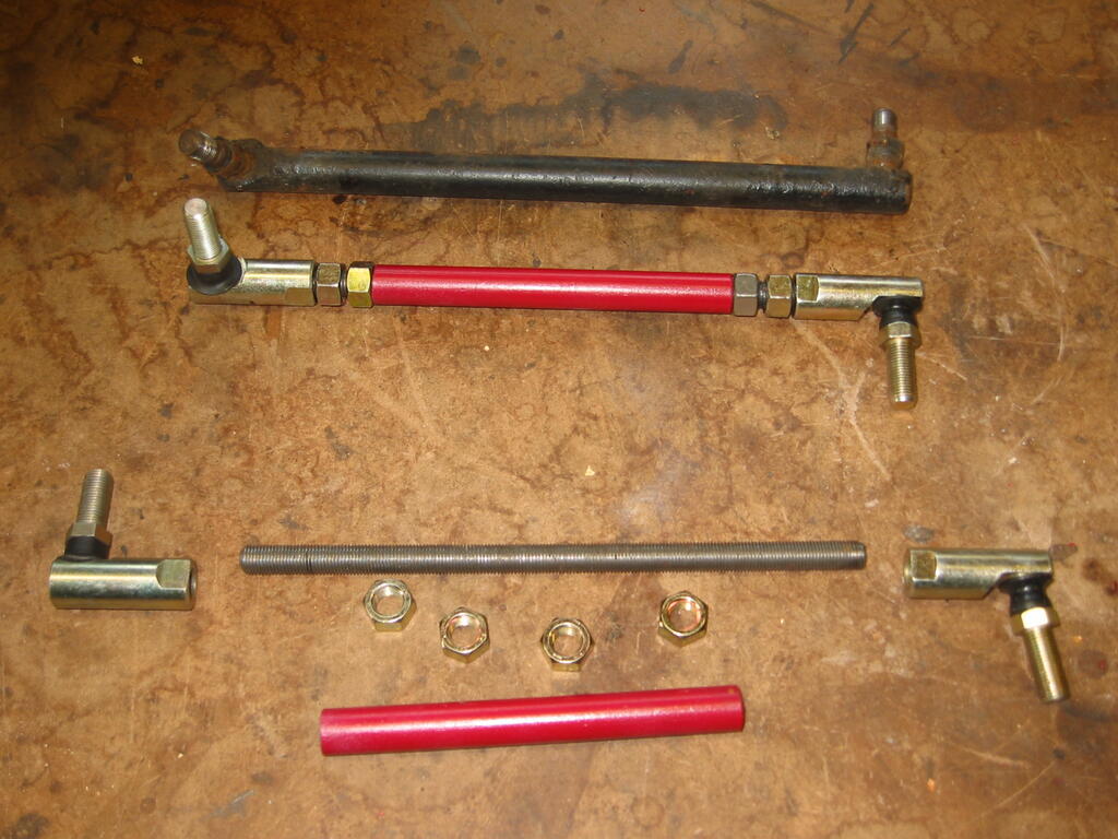

ri702bill 11,627 #4 Posted February 25, 2024 (edited) I do have access to a lathe, and have made 2 sets using replacement AYP RH female heim joints. Split sizes - 7/16-20 tor the female end, the stud is 3/8-24. One set was made from galvanized 1/2" round stock, the other from 5/8" steel hexstock. I prefer the later - visable at the bottom of the picture. You WILL to chase the plating out of the female ends..... Edited February 25, 2024 by ri702bill 1 Share this post Link to post Share on other sites

Lee1977 7,631 #10 Posted February 25, 2024 Here are the ones with the 1/2" rod. I got 1/2" to 3/8" steel bushings from Lowes and cut them down, had to put the on a bolt in the drill press and file the 1/2" down to get them in the heims joints. Just used 3/8" bolts at all ends. had to run the die on them to get them to tighten on the heims joins. 4 Share this post Link to post Share on other sites
