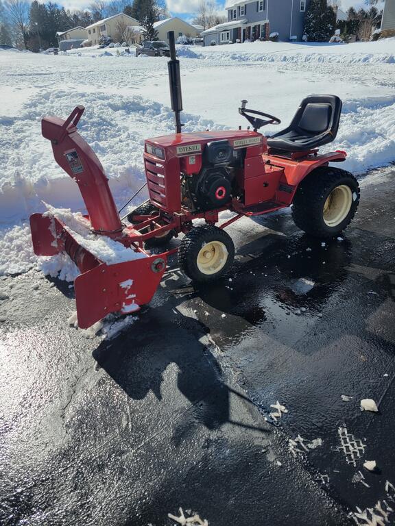

Nitrohorse 6 #1 Posted February 17, 2024 I purchased a used 42" tall chute snowblower yesterday and woke up to 12" of wet snow this morning. The blower seem to clog very easily, in fact, I was very disappointed in it's performance. The gentleman I purchased the blower from included a green "kevlar" belt which was too small to route over and under the tensioner as normal. I had to run the belt direct, which I may believe caused some of the issue. Do any of you know the belt type and size for the blower belt? I have a Tractor Supply a stones throw from my house. Also, any tips or trick to keep the snow from clogging in the chute? Thank you from a newbie.... Share this post Link to post Share on other sites

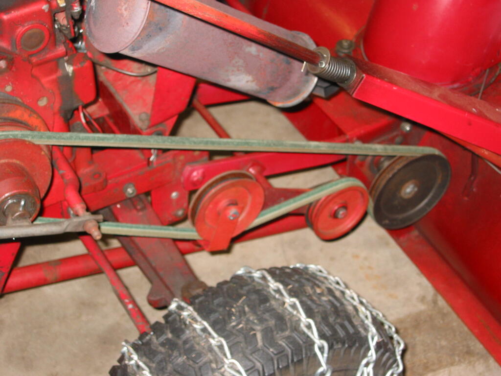

Nitrohorse 6 #10 Posted February 18, 2024 Thanks to everyone who responded. I have a C-160 which has a 10hp diesel on it. The original Kohler was junk and I replaced it with the cheapest option. I think the belt that came with the blower is shot and possibly too short. It also came with a WH replacement belt that has seen it's better days too. I cannot route the belt the proper way as I will never be able to get it over the pto pulley. Something isn't right. I also noticed that the previous owner never adjusted the skids to touch the macadam. The blower rides solely on the wear bar. I will adjust them today and I will buy another belt. Also, yesterday the chute clogged so back that it stalled the auger and the clutch started smoking. Are these clutch plates done once they smoke or do I still have some life in it? Again, thanks to everyone who is helping this newbie get things sorted out. Share this post Link to post Share on other sites
pfrederi 20,341 #11 Posted February 18, 2024 (edited) I have made them smoke once or twice still worked may have to tighten the trunion turn or two. Make sure you are in the outer (smaller) sheave on the PTO Edited February 18, 2024 by pfrederi 1 Share this post Link to post Share on other sites
ebinmaine 78,401 #12 Posted February 18, 2024 1 hour ago, Nitrohorse said: 10hp diesel What's the PTO pulley size and RPM of the diesel? Share this post Link to post Share on other sites
wallfish 19,767 #13 Posted February 18, 2024 51 minutes ago, Nitrohorse said: Thanks to everyone who responded. I have a C-160 which has a 10hp diesel on it. The original Kohler was junk and I replaced it with the cheapest option. I think the belt that came with the blower is shot and possibly too short. It also came with a WH replacement belt that has seen it's better days too. I cannot route the belt the proper way as I will never be able to get it over the pto pulley. Something isn't right. I also noticed that the previous owner never adjusted the skids to touch the macadam. The blower rides solely on the wear bar. I will adjust them today and I will buy another belt. Also, yesterday the chute clogged so back that it stalled the auger and the clutch started smoking. Are these clutch plates done once they smoke or do I still have some life in it? Again, thanks to everyone who is helping this newbie get things sorted out. 10 hp diesel should have plenty of torque for throwing snowing snow. Mine always ride on the scrape bar because I want the asphalt cleared off as much as possible. Leftover snow will melt during the day and leave ice patches from freezing overnight if there's too much leftover so the more that's shot off the better. Of coarse everyone's situation is different so use what works best for you. Slipping the PTO can overheat the clutch material and slipping can glaze it too so it could end up with a much smoother surface than you want it to have. Friction is what grabs the bell to spin the pulleys so a good surface on the clutch material and the flat of the bell also helps with performance of the blower. I use a belt sander for the flat steel of the bell and a sanding block on the clutch material. If you remove the bell off of the shaft which is fairly easy to do, you can typically see just how much of the intended contact area is making contact between it and the clutch material. The less contact area equals the less friction between those pieces. They don't necessarily need to have a 100% contact area connection but only 10% will allow it to slip under loads and overheat. Just kinda throwing this out there since you don't have much time with that tractor or know what the previous did or didn't do. One way to check if the PTO is slipping too much is to touch it after using it like on a blower or deck. If it's too hot to touch then it's been slipping 2 Share this post Link to post Share on other sites

Nitrohorse 6 #15 Posted March 2, 2024 I bought a new belt and have used anti stick spray on the blower housing. My last "stupid" question is which way should the auger rotate? I would think the auger would rotate CW as to scoop the snow upwards and discharge up and out the chute. But if I'm understanding the belt routing and engine rotation correctly, the auger rotates CCW, just as the PTO does on the engine. This rotation would be counter productive as it would have a tendency to throw the snow forward out the front of the deck, wouldn't it? Obviously I'm missing something. 1 Share this post Link to post Share on other sites
wallfish 19,767 #16 Posted March 2, 2024 35 minutes ago, Nitrohorse said: I bought a new belt and have used anti stick spray on the blower housing. My last "stupid" question is which way should the auger rotate? I would think the auger would rotate CW as to scoop the snow upwards and discharge up and out the chute. But if I'm understanding the belt routing and engine rotation correctly, the auger rotates CCW, just as the PTO does on the engine. This rotation would be counter productive as it would have a tendency to throw the snow forward out the front of the deck, wouldn't it? Obviously I'm missing something. You're missing how the chain is routed to the auger which changes the direction. 1 Share this post Link to post Share on other sites
Nitrohorse 6 #17 Posted March 3, 2024 On 3/1/2024 at 8:01 PM, wallfish said: You're missing how the chain is routed to the auger which changes the direction. I forgot the chain, thanks for the response! 2 Share this post Link to post Share on other sites
