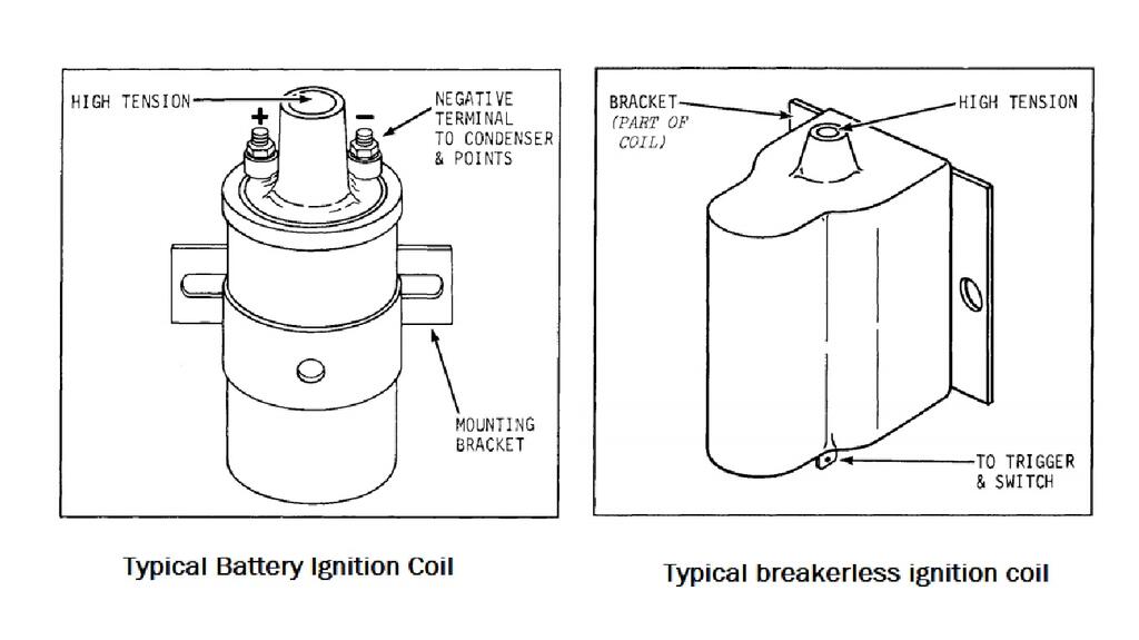

michaeldhowell 6 #1 Posted February 16, 2024 How much spark/fire should I see when checking? Gt14 Kolher. Will start once but after shutting off it really struggles to start. Thanks Share this post Link to post Share on other sites
WHX?? 55,699 #2 Posted February 16, 2024 I've had most of mine jump a good 1/8 " gap with a nice blue spark. Plug gap is only .025.. try the easy things first. New plug maybe. Also coils have been known to quit throwing spark once they get hot but fine when coid. Check points & condenser. What make you think it's an electrical problem? Fuel issues possibly? Share this post Link to post Share on other sites
953 nut 64,642 #3 Posted February 17, 2024 3 hours ago, michaeldhowell said: How much spark/fire should I see when checking? Gt14 Kolher. Will start once but after shutting off it really struggles to start. Thanks Your engine probably has a triggerless ignition system, seer the drawing below. If it is the breakerless type DO NOT apply any power to the coil. I would replace the spark plug before doing anything else. The engine needs spark but it also needs fuel and air to run. If you have about the same amount of spark before it starts and when you attempt a restart it may be a fuel/air problem. Share this post Link to post Share on other sites
michaeldhowell 6 #4 Posted February 17, 2024 12 hours ago, WHX?? said: I've had most of mine jump a good 1/8 " gap with a nice blue spark. Plug gap is only .025.. try the easy things first. New plug maybe. Also coils have been known to quit throwing spark once they get hot but fine when coid. Check points & condenser. What make you think it's an electrical problem? Fuel issues possibly? My fire is blueish and visible, I will get a new plug and continue with checking the fuel system. I just bought the unit yesterday I fifed it with starting fluid once but would start again. Also what’s the best place to get Koehler parts? Thanks for the help! Share this post Link to post Share on other sites
michaeldhowell 6 #5 Posted February 17, 2024 9 hours ago, 953 nut said: Your engine probably has a triggerless ignition system, seer the drawing below. If it is the breakerless type DO NOT apply any power to the coil. I would replace the spark plug before doing anything else. The engine needs spark but it also needs fuel and air to run. If you have about the same amount of spark before it starts and when you attempt a restart it may be a fuel/air problem. I do have the breakerless ignition coil type, it does seem like my spark is fairly stable, I got it to start with starting fluid a couple times but not every time. Does the speed that the engine turns over play in to this? Sorry for the mass of questions new to this! Thanks 1 Share this post Link to post Share on other sites
