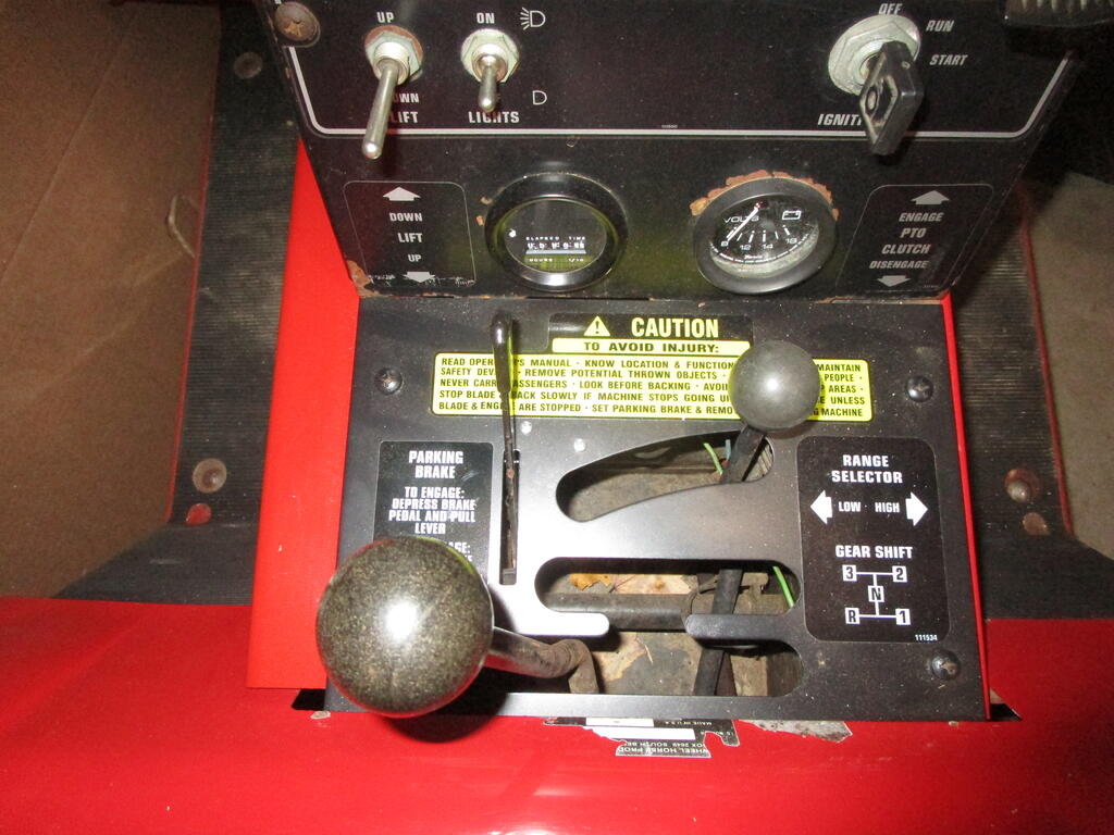

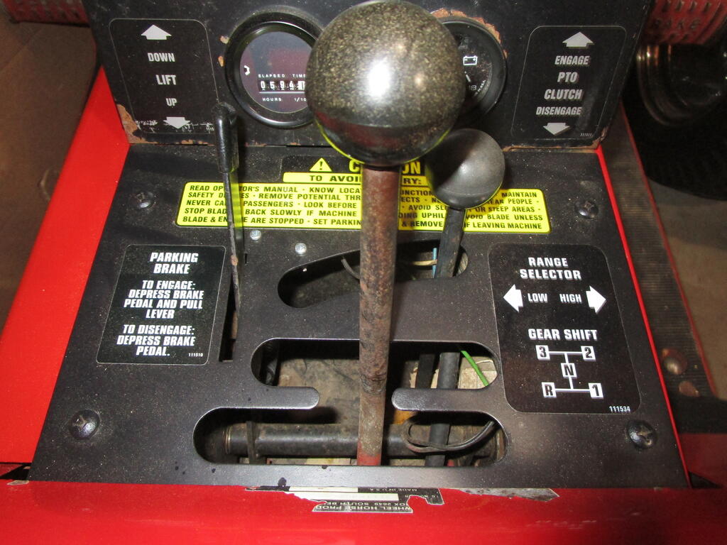

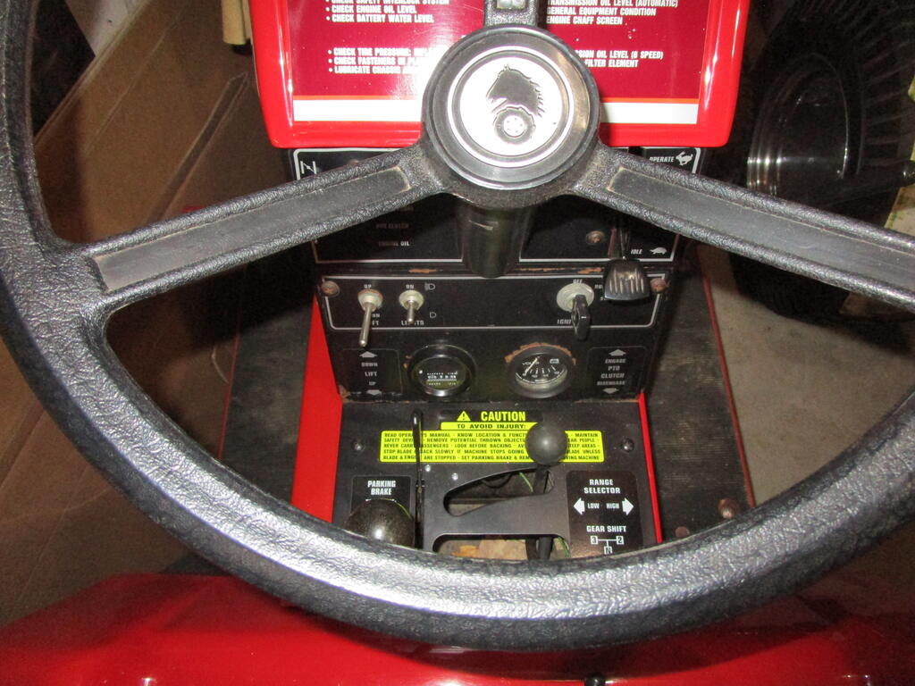

JCM 10,763 #4 Posted February 11, 2024 (edited) Here you go Don. 1986 417-8 best I can do. When I did the 420-LSE console over last Summer I also did the shift console only on the 417 -8 and the 418-A while I was at it. If you ever get a chance to attend the M & G bring up your 420 and I can do a custom botched up hole on your console like my 420 had when I bought it. Take Care Buddy. PS This tractor was bought from one of my customers who bought it brand new. I made a diagram of the measurements to put the new ones back on as built. Edited February 11, 2024 by JCM 2 Share this post Link to post Share on other sites

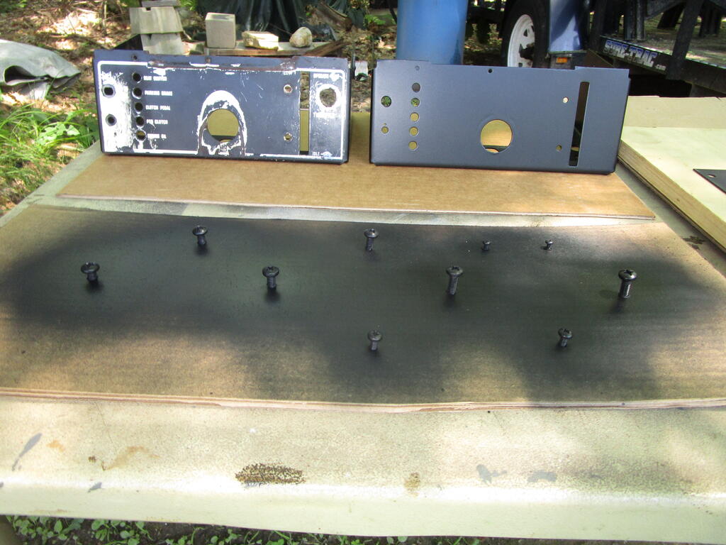

JCM 10,763 #6 Posted February 14, 2024 I don't think we will need a hole saw @c-series don if you look close on the upper steering console in the picture the hole doesn't appear to be round on the 420 ? Custom hole Share this post Link to post Share on other sites
c-series don 11,364 #7 Posted February 15, 2024 @JCM wow! Looks like even that hole is a Limited Special Edition! Thank God. 1 Share this post Link to post Share on other sites
