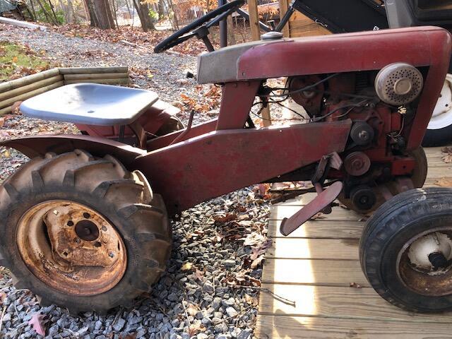

Sailman 1,307 #1 Posted February 6, 2024 Been in contact with a small engine shop near me to consider his help in getting the K-161 on my 701 running. It appears to have a broken rod as piston does not move when rotating the drive pulley. Trying to gauge if this guy is capable for some of the repair (been in business a long time) and in discussing a possible over sized piston (if the measurements require that) he states you have to have .15 over rings to correctly seal a .10 over piston. Have not heard this before. What say you experienced engine re-builders out there? He also said you do not turn down a crank shaft on the K series. It is much harder (cast iron) than the aluminum rod and should not need to be ground down and have undersized rod. Any wear should be on the rod connection. Again...what say you re-builders out there? Trying to get an assessment of whether he is a good option to do some of the internals as needed. He has worked on them years ago. 1 Share this post Link to post Share on other sites
