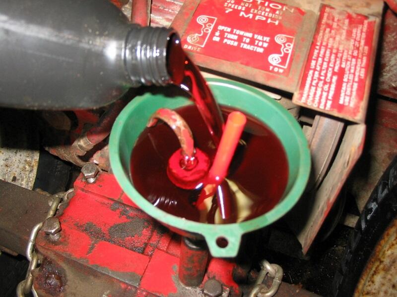

daveoman1966 3,884 #8 Posted February 6, 2024 (edited) Here is a very easy and non-messy solution to filling the gearbox....or anything similar. Edited February 6, 2024 by daveoman1966 1 6 Share this post Link to post Share on other sites
peter lena 9,936 #9 Posted February 6, 2024 @daveoman1966, YOU CAN,T DO THAT ! just because I said so , out of the box , looks like what I would do , Pete 1 Share this post Link to post Share on other sites
