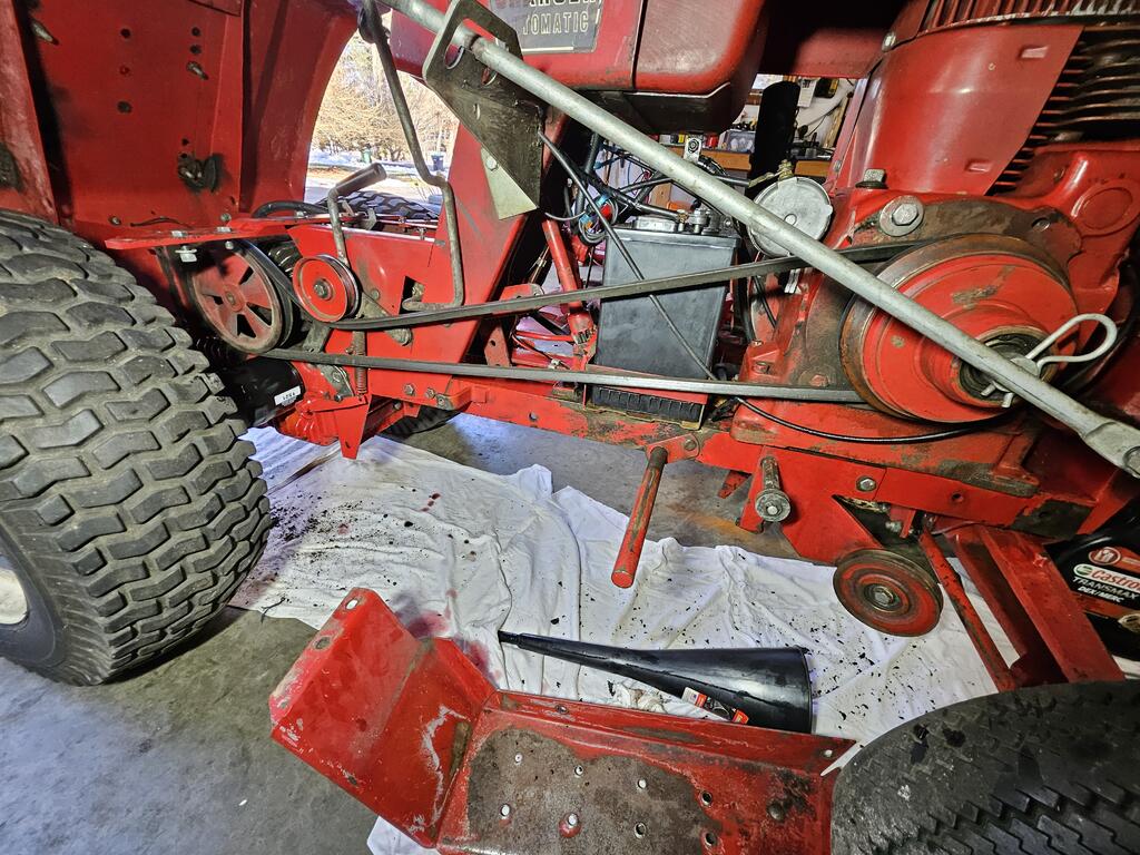

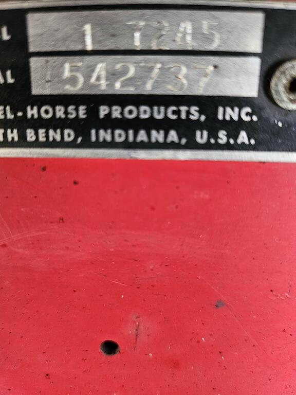

Brooklyn581 33 #1 Posted February 4, 2024 I've got an Electro 12. Model number attached. Had low transmission fluid and I noticed a small slow drip at the drain plug. My guess is it leaked most of the fluid out over a long time sitting. There are no other leaks anywhere that can be seen The machine has been stored inside its whole life and looks like it is in great shape. Motor runs strong. I replaced the transmission filter and filled the fluid to the top of the hash marks on the stick. I've tried the tow lever in both positions. The pully wheels both spin on the engine and the pump. No broken keys. The belt turns and when the parking brake is released you can hear the engine work slightly harder as you would expect when engaging the hydrostatic drive. Everything is clean and moving freely in the center console and adjuster. The lifting piston moves up and down no problem. When I push forward or reverse I get extremely weak movement with no resistance. If I sit on the machine nothing. No whining motor, no movement. Nothing. So close to ha ing a fully functional Tractor but she won't move an inch. Hoping someone has the cure and answer here. Any and all feedback is welcome! Share this post Link to post Share on other sites

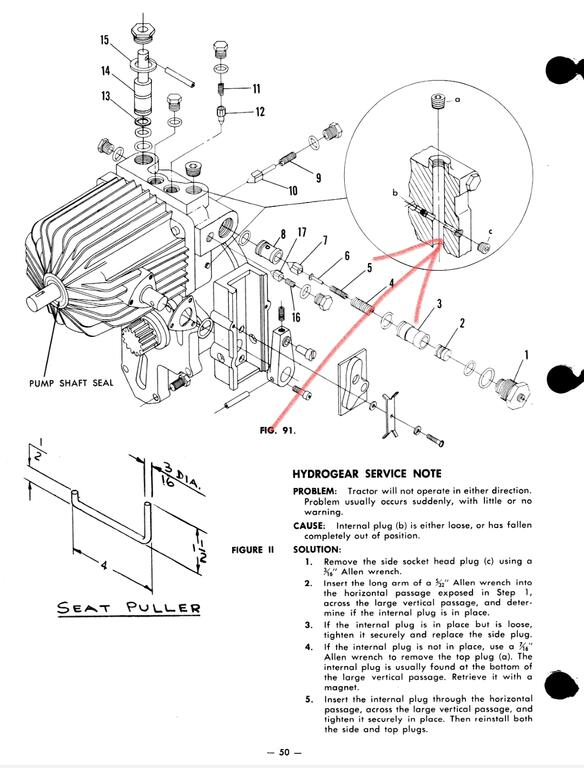

pfrederi 21,345 #2 Posted February 4, 2024 (edited) Can you push the tractor with the tow valve in drive position. If I read your post the hydro lift is working??? Edit ::also could be an internal plug has slipped see page 50 of hydrogear section in sunstand manual,. Edited February 4, 2024 by pfrederi 1 Share this post Link to post Share on other sites
pfrederi 21,345 #3 Posted February 4, 2024 The manual if you do not have it download here see diagnostics 1 1 Share this post Link to post Share on other sites

pfrederi 21,345 #5 Posted February 4, 2024 Do we know when last time was she worked. maybe parked due to sudden failure??? I am afraid it sounds like a key on the counter shaft or the internal plug. Both these failures are pretty sudden not result of sitting... 1 Share this post Link to post Share on other sites

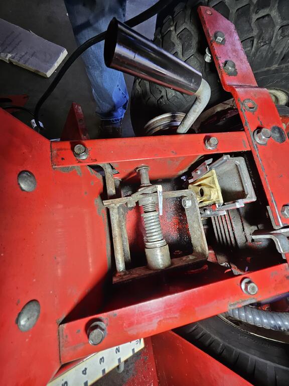

Brooklyn581 33 #6 Posted February 4, 2024 I found the plug in the reservoir just like in the book! Secured everything back together and took right off like hitting a light switch. Thanks for the support Red Square & Pfrederi! 4 Share this post Link to post Share on other sites
