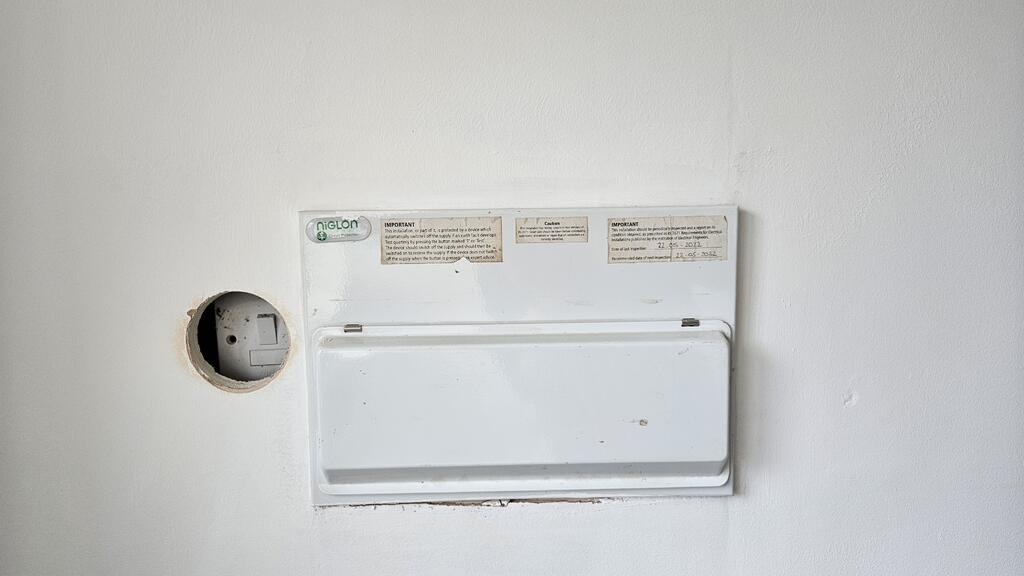

Mickwhitt 5,259 #1 Posted February 3, 2024 OK, the title says it all.... we've all been there, either we had someone in to do a job of work or we did it ourselves, and the results were decidedly suboptimal shall we say. I will put my hand up to a few tiny miscalculations and lift the lid on a few "Professional" cock ups I've witnessed over the years. What prompted me to start this thread? Well, today I was asked by a friend to fit a kitchen base unit and sink in her newly built utility room. I trundled along to see how things were and plan what I might need for the job. The building company who did all the work had fitted a fuse board to the wall with circuit breakers for all the house. It wasn't where I would have put it, but that's not the issue. Whilst chatting to my friend it transpired that the outdoor courtesy light had stopped working, curiously since the utility room had been plaster boarded and plastered. The breaker was on but no power to the switch. I rang and spoke to the electrician who had done the wiring. "There is an isolator switch, it will be that" he confidently declared. Nope, I don't see an isolator said I. "Yes, it's right there, at the side of the fuse board, I remember fitting it myself." Nope, not there, you must be thinking of another house quoth I. " Definitely at the left hand side of the fuse board, inches away" At this point I abandoned the conversation with the ape like sparky and took a decent sized hole saw to the dry wall, where the aforementioned dimwit swore the switch had been placed. And there it was, buried under the newly plastered wall, turned off. To cap it all, the switch was actually a 30 amp double pole fused appliance plate so completely unsuitable for the light circuit AND it was only 10 inches away from the MCB fuse so totally unnecessary. I removed it and made permanent connections so that the wall can be replastered. I will reveal some of my jobs that ended up on the cutting room floor, but which sometimes get screened like an episode of "it'll be alright on the night" when Mrs W cares to remind me of my bloopers. I'm sure others will have the courage to admit their mistakes and share them with the group, purely in the interests of personal advancement. We will be laughing with you, not at you....Honest. Mick.. 3 2 1 1 Share this post Link to post Share on other sites

Mickwhitt 5,259 #7 Posted February 4, 2024 Part 2 of the utility room installation. I plumbed innthe new sink unit, all looked great....cold water check, hot water....you gotta be kidding me! Not connected up or isolated somewhere. The boys who did this work must have turned up on horseback as they were true cowboys. 1 Share this post Link to post Share on other sites

Mickwhitt 5,259 #10 Posted February 10, 2024 On 2/4/2024 at 6:20 PM, Mickwhitt said: Part 2 of the utility room installation. I plumbed innthe new sink unit, all looked great....cold water check, hot water....you gotta be kidding me! Not connected up or isolated somewhere. The boys who did this work must have turned up on horseback as they were true cowboys. Had a look in the roof space yesterday, it's a bungalow by the way. The boiler is fitted in a broom cupboard and the hot water feed was split between an underfloor pipe to the bathroom and an in the roof pipe to the kitchen. The kitchen pipe feed was connected to the boiler output with an elbow joint. Less than a foot away was a loose length of plastic pipe. Blowing down it forced water out of the utility hot tap, so we have the other end of our pipe, just not connected to anything. I put a tee piece in the feed pipe and hey presto! A functional hot water feed, now why didn't the contractor do that? Two minutes of a job and he just couldn't be bothered. English tradesmen must be among the worst on the planet, lazy and sloppy. 1 Share this post Link to post Share on other sites
