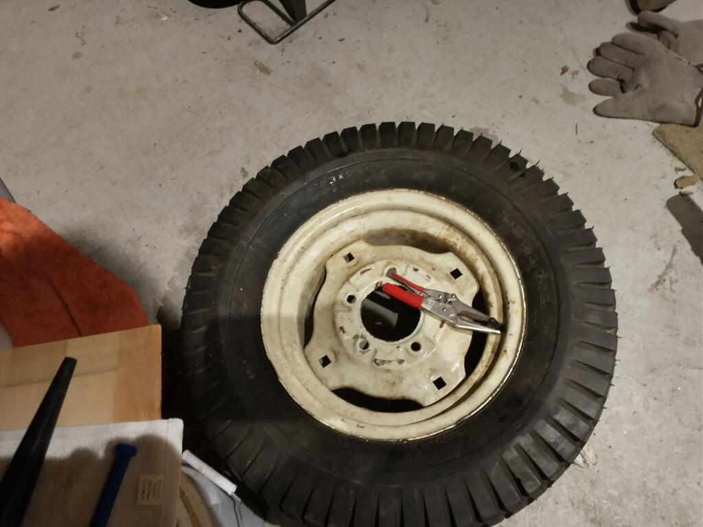

Pullstart 69,414 #83 Posted February 23, 2024 EB. We still fighting this tire, eh? Try about 5psi in it and repeat all steps taken thus far. It’ll eliminate the spongy sidewall issue. 1 1 Share this post Link to post Share on other sites
Pullstart 69,414 #84 Posted February 23, 2024 (edited) Also. I’ve been hiding under a rock and haven’t given this thread the attention it deserves! Awesome job, once again, you two! Edited February 23, 2024 by Pullstart 1 Share this post Link to post Share on other sites
ebinmaine 77,959 #85 Posted February 23, 2024 6 minutes ago, Pullstart said: Try about 5psi in it and repeat all steps taken thus far. Good info but we tried that too. I have the tire with me today and if I get out of work on time I'm going to head down to the commercial Trucking place and see if they can save it. It won't be a wasted trip either way because I'm going to pick up some more Rimguard Tire fluid while I'm there 1 Share this post Link to post Share on other sites

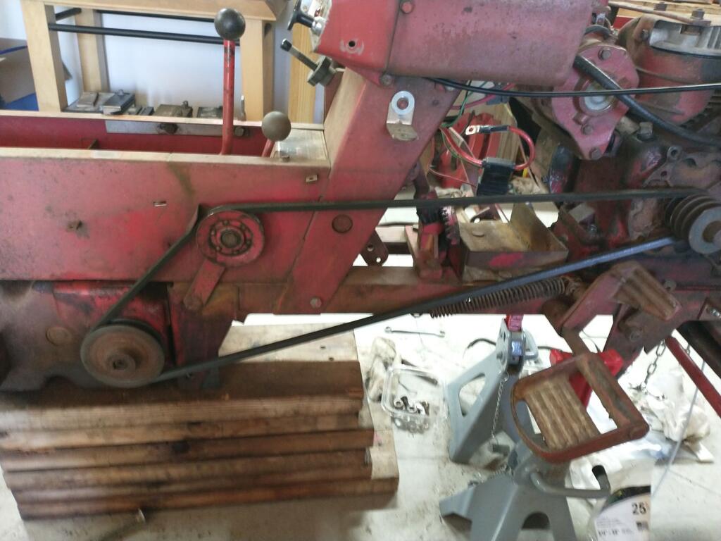

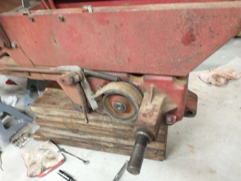

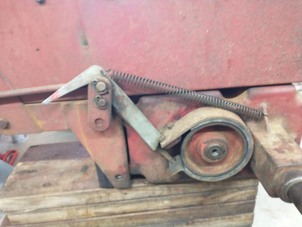

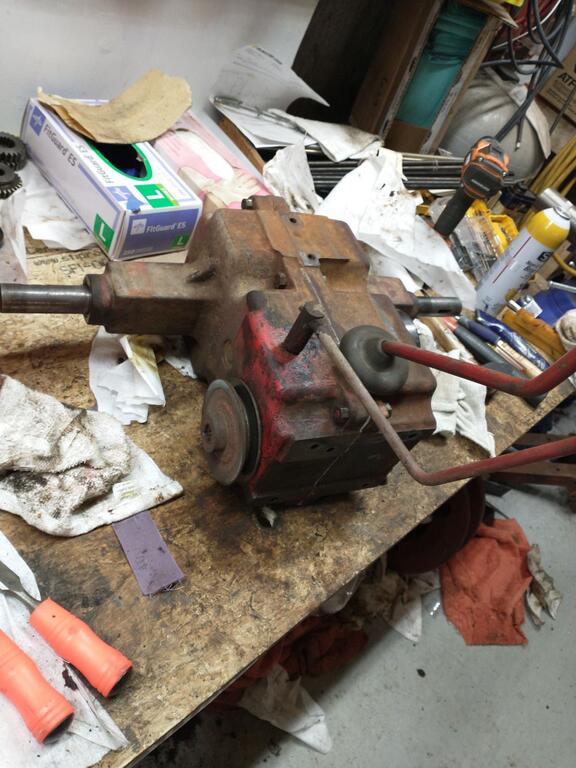

ebinmaine 77,959 #90 Posted February 25, 2024 Today we got the transmission completely reassembled. The 1" brake shaft has been the bane of my existence since the first attempt at removal several days ago. The brake drum fought me tooth and nail to stay on. Today the shaft and drum wouldn't mate without a ton of sanding and cleaning. Then the seal fundamentally refused to be installed because of the lock ring groove. Eventually...... we won...... after wrecking 3 seals. Sonova biscuits!!!!! FYI. Packing tape over the groove is what the final solution was. We tried electrical tape, plumbing tape, scotch tape. All useless. Packing tape is thin enough to let the seal pass and strong enough to keep it outta the groove. But hey whatever. It be done. The other 3 seals flew right in like they knew who was boss. Following seal installation I did more scraping of muck followed by installing the brake drum, input pulley and shifter. I removed a "full dog" point set screw so I ground one of my half dogs to a longer tip. This - by the way - is a whole dog: Trina got the fuel line in place, installed some engine sheet metal, Starter Generator belt, and changed both choke and throttle cables. Together we checked the cylinder head torque and verified at 20 lbs-ft. 1 4 Share this post Link to post Share on other sites

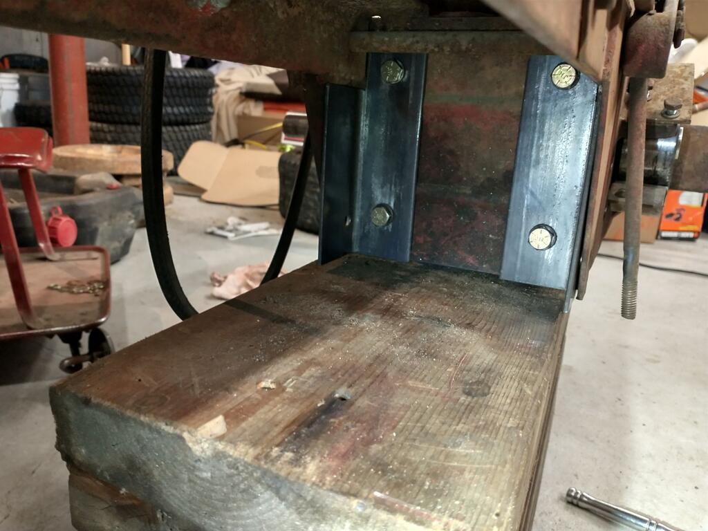

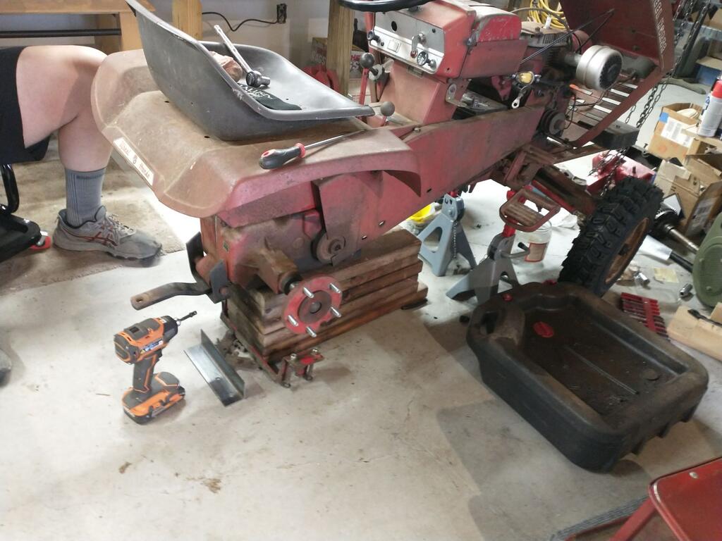

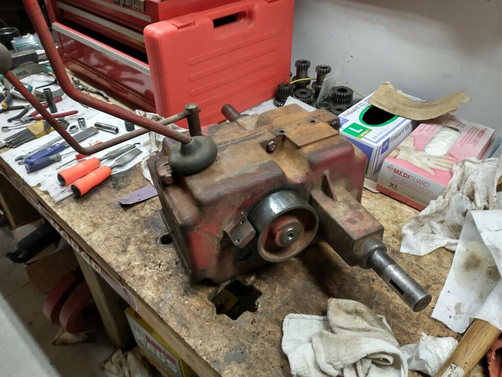

ebinmaine 77,959 #91 Posted March 1, 2024 Transmission is bolted in with the reinforcement brackets. There will be two more bolts on each side for more support. I'll need to drill more holes. 3 Share this post Link to post Share on other sites

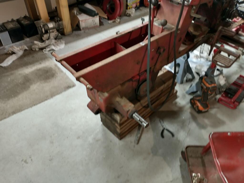

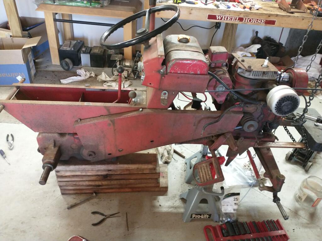

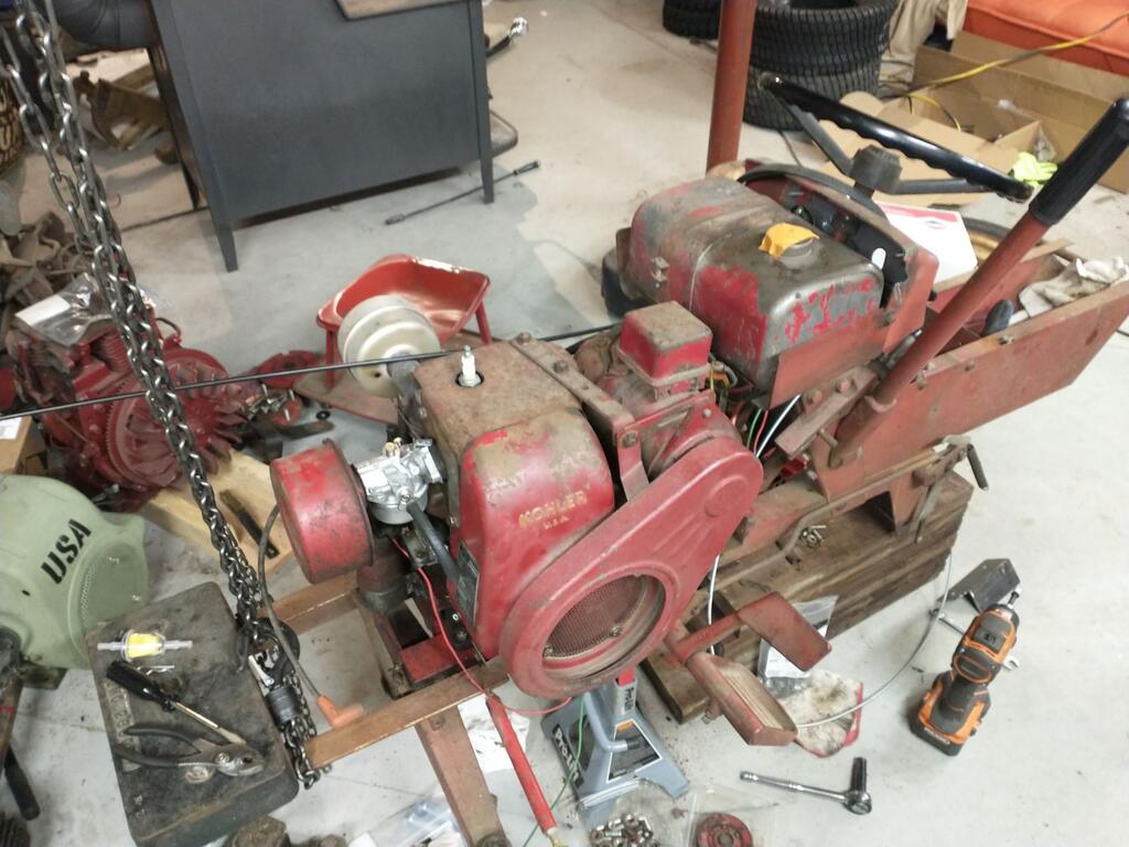

ebinmaine 77,959 #92 Posted March 2, 2024 The Reassembly Department got more work done today. 2 1 Share this post Link to post Share on other sites

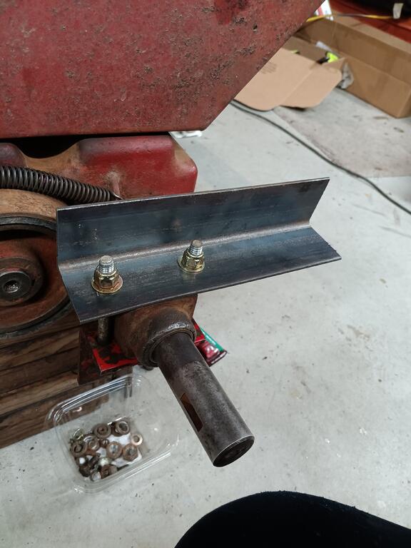

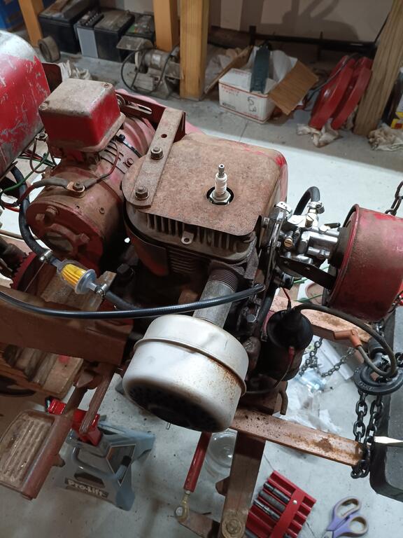

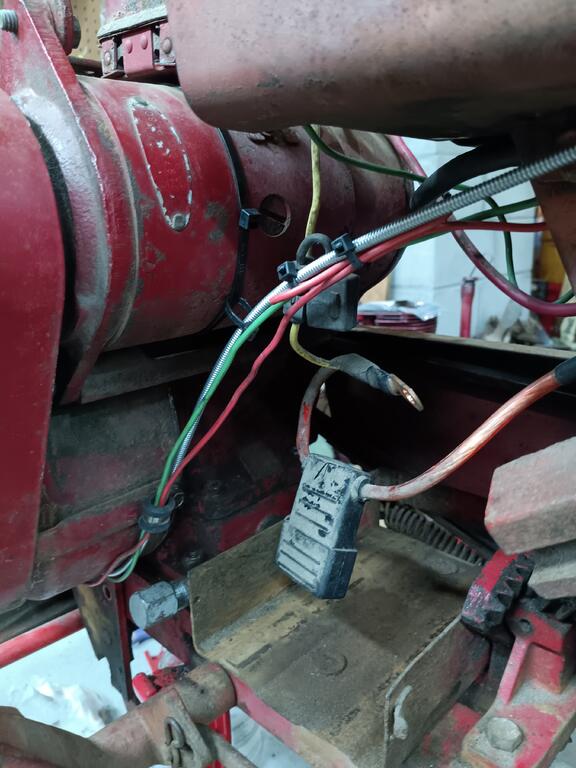

ebinmaine 77,959 #94 Posted March 2, 2024 I used the @squonk method for throttle cable lengthening to get a god reasonably smooth installation. Got the choke cable movement to a decent level also. To install the rear attachomatic hitch I needed to make top brackets. I want to ad a 2" receiver sometime. I figured now's the time to make the top pieces for the future hitch. 5 Share this post Link to post Share on other sites

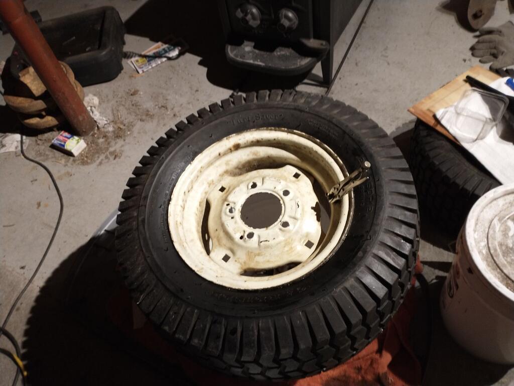

ebinmaine 77,959 #95 Posted March 14, 2024 This.... is a rear tire/wheel combo. This.... is also a rear tire/wheel combo. These....are front tire/wheel combos. All four are now filled with Rimguard. There were some trials and tribulations involved with the pumperizing system. All good. The to-do list is gettin' shorter!! 3 Share this post Link to post Share on other sites

pfrederi 20,092 #97 Posted March 14, 2024 I will have some rim guard left from the retiring of my Farmall M. How are you filling your small tires. Some say for tubeless break the bead on one side and pour in the recommended amnount ...not sure how easy it would be to reseat the bead. How are you pumping it into tubed tires?? Also I think you have indicated you completely fill the tire. Rim guard indicates about 80% fill keeps eh valve stem above the fill line at 12 o'clock. 2 Share this post Link to post Share on other sites
ebinmaine 77,959 #98 Posted March 14, 2024 25 minutes ago, pfrederi said: How are you filling your small tires 26 minutes ago, pfrederi said: How are you pumping it into tubed tires We used a small non submersible pump I purchased at Harbor Freight for about $65. Because of the tiny orifice that the fluid has to pass through going into the tube, this pump was no faster than using a drill mounted pump. We will use it for other things around the yard from time to time so I don't feel like it was a waste of money but it certainly did not speed the process up any like I was hoping. 28 minutes ago, pfrederi said: Also I think you have indicated you completely fill the tire. Rim guard indicates about 80% fill keeps eh valve stem above the fill line at 12 o'clock I would LIKE to attain as close to 100% fill with these tires as I can. I think we are probably no more than 70%, 80%. I've read that having a tire at 100% with a heavier tractor could be dangerous in that, if you go over rough ground the fluid needs to push out somewhere as it's being pushed up on the bottom. I don't see that being a serious issue for us in particular. 1 1 Share this post Link to post Share on other sites

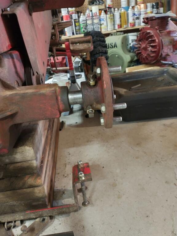

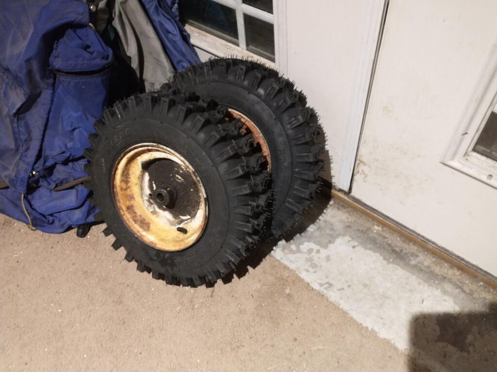

ebinmaine 77,959 #99 Posted March 17, 2024 Today we finished up installing the hubs with new set screws, wheels and tires etc... Pigpen is back up n running!!! 4 Share this post Link to post Share on other sites

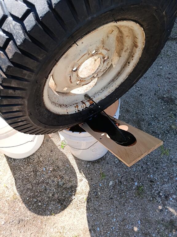

ebinmaine 77,959 #100 Posted August 31, 2025 Turns out that the 8 HP engine does NOT like the added fluid weight we installed. Particularly going uphill. We have a LOT of hill. The replacement clutch spring we put in at some point was also a tad weak. Th combination of the above items caused the belt to prematurely wear out. Rather quickly in fact. So today Trina replaced the belt. I replaced the clutch spring. And the two of us combined drained 4 of the 5 gallons of Rimguard fluid from each rear wheel. That's how much would empty by gravity. She also drained and refilled the engine oil. Pigpen or Piggy is MUCH happier. 5 Share this post Link to post Share on other sites
