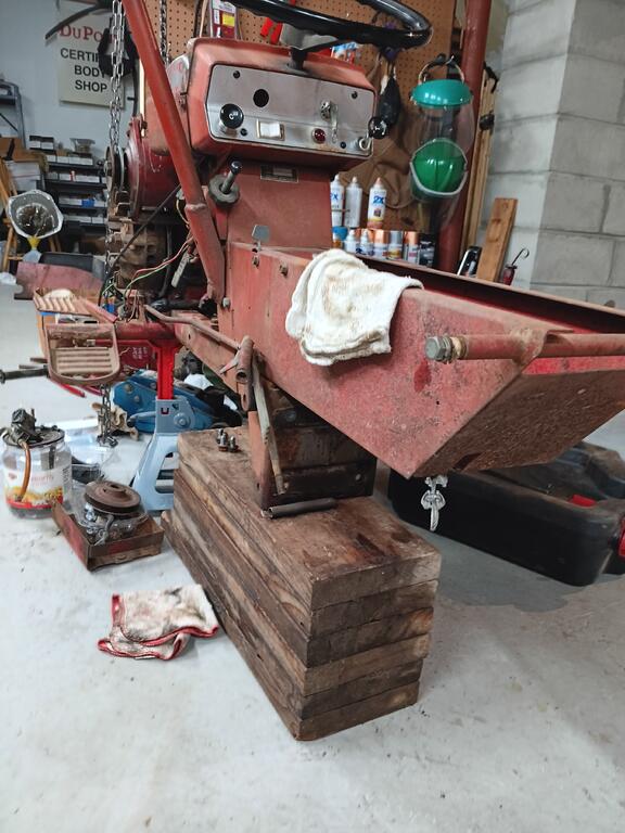

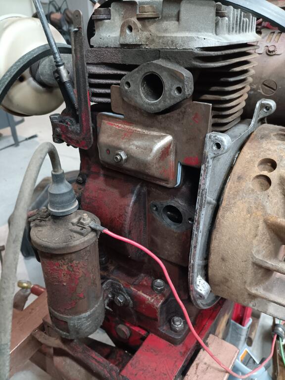

ebinmaine 79,197 #28 Posted February 7, 2024 The Lead Dismantler Technician pulled some stuff and did more degrungerizing. 4 1 Share this post Link to post Share on other sites

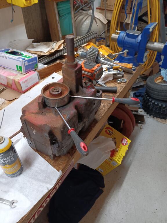

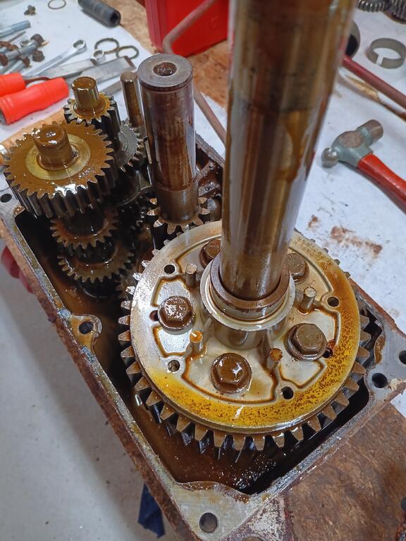

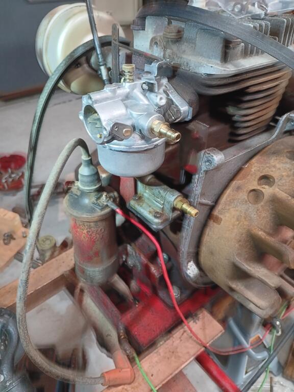

ebinmaine 79,197 #29 Posted February 10, 2024 Trainsuhmashunn is out on the bench. 3 5 Share this post Link to post Share on other sites

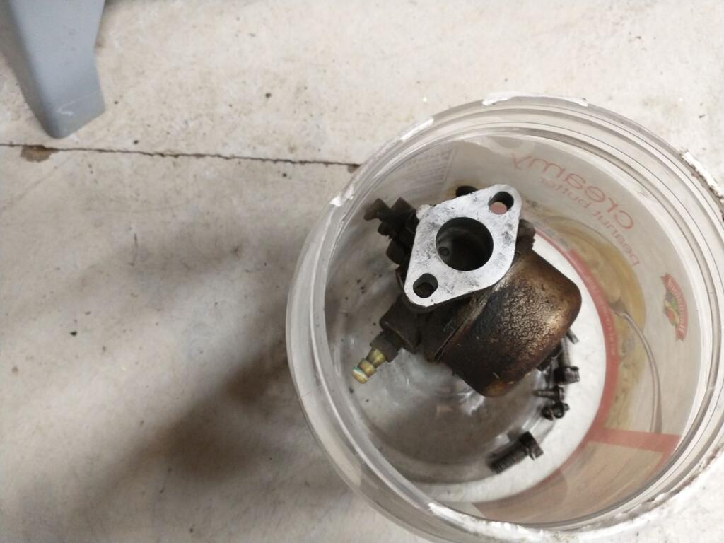

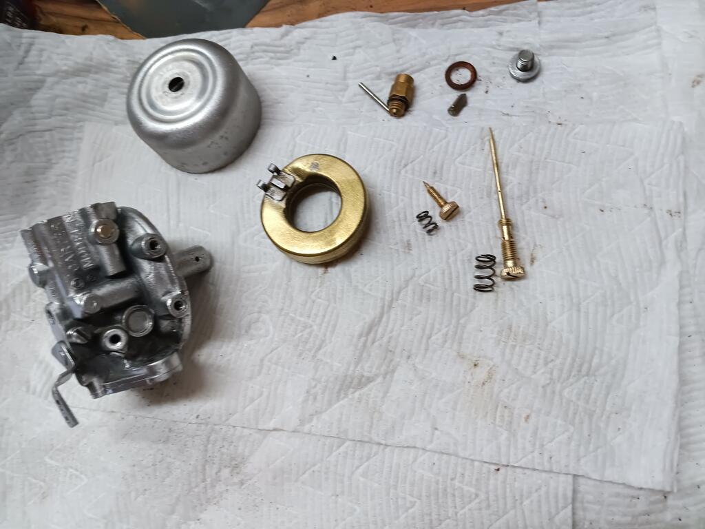

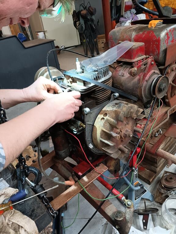

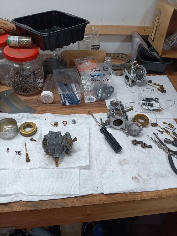

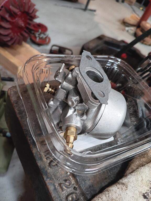

ebinmaine 79,197 #30 Posted February 12, 2024 Earlier today I spent some time messing around with 3 or 4 carbs. Got this one for Trina all cleaned up and assembled. 4 3 Share this post Link to post Share on other sites

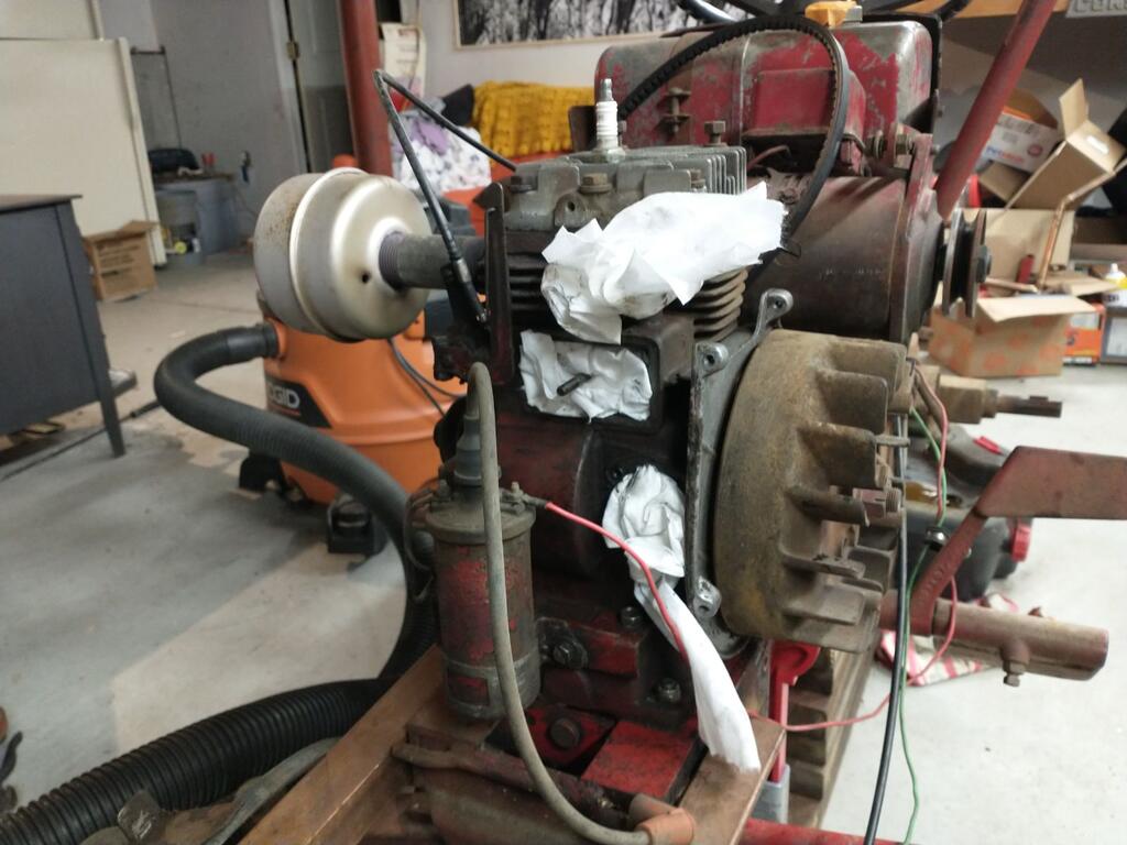

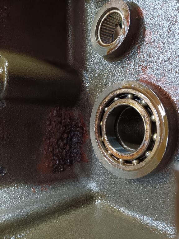

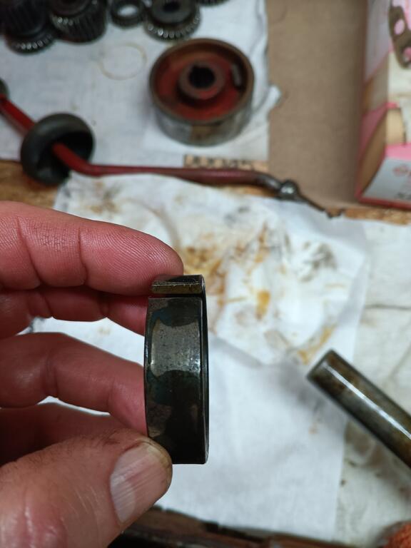

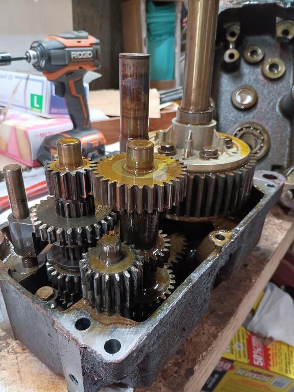

ebinmaine 79,197 #31 Posted February 13, 2024 Me n the BBT got a few minutes to work on the Pigpen this evening. She cleaned up the engine block, breather assembly, and fuel pump. Then reinstalled above parts. Whilst she was doing that I got the transmission cracked open. There's a few rust spots to be gouged out and cleaned up. I disassembled the Limited Slip Differential and changed the spring while checking everything over. Old spring certainly shows some consistent wear. The new one is substantially tighter between the pinions. 5 6 Share this post Link to post Share on other sites
ebinmaine 79,197 #32 Posted February 13, 2024 Trina and I have been pleasantly surprised by how well and easy this one's been coming apart. The transmission rear pin wasn't even a tough get. The case halves cracked right apart like they should have. No fighting me. 2 Share this post Link to post Share on other sites

Handy Don 16,762 #40 Posted February 14, 2024 On 2/12/2024 at 8:02 PM, ebinmaine said: disassembled the Limited Slip Differential and changed the spring while checking everything over. While open, be sure to carefully examine the diff end plates, the pinion gears, and the pinion sockets for uneven wear (you did keep track of which ones were where and their orientation, right). The “limited slip” friction comes from the spring pressing the pinions’ teeth against the sockets. If the pressure isn’t even, the ENDS of the teeth or the sides of the sockets will wear down unevenly. This can force the pinion gears against the sides of the diff end plate and gouge it out. 2 Share this post Link to post Share on other sites
ebinmaine 79,197 #41 Posted February 14, 2024 5 minutes ago, Handy Don said: carefully examine the diff end plates, the pinion gears, and the pinion sockets for uneven wear ☑️ They look great. 1 1 Share this post Link to post Share on other sites
