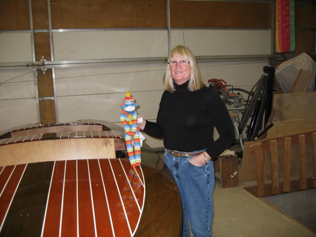

Red-Bovine 337 #3 Posted January 26, 2024 Proper technique and properly thinned paint can result is really good paint jobs using a roller. I used a roller to paint boats with varnish and two part polyurethane with excellent results. the absence of overspray all over everything was well worth the effort. 6 9 Share this post Link to post Share on other sites
Pullstart 68,873 #4 Posted January 26, 2024 @Red-Bovine beautiful boats! 5 Share this post Link to post Share on other sites
