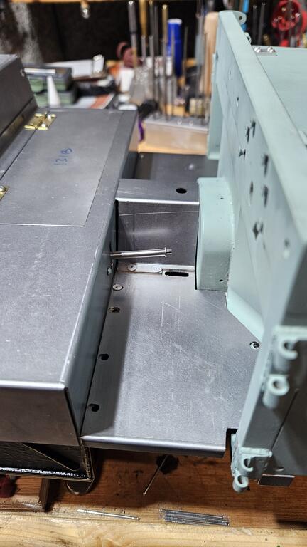

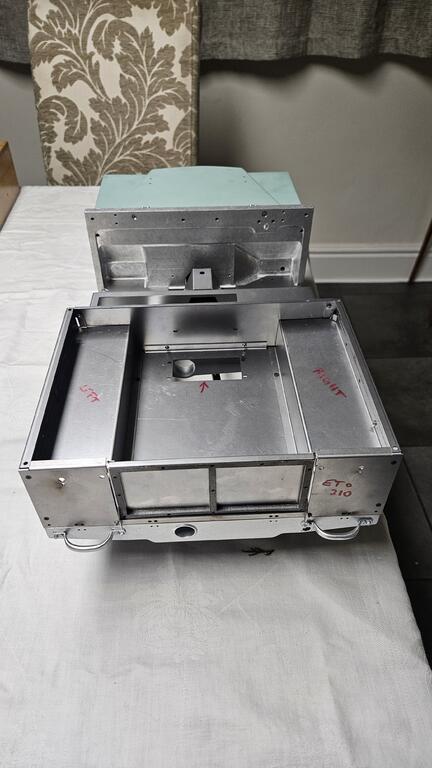

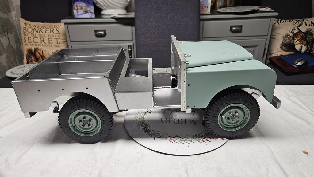

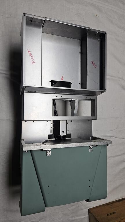

Mickwhitt 5,259 #101 Posted December 26, 2024 Boxing days is usually spent in front of the telly, we are watching Zulu which is a good old British story of military pluck. I managed to sneak some of the Landrover parts into the lounge and assembled the rear bodywork and cab floor so I can see what is going to be needed for detailing the whole structure. The panels are held together with a mixture of countersunk and button head screws, this is fine but it leaves you with a lot of bolt heads on show, which rather spoil the look. I'm going to clean all the panels and then glue them together with a high strength and flexible metal adhesive. That way I can ditch the bolts when the glue is cured and replace them with scale aluminium rivets. Still a long way to go but it's looking more like a landrover now. 1 4 Share this post Link to post Share on other sites

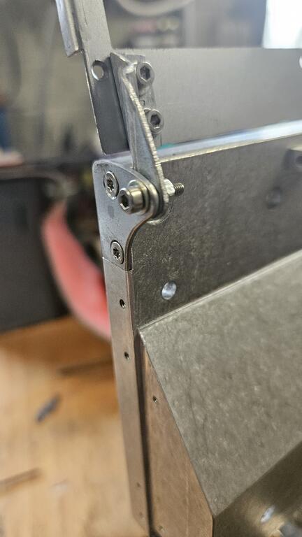

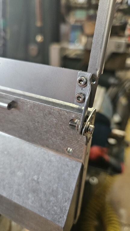

Mickwhitt 5,259 #102 Posted December 29, 2024 The front bulkhead supports the doors, screen, dash panel, bonnet, front wings etc etc. So I need to finish up any machining and modifying before I move forward with the rear bodywork and cab. Having changed the distance between centres of the static windscreen hinges I knew I had to move the hinges on the windscreen itself. So I decided to have a go at making a hinge that looks a bit more life like. It has to have a crank in it and it was a real head scratcher to get it bent up. I'm happy with the result so far and I'm playing with a new steering group wheel support now. 1 3 Share this post Link to post Share on other sites

8ntruck 9,420 #106 Posted December 30, 2024 All very valid observations about clubs and forums. I agree completely with your conclusions. I spent the last half of my carreer as a press tooling engineer. I find metal forming facinating - 1/2 science, the other half art. I know how I'd put that crank in the fullsize windshield in a production tool. Just curious - how did you do it for your pieces- one right hand, one left hand? 1 Share this post Link to post Share on other sites
Mickwhitt 5,259 #107 Posted December 30, 2024 11 hours ago, 8ntruck said: Just curious - how did you do it for your pieces- one right hand, one left hand? Hi, Wow a press tool guy who knows the ropes! Great to hear from you. I looked at the original window hinges and saw the crank in the upper arms. I guess it was done primarily to make the upper hinge fit between the fixed lower hinges properly. But also it may have added some stiffness or strength to a part that would have just been a flat plate. I made a template in tin plate and practised bending it to get the left and right sorted in my head. Then made actual pieces from 2mm thick steel sheet. The bending was done by gripping the part in a plain jaw vice and using a blunt chisel to put the two bends in , very close together. To do it properly I'd have needed to make a press tool but for just a couple of pieces it wasn't worth doing. Thanks for showing such interest in my work. I enjoy sharing it as much as I enjoy doing it. Best regards, Mick 2 Share this post Link to post Share on other sites

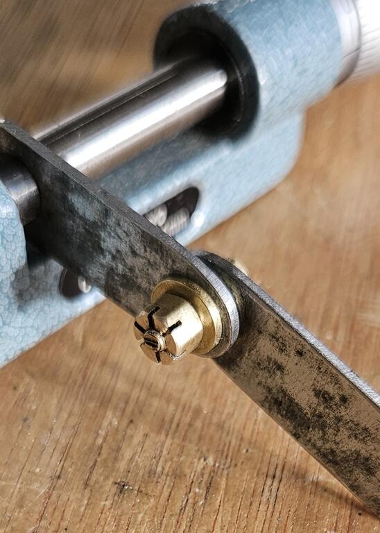

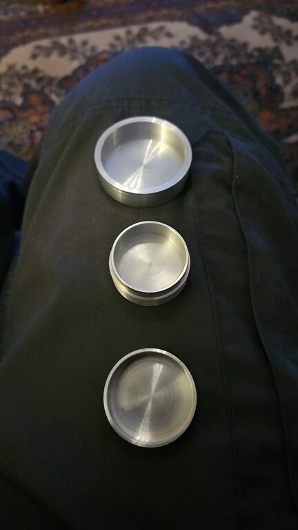

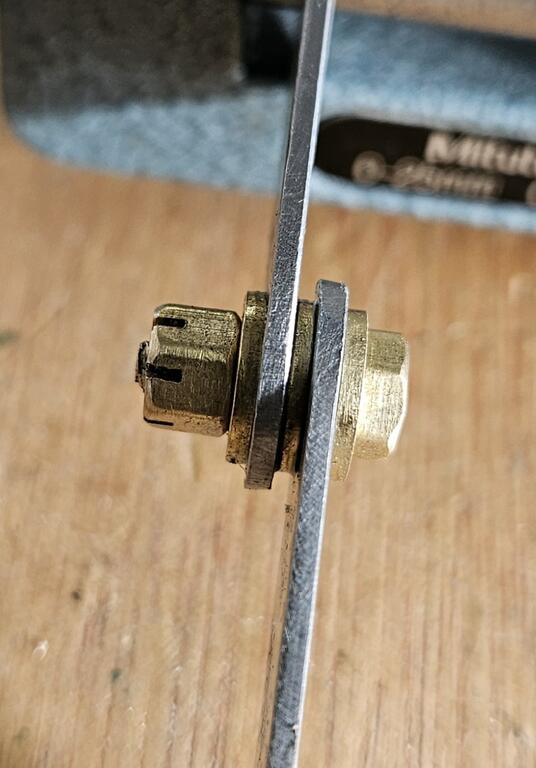

Mickwhitt 5,259 #108 Posted January 9, 2025 Bit more work on the Landy, after a few bits of tool work. These are little parts dishes that I made, aluminium turned with a magnet let into the outside of the base so they retain small parts. Then I made new bolts for the windscreen hinges. Rather than use a set screw I made little shouldered bolts with castellated nuts. Just made in brass with some scrap steel sheet to see how they look. Mick 1 3 Share this post Link to post Share on other sites

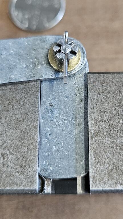

Mickwhitt 5,259 #109 Posted January 12, 2025 I managed to make the hinge bolts and nuts in steel. A bit more of a faffing than in soft brass. But it's worth it to improve on the kit. I cross drilled the bolt at 1mm to take a split pin. Talk about miniature work. I'm also building up the front wings and firewall as a unit so I can attach it to the chassis when it has been painted. It's about working out how to do the build so that I can paint the bodyshell without too much masking of the chassis. 1 2 Share this post Link to post Share on other sites

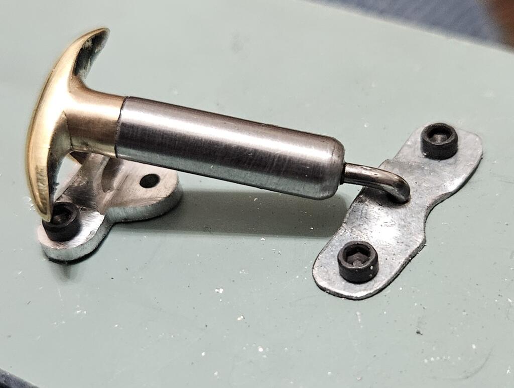

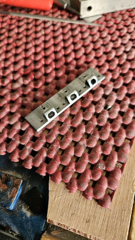

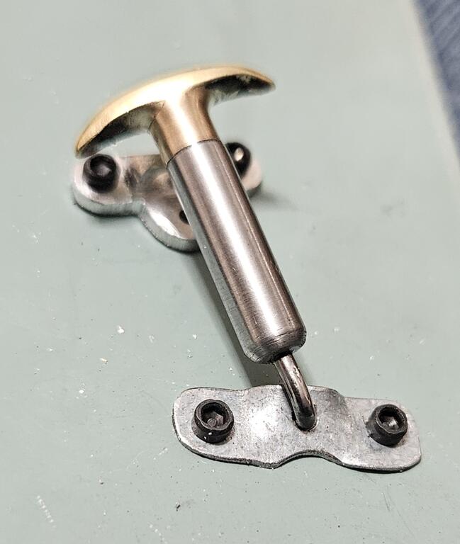

Mickwhitt 5,259 #110 Posted January 17, 2025 The steel windscreen supports are just plain steel so I sanded and lacquered them ready to fit. The bonnet latches are an issue, four of them needed: two for the bonnet and two to hold down the folded screen. I looked at ready made ones which are cast white metal. But I wasn't too keen on the look of them. So it was "Let's see how on earth I go about making these things" time. I thought about turning a button shape in brass and filing the shape, but that was a real faffing about job. So I used some soft brass plate to shape a flat version of the handle, then sliver soldered a 4mm shank onto it. I made a domed jig to bend the lobes and hook over. Then turn a steel body and drill for the hook end. Eh voilà: ----- Just the top and bottom bracket parts to fabricate now. 1 1 1 Share this post Link to post Share on other sites
Mickwhitt 5,259 #111 Posted January 18, 2025 I finished the prototype hood catch today, top and bottom brackets. I think it looks neat, apparently the catch is an American design from the Jeep. 1 3 Share this post Link to post Share on other sites

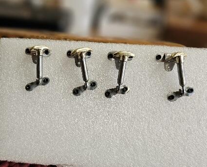

Mickwhitt 5,259 #115 Posted January 19, 2025 Bought some new needle files today. Lots of filing work on the Landy so I need some new ones. Chap in Greece is selling off some jewellery tools and had brand new boxed sets of vallorbe files which were very cheap, even with postage. I started prepping the materials for the bonnet catches, making up four identical kits of parts so they look right. The prototype I will use to show how they were developed if I enter any competitions. Mick. 1 Share this post Link to post Share on other sites
Mickwhitt 5,259 #116 Posted January 25, 2025 (edited) So a day in the shop saw me make a full set of four new hood catches. I leaned a lot from making the prototype and was able to speed up the process. I made them a bit smaller too and they look good, well they all look similar which is what I needed. Painting the finished model is my main worry at this stage. I've never looked at such a complicated project in detail so I'm going to do some research. I bought an excellent book called How (not) to paint a locomotive. It's a model engineers bible for how to approach painting. The guy who wrote it spent six years making and building a working steam loco before tackling the paint job. He had to strip it down completely to paint and rebuild it as he went. It took him two more years to do that! He let's you in on all the pitfalls and errors he encountered along the way. I've only scan read it so far but it's really opened my eyes. More reading and a lot more work to do before I need to start spraying. Mick Edited January 25, 2025 by Mickwhitt Forgot pickchas 2 2 Share this post Link to post Share on other sites

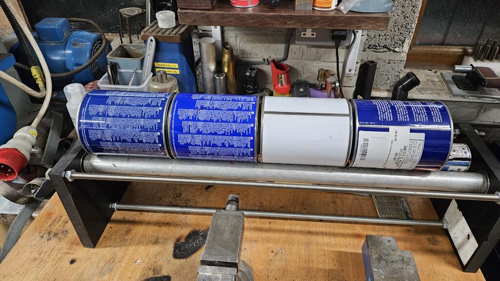

Mickwhitt 5,259 #120 Posted February 2, 2025 May have mentioned this elsewhere, but it bears repeating. I learned that tinned paint can form a skin if its left standing, even with the lid on. If you can keep it moving then the skin doesn't form and the paint stays mixed and ready to use. So some kind of machine to tumble paint cans was needed. The guy in my new paint book gave me an idea for the basic design. Today I machined something that seems to work. It will handle tins from 50ml to 5 litres. 20250202_183153.mp4 1 1 1 Share this post Link to post Share on other sites

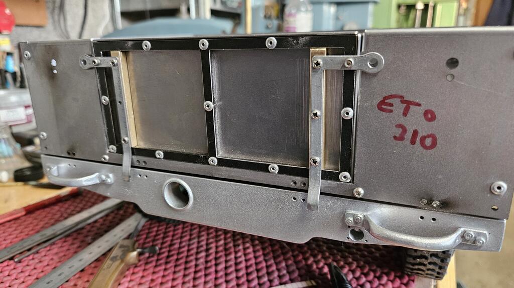

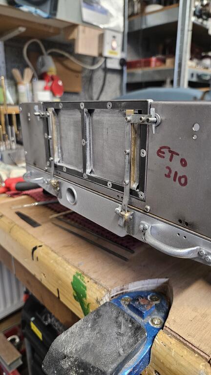

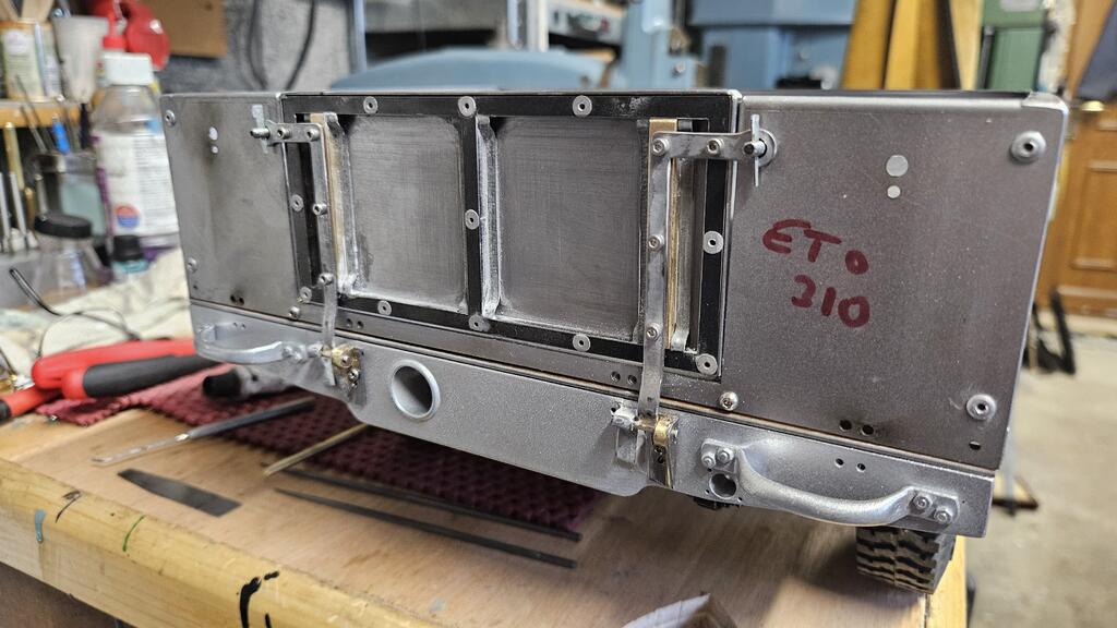

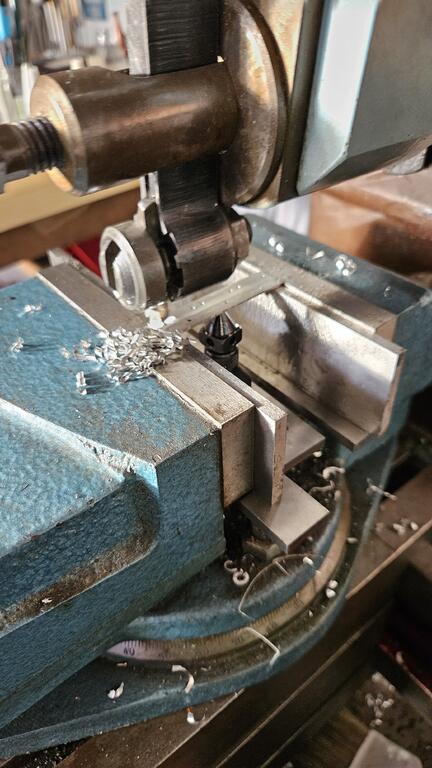

Mickwhitt 5,259 #121 Posted February 6, 2025 Back to the actual build instead of messing about making paint mixers etc. The tailgate is too simple to look realistic so I'm trying to increase the detail. The hinges are wrong and so I started out fashioning new strap hinges from 1mm thick steel. There were no stiffening ribs at each side of the tailgate so I made some from brass bar and next come some thin strips of steel to mimic the section of steel on these ribs. The work so far... 2 Share this post Link to post Share on other sites

Mickwhitt 5,259 #124 Posted February 11, 2025 So, despite a possible global meltdown, the build continues lol. I made progress on the hinges and got the fitted to the chassis. They actually work now and the tailgate detaches in the same way as the full size landrover, drop it fully down and slide to the left. I'm just messing around filling the holes that are no longer needed and sorting some of the rivets. Hardest part is letting the adhesives dry in between jobs, I'm not that patient lol. I'm loving the project so far, I knew it would take me a long time and I'm comfortable with the build time. I've not put full working days in and had quite a few other bits and bobs to do as well. So it's not been too bad. 1 Share this post Link to post Share on other sites

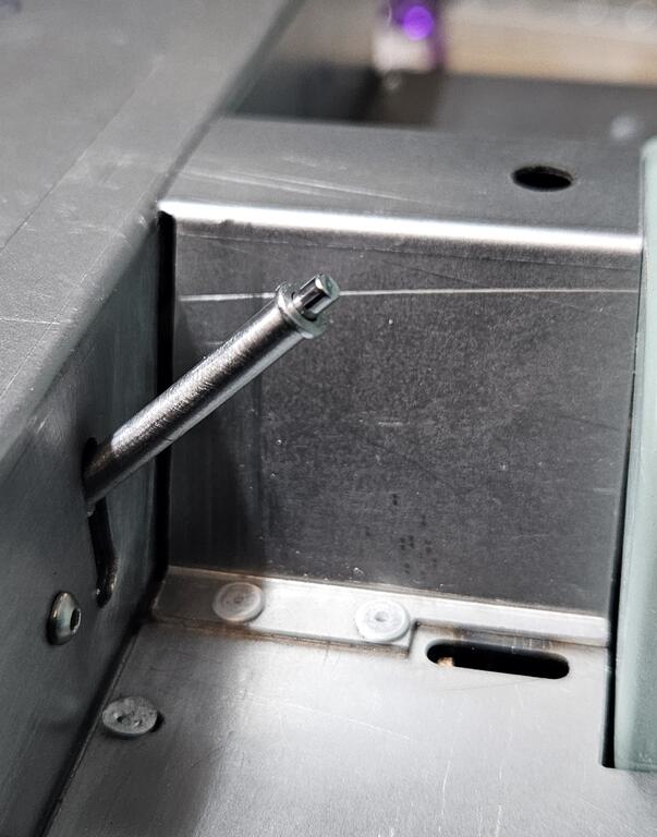

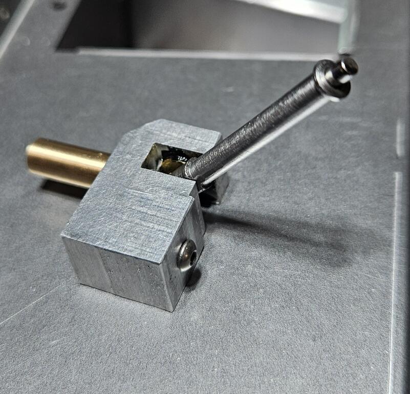

Mickwhitt 5,259 #125 Posted February 15, 2025 While fittingbthe cab floor I got sidetracked again. There are foot pedals, gear levers, but no handbrake. So I decided to add one. It was going to be a fixed rod but I got distracted and ended up building a working lever with a sprung detent to allow the lever to hold in the up or down position. And I just had to make the little release button work, didn't I? The unit bolts onto the kick plate beneath the drivers seat. It looks pretty neat but will probably never be moved. 1 1 Share this post Link to post Share on other sites
