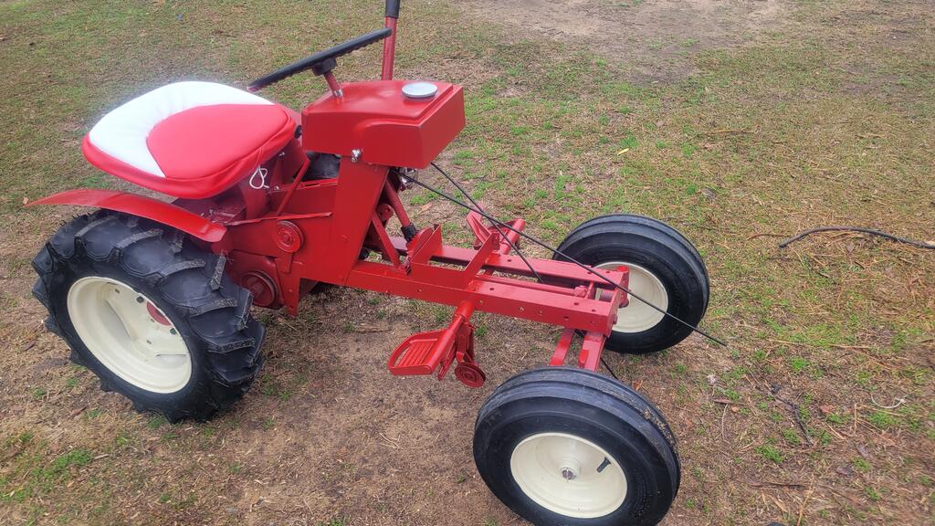

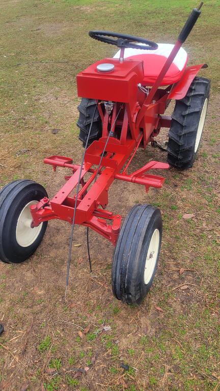

RED-Z06 2,720 #14 Posted January 26, 2024 No leaks, very easy to install, beading up required wrapping a v belt around and twisting it down...but in total about 5 minutes per front tire. Share this post Link to post Share on other sites
