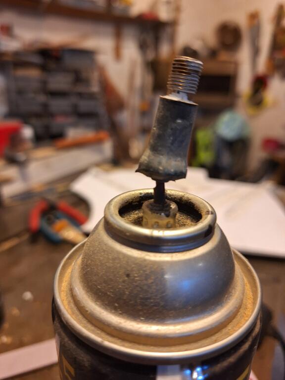

Beap52 2,537 #1 Posted January 22, 2024 (edited) I often times need small amounts of spray paint for project in the shop. I was finding the paint nozzle would be clogged. (I'm hesitant to turn can upside down to clear the nozzle as I figure at some point I'll use up all of the pressure in the can,) What I have found that works for me is to pop off the nozzle, put it in a little lacquer thinner to soak for a few minutes, then blow it out with an air gun, That seems to keep them open and working. I've also found some cans that have lost their pressure. I cut a valve stem off an old inner tube and it fits just right over the stem sticking our of the can then I can use the air chuck to re-pressurize them. I am careful not to over pressurize the cans and seem to be able to save this high dollar goods. By the way. I forgot to mention to wear latex gloves when re-pressurizing spray cans. Some paint usually is released and it can make a mess. Not wearing gloves usually results in me scratching paint from around my finger nails while visiting in-laws or sitting in church Sunday mornings! Edited January 23, 2024 by Beap52 forgot part of instructions 9 4 1 Share this post Link to post Share on other sites

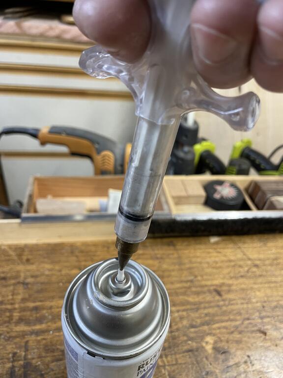

formariz 12,381 #10 Posted January 23, 2024 1 hour ago, WHX?? said: More problems with it plugging in the valve in the can on rustoleum Yes, I had that problem also. Had it with rus-oleum primer cans. What I do now is inject a bit of lacquer thinner into valve, and clean it before I put it away . I inject some more in there and leave it. It will evaporate soon. It resolved that problem for me. 1 1 Share this post Link to post Share on other sites
ACman 7,762 #11 Posted January 23, 2024 Have done this same thing for years with re-pressurizing aerosol cans of all types . If I know I’m going to be using a can of paint say in a couple of hours or the next day I’ll put the can upside down. Then shake and get the ball rolling around inside for 5 minutes before I even think of depressing the nozzle. Just my Share this post Link to post Share on other sites
