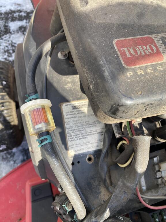

Vinnie 11 #1 Posted January 20, 2024 I just bought a four 16–8 Wheelhorse tractor with a onan P216 and the guy said it did sit for a while. When I started up, it is speed surging high to low RPMs and the choke is opening and closing. I tried spraying gum out in the carburetor that did not work. Any ideas on how to fix this? Thanks so much for your help and glad to be, part of the club 1 Share this post Link to post Share on other sites
