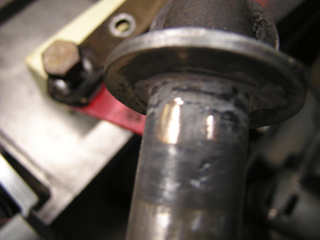

pfrederi 21,345 #1 Posted January 19, 2024 (edited) Frequently come across spindles that have been damaged by failed wheel bearings or lack of lube in the front axle ...some others have been bent out of shape. I can drill out and put bushings in the axles but don't have any idea how to repair the damage to the spindle itself. I am not a metal worker and don't have a lathe but given the shape of a spindle I doubt that would help. Anyone come up with ways to restore spindles?? Edited January 19, 2024 by pfrederi 2 Share this post Link to post Share on other sites

ri702bill 13,396 #6 Posted January 19, 2024 One "issue" with standard cold rolled round stock is that it runs .003 to .005 undersize. The bearing is usually right on the money for size - that allows the inner race to spin if it wants to - and that is what wears the groove in the spindle.... We have had decent sucess with TIG welding the groove back up and hand filing the excess down to size so that the inner race has a light press fit onto that area. Thre inner race cannot spin , but the bearing does.... Shown is one such repair, with a dab of JB Weld to fill in any small remaining voids....... 3 1 Share this post Link to post Share on other sites
