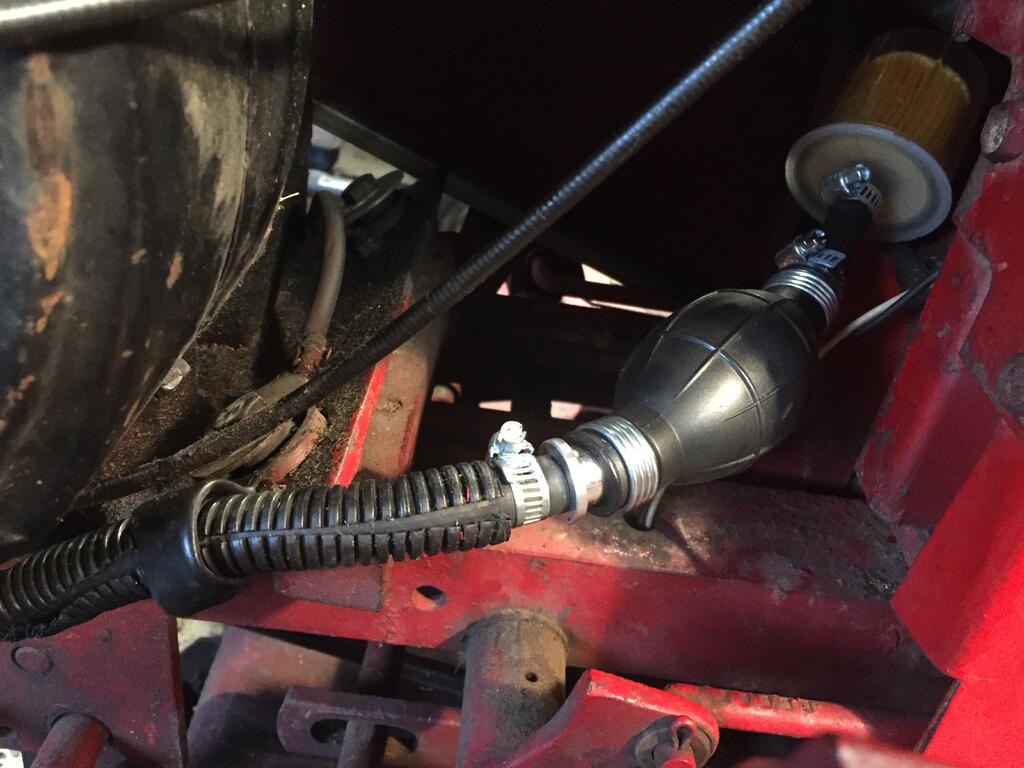

Ed Kennell 46,608 #19 Posted January 20, 2024 1 minute ago, JerryLook said: Where do you put the primer bulb, and how do they hold up in very cold weather? Are you putting it before or after the fuel pump? No problem in winter. Before the fuel pump. I put mine where I can reach them from the seat. Usually near my left foot. Share this post Link to post Share on other sites
SylvanLakeWH 31,756 #20 Posted January 20, 2024 Here's where mine is... easy reach with left hand. 1 Share this post Link to post Share on other sites
