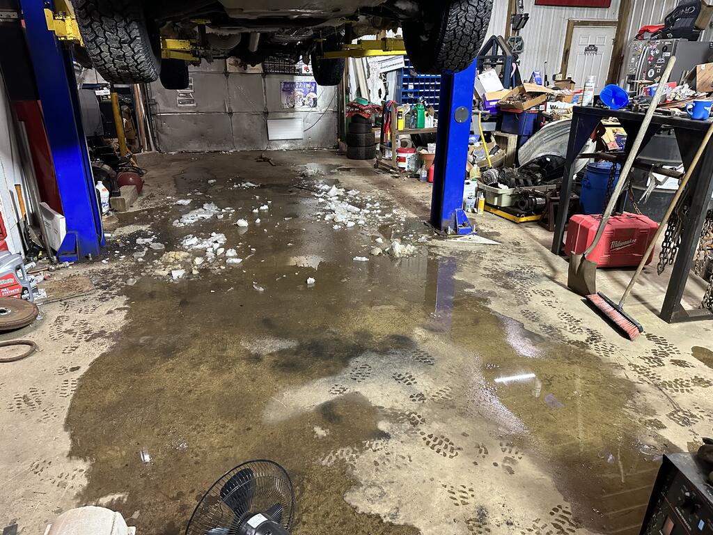

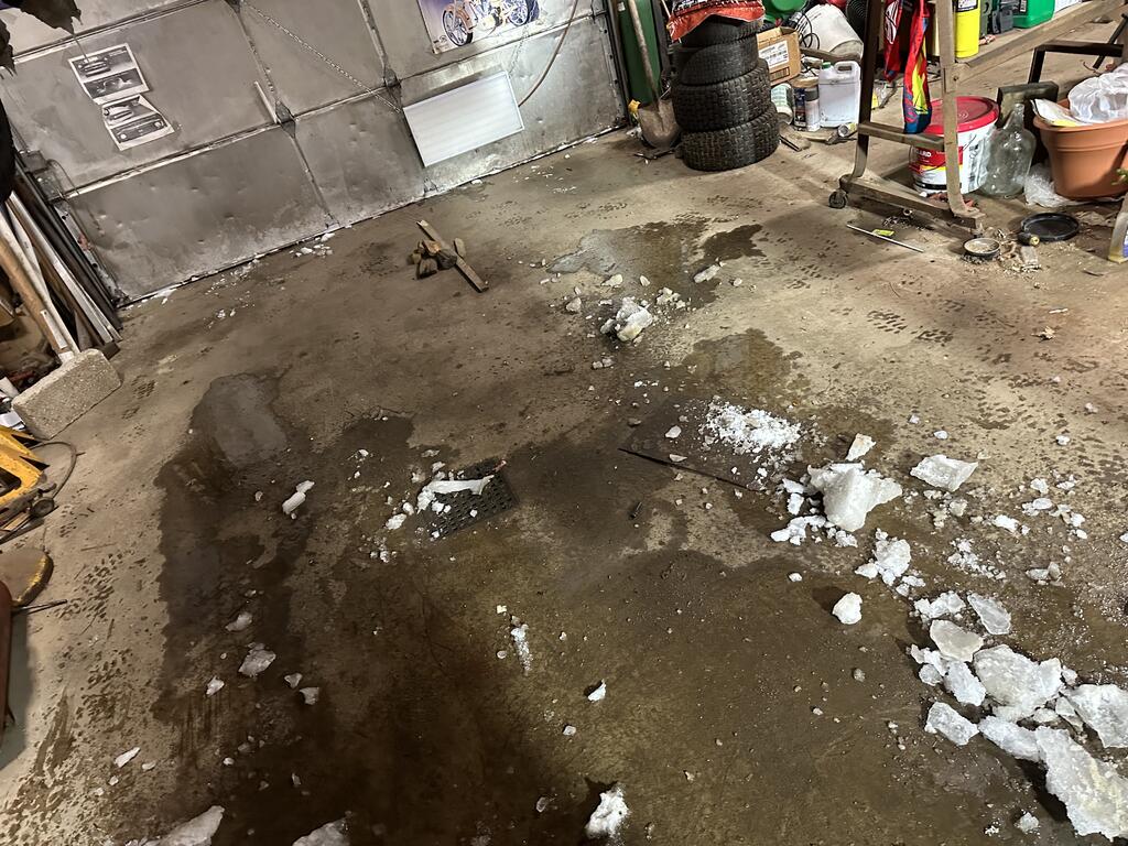

Pullstart 71,514 #1 Posted January 13, 2024 My shop floor has a drain. It seems to be higher than the entire work bay. It requires a huge amount of water to get the drain wet. I used to have a big rubber mat lined with 2x4s under the edges and a hole over the drain to contain run off of snow covered or ice covered vehicles. It eventually became brittle, cracked and fell apart. Now, I wonder if it would be advantageous to grind some lead into the drain, or to apply self leveling concrete all around the shop to fill the low points? The issue with adding self leveling compounds, is I don’t want it level, I want it sloped. I’m just tired of water not going where I think it it should be, but where gravity takes it. 1 Share this post Link to post Share on other sites

SylvanLakeWH 32,823 #4 Posted January 13, 2024 Whole floor higher than the drain or drain itself slightly higher? Could lower the drain and grind path(s) to it... How about a pic? Maybe saw cut and install a simple trench drain connected to existing drain...? 3 Share this post Link to post Share on other sites

Pullstart 71,514 #16 Posted January 15, 2024 On 1/13/2024 at 1:07 PM, SylvanLakeWH said: How about a pic? This little timelapse shows the water running away from the drain… 2 Share this post Link to post Share on other sites

SylvanLakeWH 32,823 #19 Posted January 15, 2024 I'd cut out a 3'x3' square at drain, then lower it ~2" and grade 3' square concrete to new drain cover. Grinding won't do anything without dropping drain lip... 2 Share this post Link to post Share on other sites
