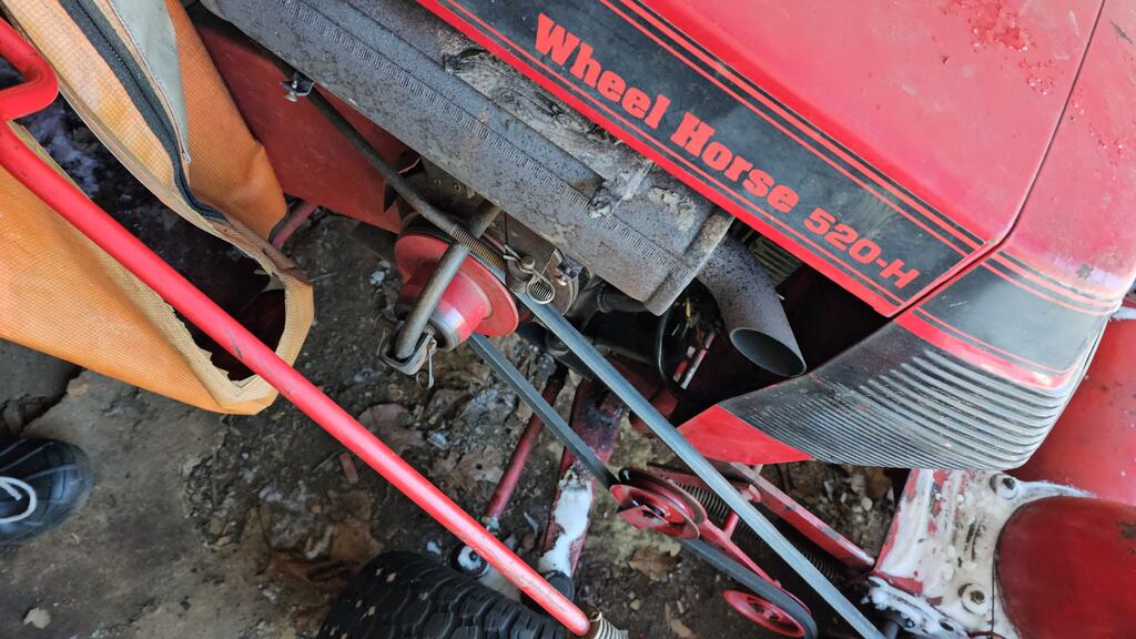

WHX?? 57,788 #2 Posted January 10, 2024 Some pics here would really help us see what you have going on. Goat. Share this post Link to post Share on other sites

ri702bill 12,803 #5 Posted January 10, 2024 Old style 32" single stage?? Those were meant to fit short frame tractors. Is the lift rod long enough?? Share this post Link to post Share on other sites
Goat 2141 5 #6 Posted January 10, 2024 (edited) got it used. I have same problem with my plow. How long should it be. Edited January 10, 2024 by Goat 2141 Share this post Link to post Share on other sites
Ed Kennell 46,978 #7 Posted January 10, 2024 (edited) 9 minutes ago, Goat 2141 said: got it used. I have same problem with my plow. How long should it be. The plow does not use a push rod for lifting. Can you get the pictures posted? Can you verify that the lift cylinder is actually extending and the rock shaft is rotating? Edited January 10, 2024 by Ed Kennell Share this post Link to post Share on other sites

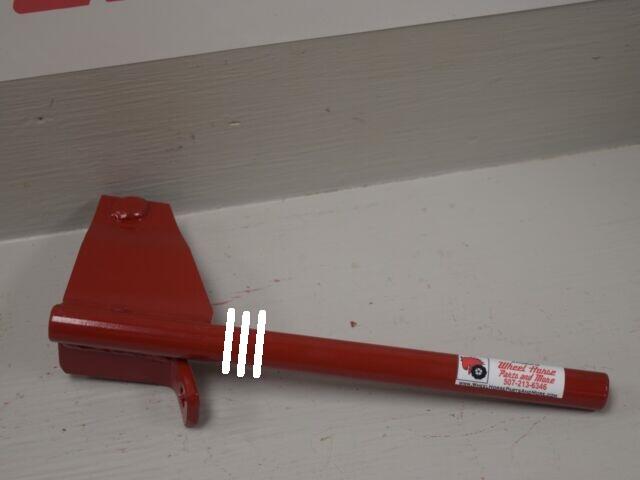

Ed Kennell 46,978 #11 Posted January 21, 2024 1 hour ago, Goat 2141 said: How can that be fix Put spacers on the flag rod. Share this post Link to post Share on other sites
wallfish 20,509 #12 Posted January 21, 2024 Shims, spacers or whatever you want to call them. 3/4" ID washers or locking shaft collars will work. I see a hydraulic lift cylinder so you don't need that lift assist spring if you want to remove it. 1 Share this post Link to post Share on other sites

Ed Kennell 46,978 #16 Posted January 21, 2024 On 1/10/2024 at 8:43 AM, Ed Kennell said: The plow does not use a push rod for lifting. Can you get the pictures posted? Can you verify that the lift cylinder is actually extending and the rock shaft is rotating? 2 minutes ago, wallfish said: Think Ed is getting at - if the hydraulic lift is actually working or not. Yeah, I tried to get an answer to that before John. It's clear from his picture that the snow blower push rod is too short and needs some spacers, but I never saw enough info to determine why the plow will not lift. On 1/10/2024 at 8:34 AM, Goat 2141 said: got it used. I have same problem with my plow. How long should it be. Share this post Link to post Share on other sites

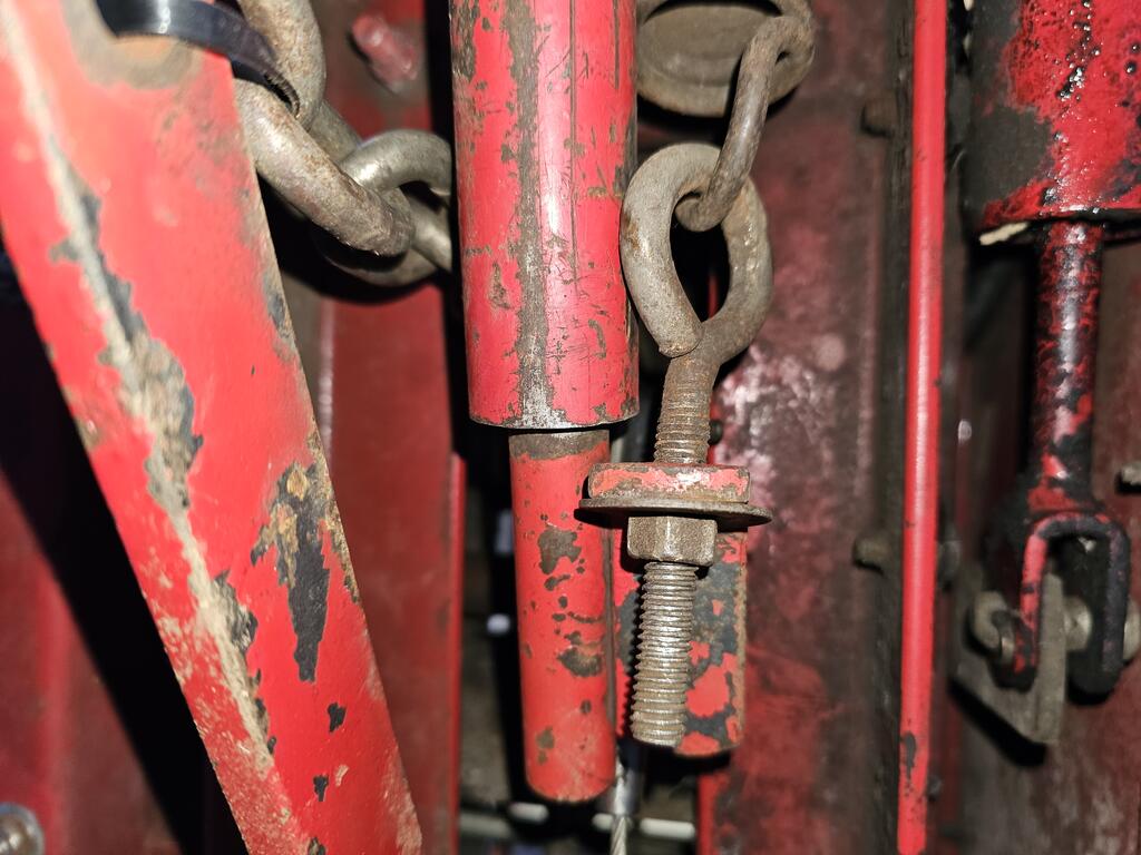

Ed Kennell 46,978 #19 Posted January 22, 2024 I just noticed the rusted up piston rod on the lift cylinder. It's hard to believe that rod is moving. Can you please check the rod for movement? Also is there an issue with the air cleaner pressure sensor? Share this post Link to post Share on other sites
wallfish 20,509 #20 Posted January 22, 2024 2 hours ago, Ed Kennell said: I just noticed the rusted up piston rod on the lift cylinder. It's hard to believe that rod is moving. Can you please check the rod for movement? Also is there an issue with the air cleaner pressure sensor? Think the rod is all the way into the cylinder Ed The cleaner SS rod would show when it's extended out. It sure does look like it's quite damp with oil though. But that could be from anything above it. 1 Share this post Link to post Share on other sites
