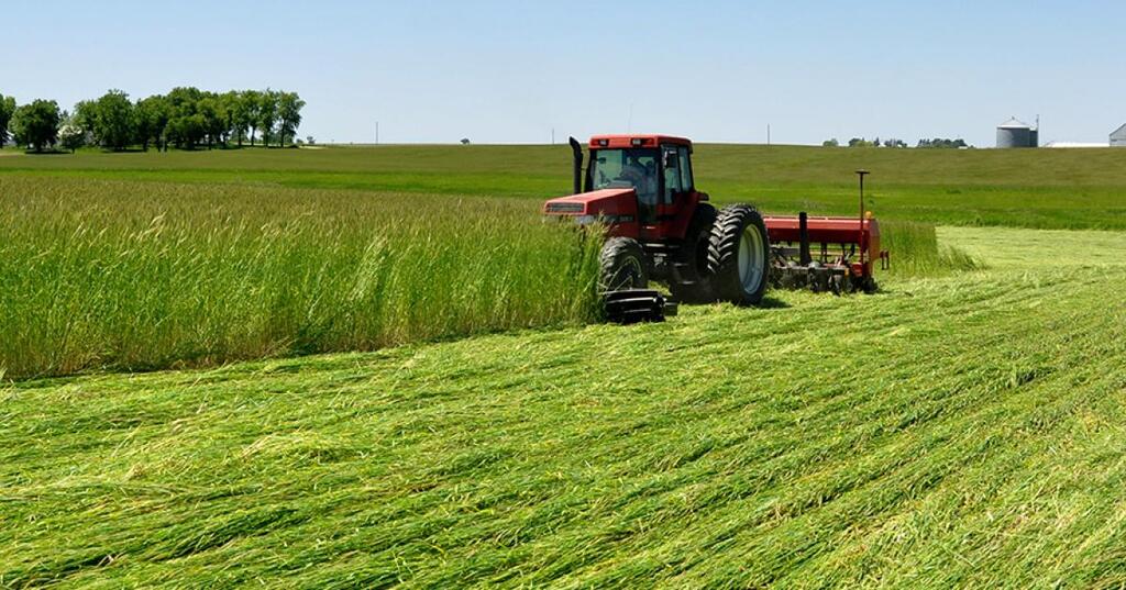

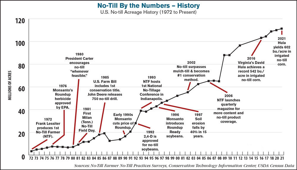

953 nut 68,782 #1 Posted January 10, 2024 Saving the soil while saving money A few thousand years before Christ walked the earth planting crops consisted of a stick penetrating the crust of the earth for a seed to be planted without disturbing the surrounding soil. The earliest known Egyptian farm implement is a stone sickle bar point from about 5200 BC. It would be tied to a stick to cut weeds down allowing the planted seeds to grow with less interference. As early as 1500 BC Wooden plows, pulled by domesticated animals, became the accepted tool to prepare the ground for planting. About 500 BC China's agriculture flourished with the development of an iron plow. It was a simple hammered iron sweep that penetrated the ground and rolled the soil in two directions to develop a furrow for planting. As progress toward greater crop yields on more acreage continued to grow in popularity larger and more effective methods of cutting into the soil were developed. Today there is a transition to no-till farming. One of the biggest contributors to soil degradation is the common practice of soil tilling. A growing number of farmers realize the importance of preserving and improving their soil by adopting no-till practices. It saves time, labor, and fuel when compared to conventional tillage practices. This practice will often result in a longer release of nitrogen as the cover crop breaks down over the summer. This will provide nitrogen throughout the summer, beneficial to crops like corn that utilize nitrogen. This reduces the need for fertilizer which saves time and money Our family farm in upstate New York is in the hands of a fourth-generation farmer (my cousin) and has transitioned to no-till farming with great success. The Roller Crimper has proven to be of great value. Rather than cutting a cover crop, plowing it under, preparing the plot and then coming back to plant a crop the planting apparatus is used with the roller crimper and only one pass over the soil is needed. Here is a bit of information about the process. The Roller Crimper is making no-till farming more popular today. Originally developed in South America, over the last decade roller-crimpers have become more popular in the U.S. as more no-tillers add cover crops to their system. Prior to the Roller Crimper a cover crop was cut with a mower and a selective herbicide that wouldn’t kill the crop being planted would be applied while seeding. Eliminating the cost of herbicides helps the bottom line and helps the environment. Win-Win situation! The crimping action helps crush the walls of the stem to facilitate drying down of the plant. There are several different types of roller crimpers available on the market. There are units available that mount on the front of the tractor, rear of the tractor, or even directly on the planting unit itself. Roller crimping cover crops has been utilized to terminate cover crops for many years. With the rapid expansion of cover crop implementation, roller crimping offers a viable option to managing cover crops in a no-till cropping system. The use of a roller crimper program helps to leave biomass on the soil surface, which drastically reduces risk of soil erosion and helps preserve soil moisture during the summer. The biomass on the soil surface will also keep the soil cooler during the summer reducing evaporation and heat stress on the cash crop. Rolling down high biomass cover crops also provides an excellent way to work towards improving spoil health. The use of the roller crimper will also suppress weeds early in the growing season potentially reducing the need for herbicides. 2 4 4 1 Share this post Link to post Share on other sites

Handy Don 17,377 #5 Posted January 10, 2024 3 hours ago, 953 nut said: Thanks for the picture. I believe this farmer has a front-mounted roller/crimper and is towing a seed drill. One pass to take down the cover, “process” it to decompose into soil nutrients quickly, and plant the crop that will feed on those nutrients. The lighter load means he can use a smaller tractor with dual rears to lessen soil compaction and save fuel. 1 Share this post Link to post Share on other sites
