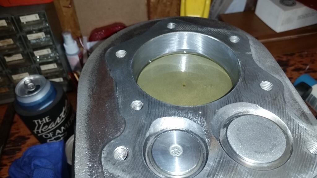

pfrederi 21,049 #1 Posted January 9, 2024 The K341 winter project must have had a long term exhaust valve seating issue. She is off to machine shop tomorrow to get measured then i will order the parts. (including new valves) 2 2 Share this post Link to post Share on other sites

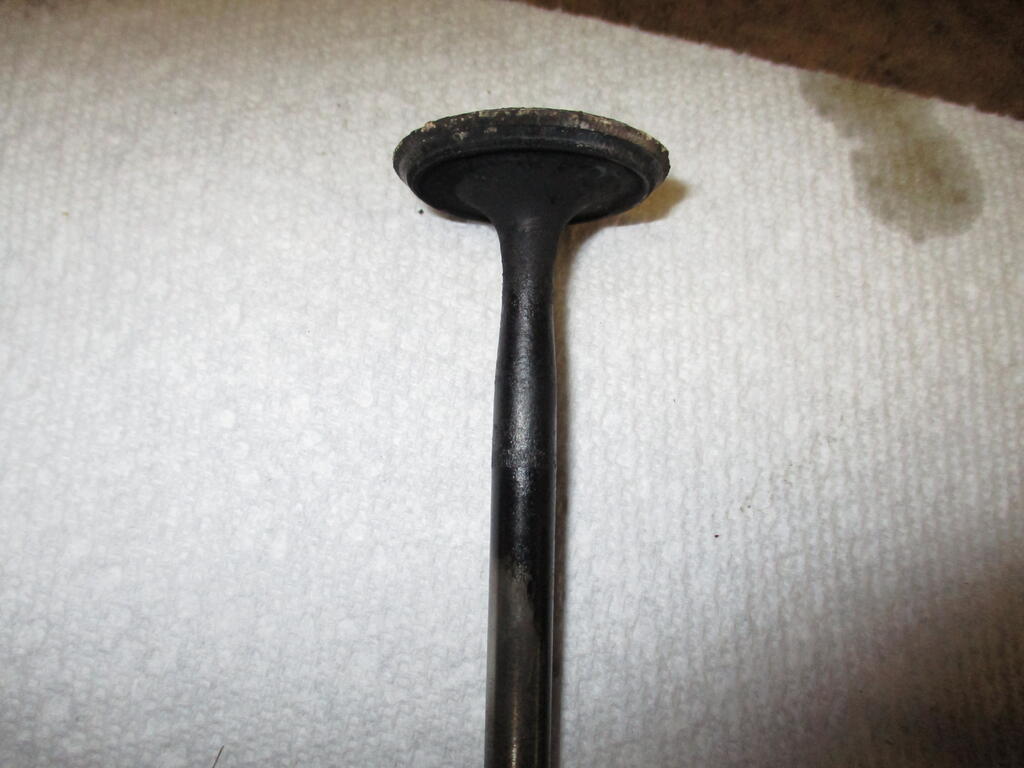

ri702bill 12,816 #2 Posted January 9, 2024 Hmmm.. a mite nasty, but it may be salvageable - if it is not bent. Chuck it in a lathe or even a cordless drill..... it may surprize you.. Share this post Link to post Share on other sites

squonk 47,887 #7 Posted January 10, 2024 Neck is stretched. Not usable 1 Share this post Link to post Share on other sites
WHX?? 57,804 #8 Posted January 10, 2024 1 hour ago, squonk said: Neck is stretched. Not usable I thought that looked funky too and never saw it before. How does that happen? 1 hour ago, ri702bill said: would never consider anything but a genuine Kohler part I would love to use Kohler parts... if I could afford them but when you have thirty tractors to feed... 1 Share this post Link to post Share on other sites
ri702bill 12,816 #9 Posted January 10, 2024 6 minutes ago, WHX?? said: I thought that looked funky too and never saw it before. How does that happen? I would love to use Kohler parts... if I could afford them but when you have thirty tractors to feed... Agreed. I try to use OE replacement parts - IF they are still available and I refuse to endure price gouging. Aftermarket internal parts - yes, I have used them too. ALWAYS buy from a reputable vendor - some of the "cost effective" available items on the internet are questionable...... 1 Share this post Link to post Share on other sites
squonk 47,887 #10 Posted January 10, 2024 33 minutes ago, WHX?? said: I thought that looked funky too and never saw it before. How does that happen? HEAT!!! Too much of it. Then when the valve stops sealing well it runs even hotter. 1 1 Share this post Link to post Share on other sites
ri702bill 12,816 #11 Posted January 10, 2024 3 hours ago, squonk said: Then when the valve stops sealing well it runs even hotter. My observation exactly if the valve is bent - it cannot close on the full sealing face to transfer heat to to seat..... Share this post Link to post Share on other sites

WHX?? 57,804 #13 Posted January 10, 2024 9 hours ago, squonk said: HEAT!!! Too much of it. Then when the valve stops sealing well it runs even hotter. From running too rich Mike? Plugged fins? Combo of both? Share this post Link to post Share on other sites
squonk 47,887 #14 Posted January 11, 2024 1 hour ago, WHX?? said: From running too rich Mike? Plugged fins? Combo of both? Too lean, timing off, dirty fins (restricted air flow.) 1 Share this post Link to post Share on other sites
WHX?? 57,804 #15 Posted January 11, 2024 20 minutes ago, squonk said: Too lean, timing off, dirty fins (restricted air flow.) Yes too lean my bad ... would points being off .020 +- cause it? Share this post Link to post Share on other sites
squonk 47,887 #16 Posted January 11, 2024 .020" is ok. But if you start getting into another.002 or more your starting to get into no mans land. Also depends on gas quality. Share this post Link to post Share on other sites
