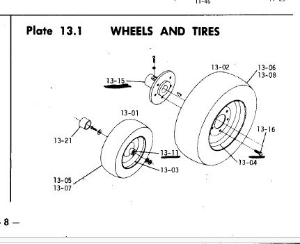

DCwom 78 #1 Posted January 7, 2024 So I jacked the front of my Raider 12 up this morning and discovered one front wheel doesn't move much, it makes an audible grinding noise when turned by hand, so its really messed up. I took the axle bolt out but the wheel doesn't want to come off, I took a look at the mechanical diagram and I don't see much other than the bolt holding the wheel on. A few taps with a hammer didn't do anything, but I thought I'd ask before I get more aggressive with the hammer, unfortunately I don't have a puller, although should I really need one for a wheel? I assume the bearings are probably shot and expect to chase them all over the floor when I finally get the wheel off, but we'll see. The manual diagram shows just 2 bearing, 13-03 & 13-11. I snagged this link from another post for replacements, but are all Wheel horse front bearings the same? https://wheelhorsepartsandmore.com/product/110513-front-wheel-bearing-4-for-wheel-horse/ Share this post Link to post Share on other sites
wallfish 20,218 #2 Posted January 7, 2024 That's it, the bolt should be the only thing that holds it on. The bearings are probably seized to the spindle. Take the other side off so you can see exactly what you SHOULD be dealing with as that may help you for the stubborn wheel. 1 Share this post Link to post Share on other sites
Lee1977 7,709 #3 Posted January 7, 2024 (edited) Dried grease can hold them on to where you can't just pull them off. I took a couple off last night I had to tap with a hammer to get them off. If they have never been greased they can have a notch worn in the axle. Edited January 7, 2024 by Lee1977 1 Share this post Link to post Share on other sites
Ed Kennell 46,555 #4 Posted January 7, 2024 (edited) Yes, the bearings (2) have worn and fallen apart. Make sure you clean out the old grease and ball bearings when you get the wheel off. Hopefully the spindle is OK. You may be able to use a 2X4 as a pry bar between the wheel and the end of the axle to push the wheel off with out beating up the wheel with a BFH. Replace the bearings in the other side right away. WHEEL HORSE GARDEN TRACTOR 2 FRONT WHEEL BEARINGS, FOR GRAVELY, JOHN DEERE, MTD | eBay Edited January 7, 2024 by Ed Kennell 2 Share this post Link to post Share on other sites
