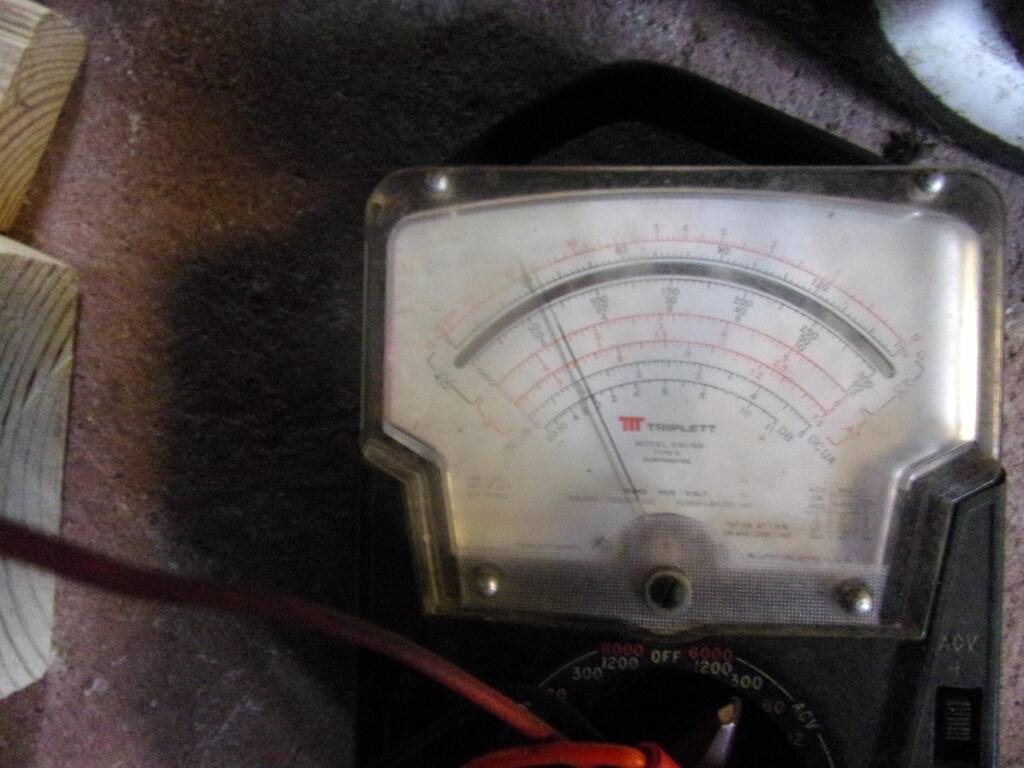

Ed Kennell 45,555 #31 Posted January 1, 2024 I stuck the VOM on the AC and The RPM has little effect on the VAC. I measured 120v at 1000RPM and it only increased to 130v at 3000RPM. So I'm thinking only the Amperage and the Hz is increasing with RPM above 1000. I don't have a scope to measure Hz. Any ideas? The DC output measured 13V. So I have a good AC and DC supply. I need to put voltmeters on both. More thoughts on the compressor check valves. If I take the springs off and shorten the stems on both valves so they float, I should have a good air intake check valve. The vacuum from the piston down strokes should lift the valves pulling air in. Gravity and the pressure from the piston up strokes should close and seal the valves pushing the air thru the tank check valve. Thoughts?? 1 Share this post Link to post Share on other sites
Handy Don 16,179 #32 Posted January 1, 2024 (edited) 45 minutes ago, Ed Kennell said: Thoughts?? My sense would be that the mass plus stem friction of the intake and exhaust valves is too great for air pressure alone to reliably operate them, especially at frequencies like 00’s or 000’s of RPM. A meter with frequency is invaluable for generator checking. Assuming you don’t intend this to run electronics or a speed-sensitive motor, a tachometer may give you a close enough reading. Depending on the generator’s windings, it’ll be either 1800 or 3600 rpm ==> 60 hz. Edited January 1, 2024 by Handy Don 2 1 Share this post Link to post Share on other sites
c-series don 11,763 #33 Posted January 1, 2024 I’m thinking the old generator Ed started with is 1800 rpm but I could be totally wrong. Just an educated guess. Share this post Link to post Share on other sites
wallfish 19,565 #34 Posted January 1, 2024 1 hour ago, Ed Kennell said: Thoughts?? weaker springs and it might work 1 1 Share this post Link to post Share on other sites
Handy Don 16,179 #35 Posted January 1, 2024 34 minutes ago, c-series don said: I’m thinking the old generator Ed started with is 1800 rpm but I could be totally wrong. Just an educated guess. I agree. Lots of these RV or marine Onan gensets were intended for long life and wound for 1800 RPM. If he’s lucky, he has one of those! Note that the generators of those times nearly all had brush commutators--something to be sure to check for condition and to never operate in an area with flammable gas fumes! 1 Share this post Link to post Share on other sites
JoeM 9,723 #36 Posted January 2, 2024 6 hours ago, Ed Kennell said: I don't have a scope to measure Hz. Any ideas? been a while since I fooled with this stuff but just thinking out loud, do you have an electric motor, like and old furnace blower motor? Hook it up and run it and check the rpm on the furnace motor while changing RPM on the generator. Might just find the right frequency rpm that way?? Like a fine tune. 1 1 Share this post Link to post Share on other sites

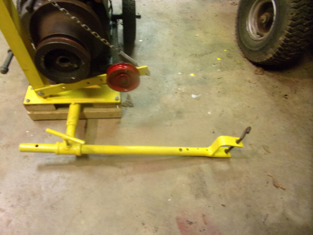

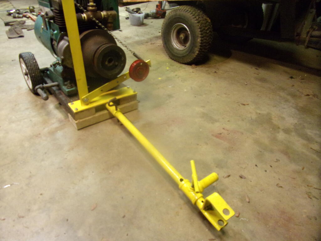

peter lena 9,821 #40 Posted January 3, 2024 @Ed Kennell idea, maybe a frame connection to the , tractor front hitch area ,helping stabilizing , unit , also make up a spring loaded idler pulley for that belt set up , maybe combine them? good experiment , Pete 1 Share this post Link to post Share on other sites
Ed Kennell 45,555 #41 Posted January 3, 2024 Just now, peter lena said: @Ed Kennell idea, maybe a frame connection to the , tractor front hitch area ,helping stabilizing , unit , also make up a spring loaded idler pulley for that belt set up , maybe combine them? good experiment , Pete Agree Pete, maybe a telescoping bar between the tractor and the gen set. This unit is very heavy, on wheels and will be towable and made to use on any tractor with a PTO. And a spring loaded tensioner will be added to stop the belt slap. 1 1 Share this post Link to post Share on other sites
ebinmaine 78,072 #42 Posted January 3, 2024 47 minutes ago, Ed Kennell said: Agree Pete, maybe a telescoping bar between the tractor and the gen set. This unit is very heavy, on wheels and will be towable and made to use on any tractor with a PTO. And a spring loaded tensioner will be added to stop the belt slap. I meant to ask about that around the first pics posted. I like the idea of keeping it usable on ANY standard WH PTO. Share this post Link to post Share on other sites
peter lena 9,821 #43 Posted January 3, 2024 @Ed Kennell ED , think if anything , advantage , you, it runs / works , think I would just get some flat steel stock and do a trial lay out . you probably have a good stash of , used everything , know I do , good luck , Pete 1 Share this post Link to post Share on other sites
Ed Kennell 45,555 #44 Posted January 3, 2024 1 hour ago, ebinmaine said: I like the idea of keeping it usable on ANY standard WH PTO. Right, the idea is to tow it, trailer it, take it to shows where anyone could use it with their WH to pump up tires, charge batteries, jump start engines, and have 110v power. 1 1 Share this post Link to post Share on other sites
wallfish 19,565 #45 Posted January 3, 2024 2 hours ago, Ed Kennell said: Right, the idea is to tow it, trailer it, take it to shows where anyone could use it with their WH to pump up tires, charge batteries, jump start engines, and have 110v power. Like a swinging tow bar. Tow, pull a pin to swing it to the side for operation, rotate straight up for storage of it Share this post Link to post Share on other sites
Ed Kennell 45,555 #46 Posted January 3, 2024 57 minutes ago, wallfish said: Like a swinging tow bar. Actually John, I made wheels and a telescoping (pipe in a pipe) tow/handle when I used it as a gen set years ago. A short position for towing and storing and a long position for lifting and pulling by hand. Keep the ideas coming...thanks. Share this post Link to post Share on other sites

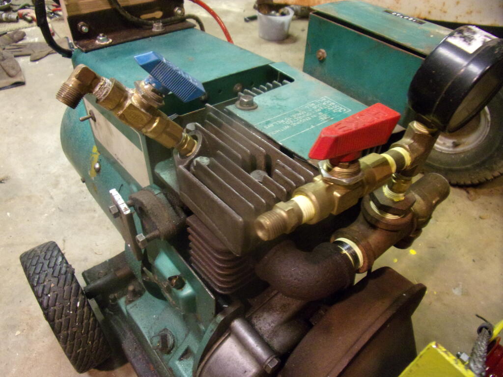

Ed Kennell 45,555 #47 Posted January 5, 2024 OK, we know we have a 110vac and a 12vdc supply, so today I brough her into the heated shop to work on the compressor. Removed the carb, fuel pump, head, and some tins. Everything looks good under the head. For my first trial, I think I'll leave the valves alone close the spark plug hole and add a check valve to the exhaust pipe. I'm thinking I'll have a 1 stroke active pump and one stroke inactive. stroke intake valve exhaust valve air movement intake open closed into the cylinder compression closed closed zero only compressed power closed closed zero only expanding exhaust closed open thru the exhaust pipe, check valve to tank. Jim, I did pull the end cover off and I only see two coils (poles) so I guess I need 3600 revs to get my 60 Hz. May have to go to a smaller pulley on the gen. I see three narrow brush rings and one wider one closer to the armature. Ac and Dc ? Comments???? 1 Share this post Link to post Share on other sites
JoeM 9,723 #48 Posted January 5, 2024 1 hour ago, Ed Kennell said: Comments???? I like it. Simple way to see how the compressor will work. Wonder if an old hot water tank relief can be adjusted and used as a trial? Share this post Link to post Share on other sites
Ed Kennell 45,555 #49 Posted January 29, 2024 Update on the compressor/ 12VDC/120VAC gen set. I decided to just use the existing intake and exhaust valves for the first trial run of the compressor. I valved off the spark plug hole that can be opened for bypass when the compressor is not in use. Hopefully air will be sucked in on the intake stroke, nothing happens on the compression and power stroke, then compressed air is supplied on the exhaust stroke. All my available tractors have plows or blowers and the mowers are in winter storage. Guess I need to get one out of storage to test the compressor. I used Johns @wallfish idea on the hitch. I all ready had a telescoping hitch that could be extended for towing. So, I simply made an adapter to turn it 90 degrees so it will connect to the attach-a-matic and lock the gen set to the tractor. The spring loaded tensioner pulley will provide tension on the drive belt. 2 Share this post Link to post Share on other sites
